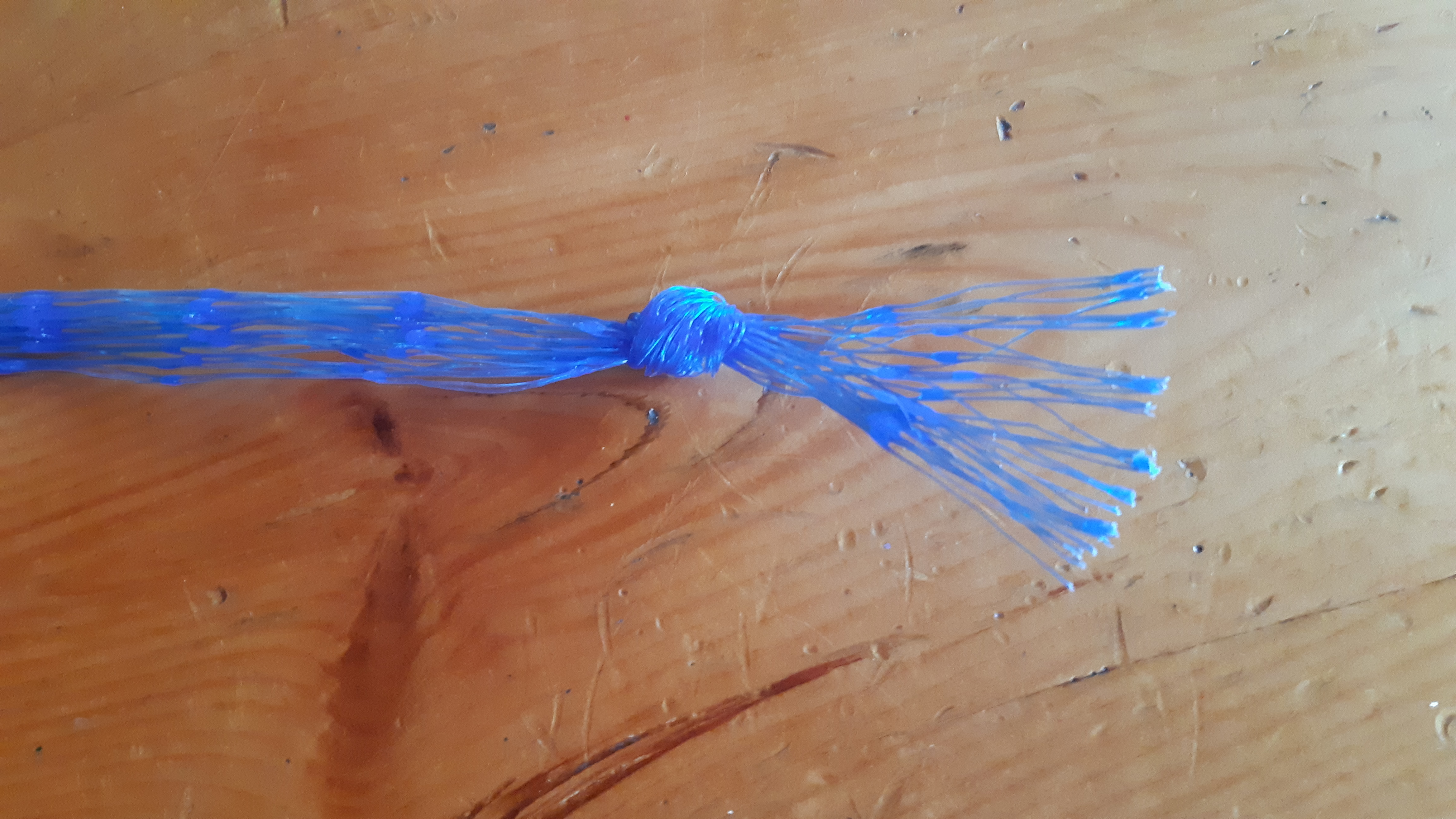

Not really tractor related but there are smart minds in this forum. I need to build something to melt polyethylene netting together. I'm thinking something similar to the way ketchup packets/mr freezes etc are sealed. We buy 1000 yard rolls of this polyethylene sock netting, cut it into 10' length and tie a knot on one end to make a sort of net bag. I have to tie 20,000 of these every year which sucks lol. We use them in mussel farming. I do use my TN75 on the mussel farm though. Thanks for any ideas. 20200609_190422.jpg

Maybe something like this rope cutting gun, my dad had a similar blade for his soldering gun for cutting nylon rope. If you twist it up good, you probably won't have to tie it.

Try a heat gun.

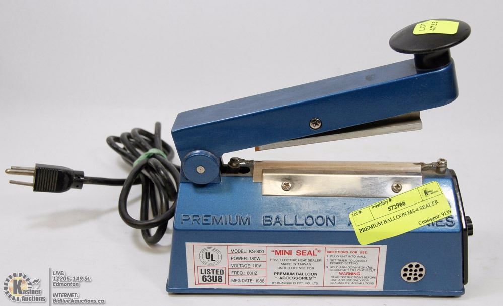

I bought an industrial looking GISMO at a thrift store for five bucks. It is like a bag sealer but was meant to seal Mylar Balloons. Mini Seal MS-4. Rather stout piece of kit with temperature control. If I had some netting, I might try that. Otherwise it has sat in a drawer for ten or more years!

I'm not one to try and re-invent the wheel. Why not the crimping method with an aluminum ring, as seen on many of these supermarket net packaging? Or small high quality tye raps bought in bulk.

I agree, I'd get a bag stapler (like on mesh bags, sausage tubes, etc).

Thanks for all suggestions. Cant have any metal such as hog rings etc as it would get into the socking stripping machines at harvest time. That mylar sealing machine is what I was envisioning. Will have to try and find one for sale somewhere.
