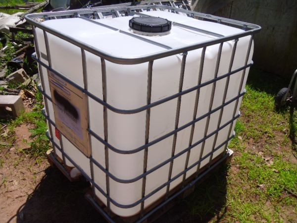

Saw these on CL:
Poly Storage Tanks: water food fuel WVO biodiesel
Has anyone ever used one of these for diesel storage? I like the metal cage for protection.

Yes, there have been a number of threads about them. I've been using one for about four years now. I put an electric pump on it.
I would suggest keeping it out of the sun to reduce degradation of the plastic.

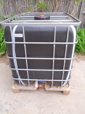

The black plastic wont degrade as fast as the white from ultraviolet rays but the white will allow you to see the liquid level. Keep the white one inside and it will be good for many years.
   / Poly storage tanks for fuel storage #4
I've never seen a black one, I didn't know they exist.
However, black would absorb more heat if sitting out in the sun. I don't know if that would cause more problems.
