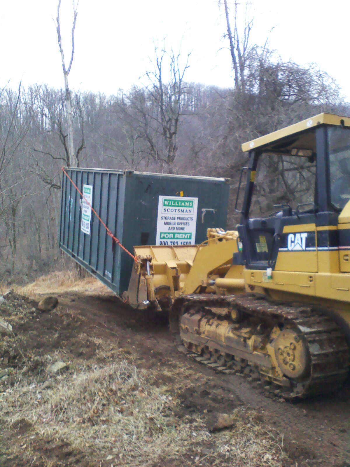

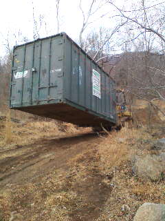

I had my 8' x 20' shipping container delivered and of course the tractor trailer couldn't make it up the mountain road to the property so I had to use the Cat 953 loader to carry it up the road. I rigged it from the end and added two chains from the top far corners back to the loader bucket. Then I just had to roll the bucket back and pick the entire container up. Just a minor pucker factor driving it up the mountain road. Feb22_0001.jpg

Very clever and well done. Looks like it would be hard to see where you were going. :D

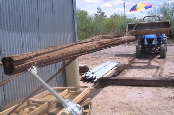

Picture is 25' of light pole out in front of my bucket.

Not to bad to see what's up ahead. The dozer is just about as wide as the shipping container. The bucket is 8 feet wide.
