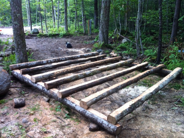

The shop base is made from a bunch of beech trees that were cleared for house construction.

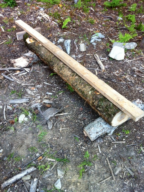

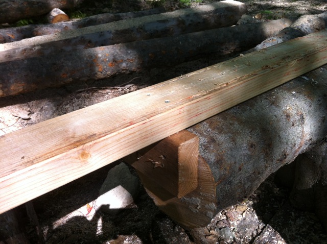

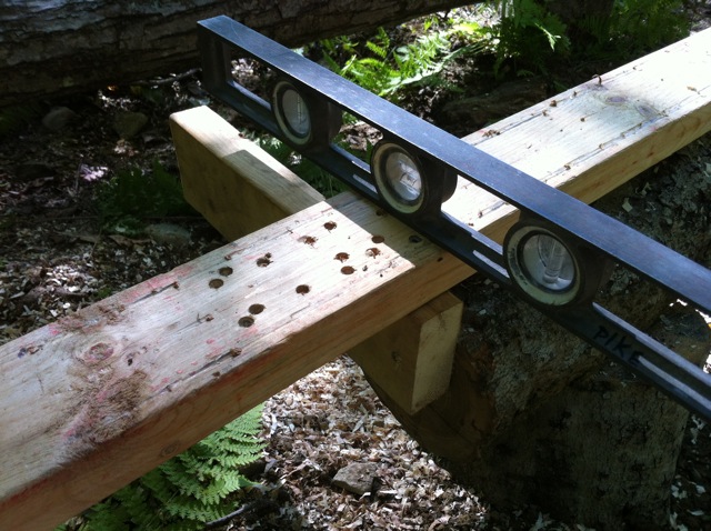

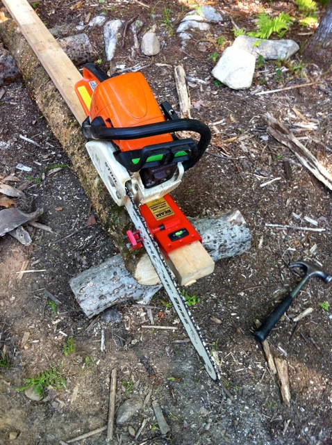

Using my chain saw and a $45 "Beam Machine" I flattened one side of the logs. You screw a 2x4 to the log and level it along it's length. I tried it on a test log first.
The Beam Machine gets clamped onto the chainsaw bar. The 2x4 acts as a rail guide to make a straight cut.

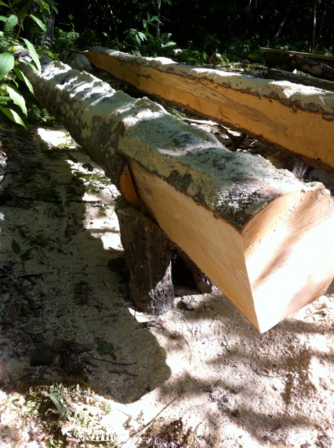

I would't try to mill beams for a whole house with this but it's great for what I had in mind.

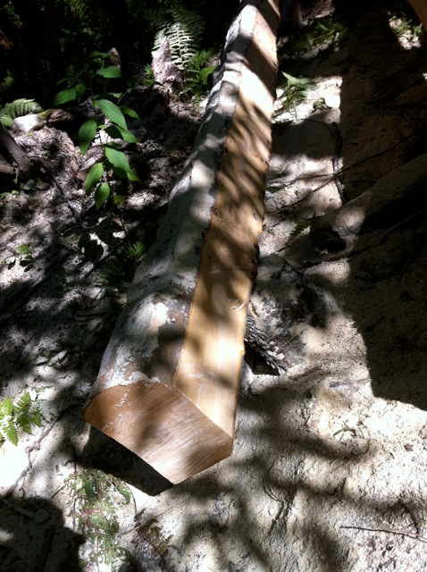

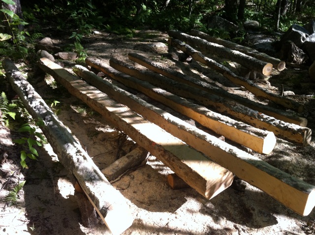

Once the flat side is cut I turned the log over to flatten the first 12" to 14" of the other side of the log. I made up a jig so the cut would be parallel to the first and make a 6" wide beam.
The floor beams were ready.
