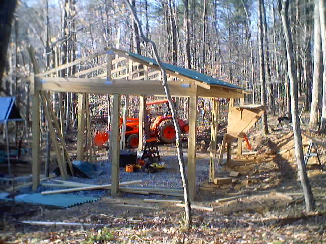

I have been building a similar pole shed at the bottom of a small ravine for temporary equipment storage... attached is a photo - I hope - of the poles and trusses going up early last spring. Maybe you can see it's just at the foot of the grade, so we knew there was going to be a water problem.
We dug a small trench on the uphill sides (to the right and facing the camera in the picture) and added 4" perf in an "L" going around the sides to opening to daylight at the left. Worked great... my only other recommendation is to use a fabric silt blocking sleeve around the pipe to prevent clogging.
