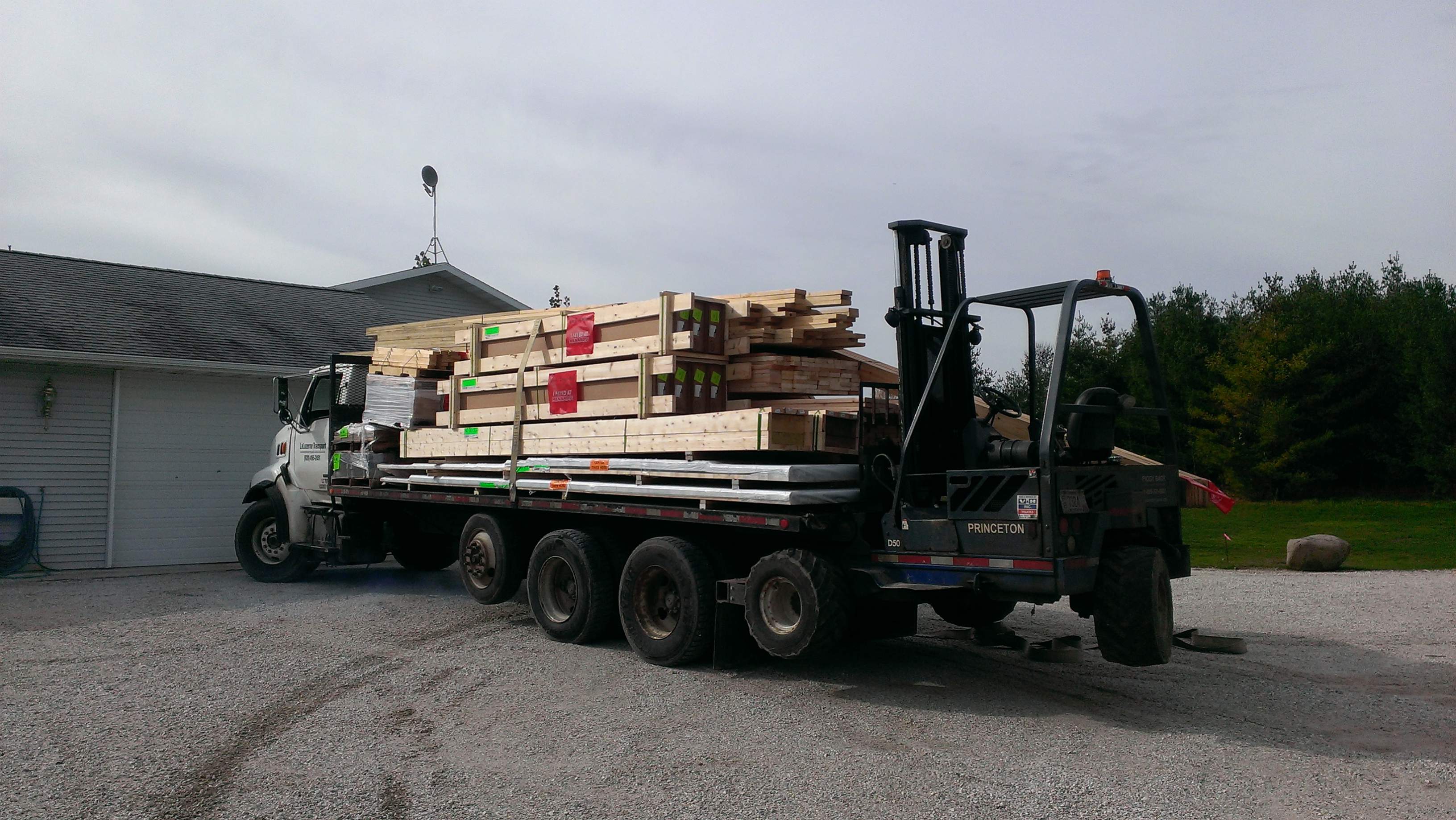

Building came from Menards, can稚 beat the price and it was a hassle. I have not found an estimator for them on line but they have one in their stores gives good cost and a pretty good materials break down that you can work backwards.
The guy that is doing this build worked with me to frame both the office and shop so I am fairly confident he will do it for that price. I have looked at the Menards materials? And you can稚 beat it.

Here is a link to who puts together their Post frame kits, you will find it helpful for laying out and how they have it engineered. I have found it useful for comparing build specs. If you are in different area you will have different wind and snow loads, but this is a start.
Steve
http://www.midwestmanufacturing.com/MidwestManufacturing/web/docs/pdf/PostframeHH.pdf

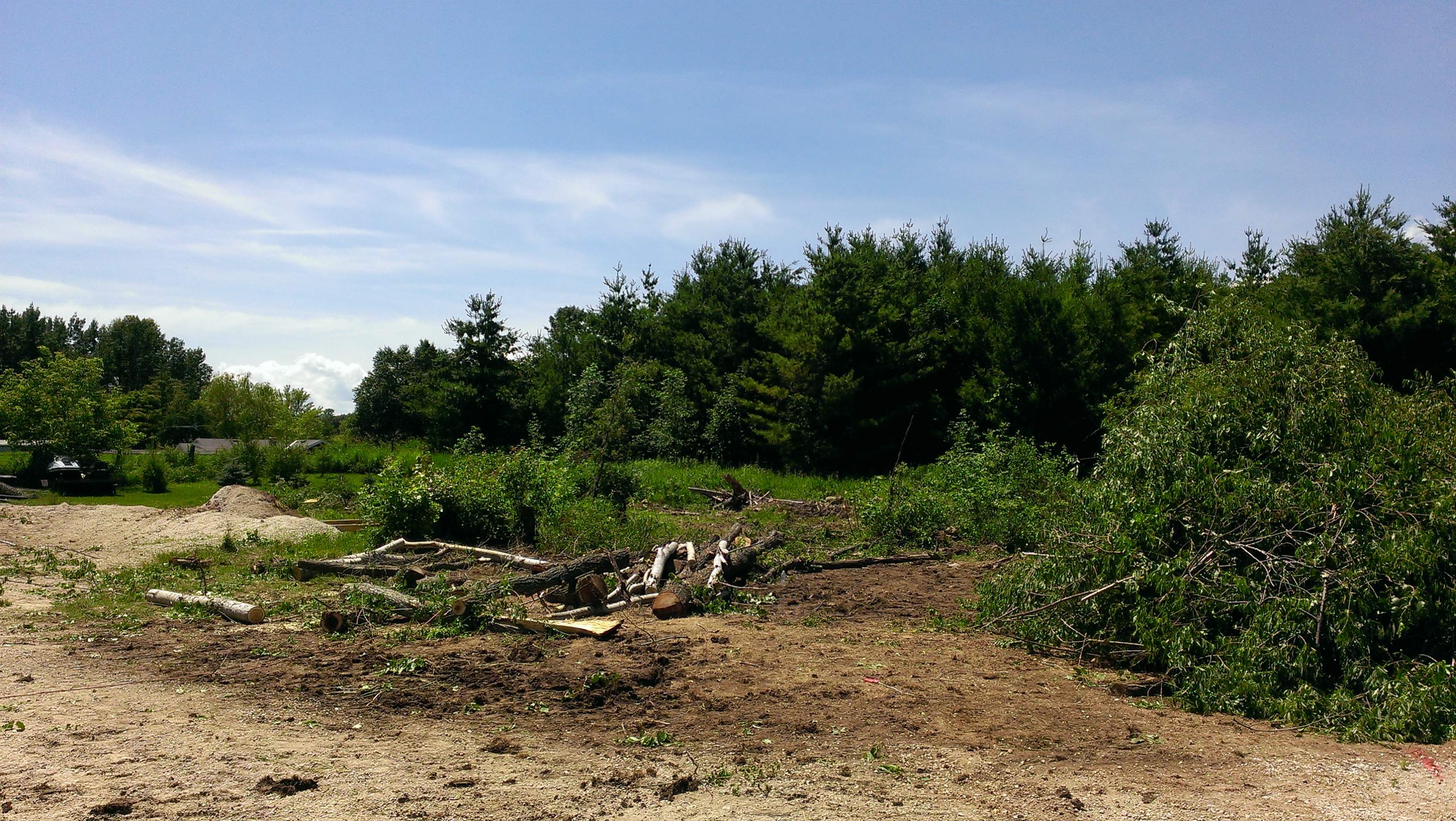

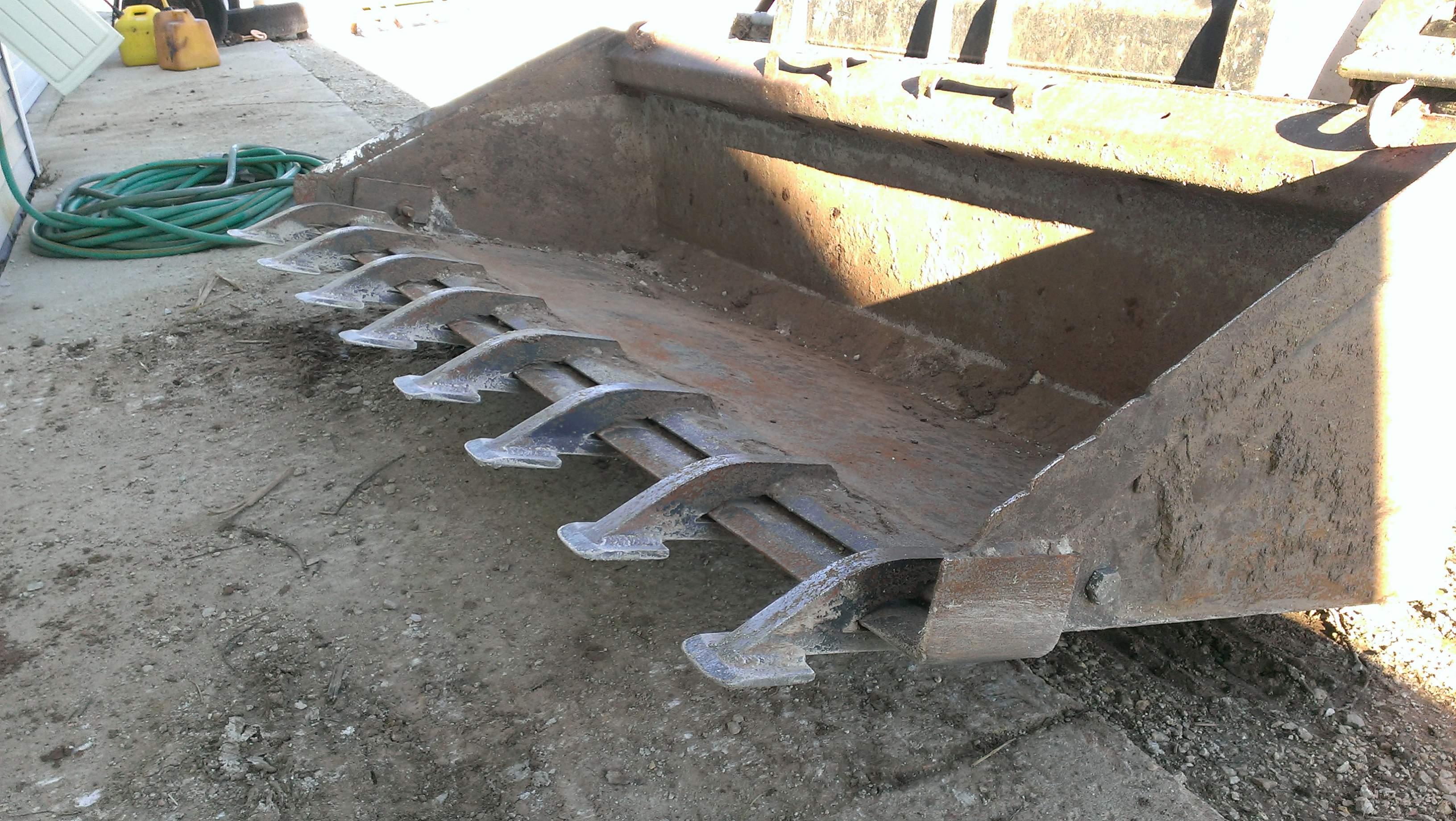

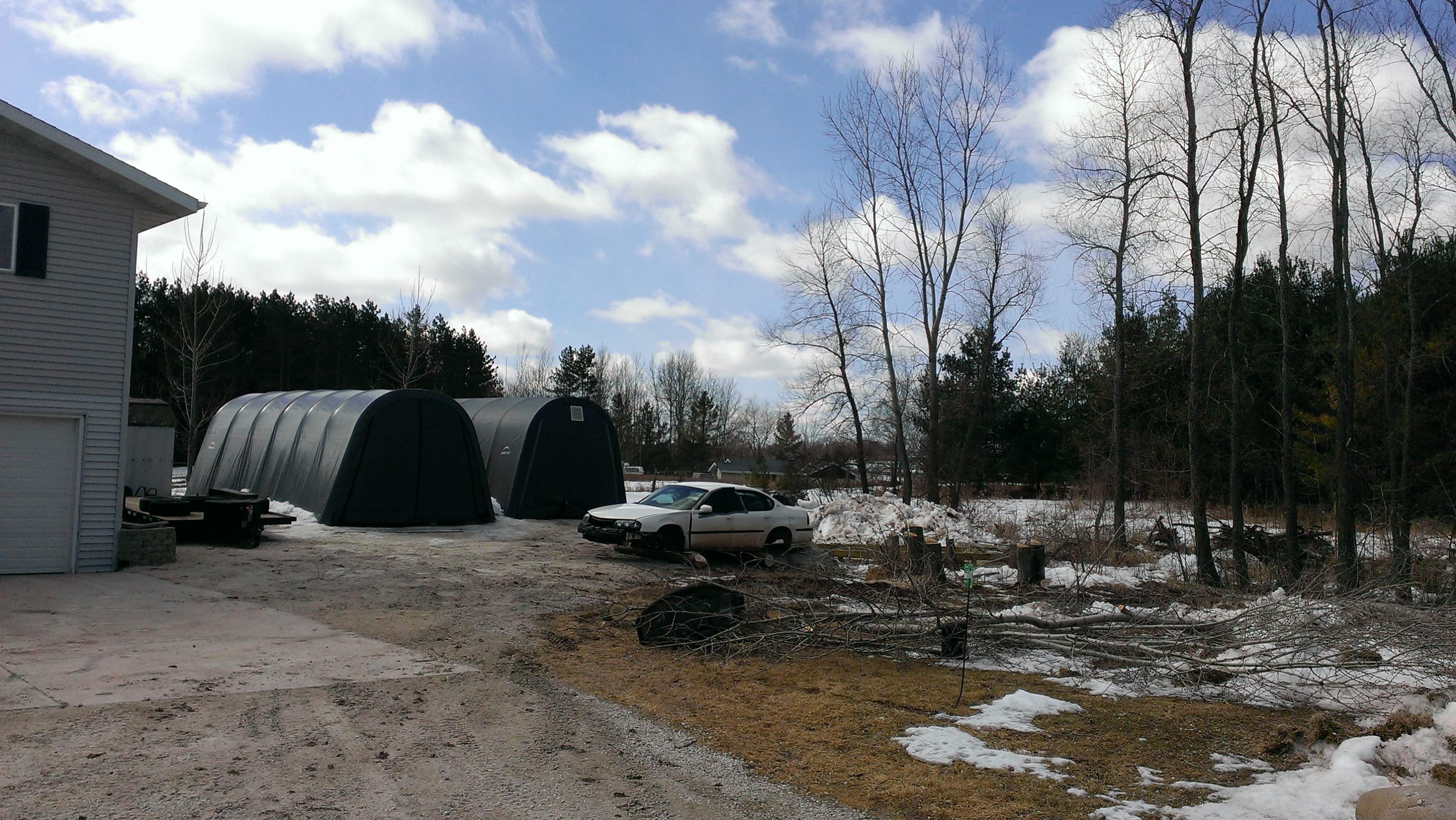

This project would not have been impossible without a transit, pallet forks, tracks and ripper bar on the bucket. The back hoe attachment, where as it is an expensive toy, everything here could been done without it. The issue we had was getting everything to drain correctly. The area directly in front of pic 1, was a low spot that would fill with standing water.

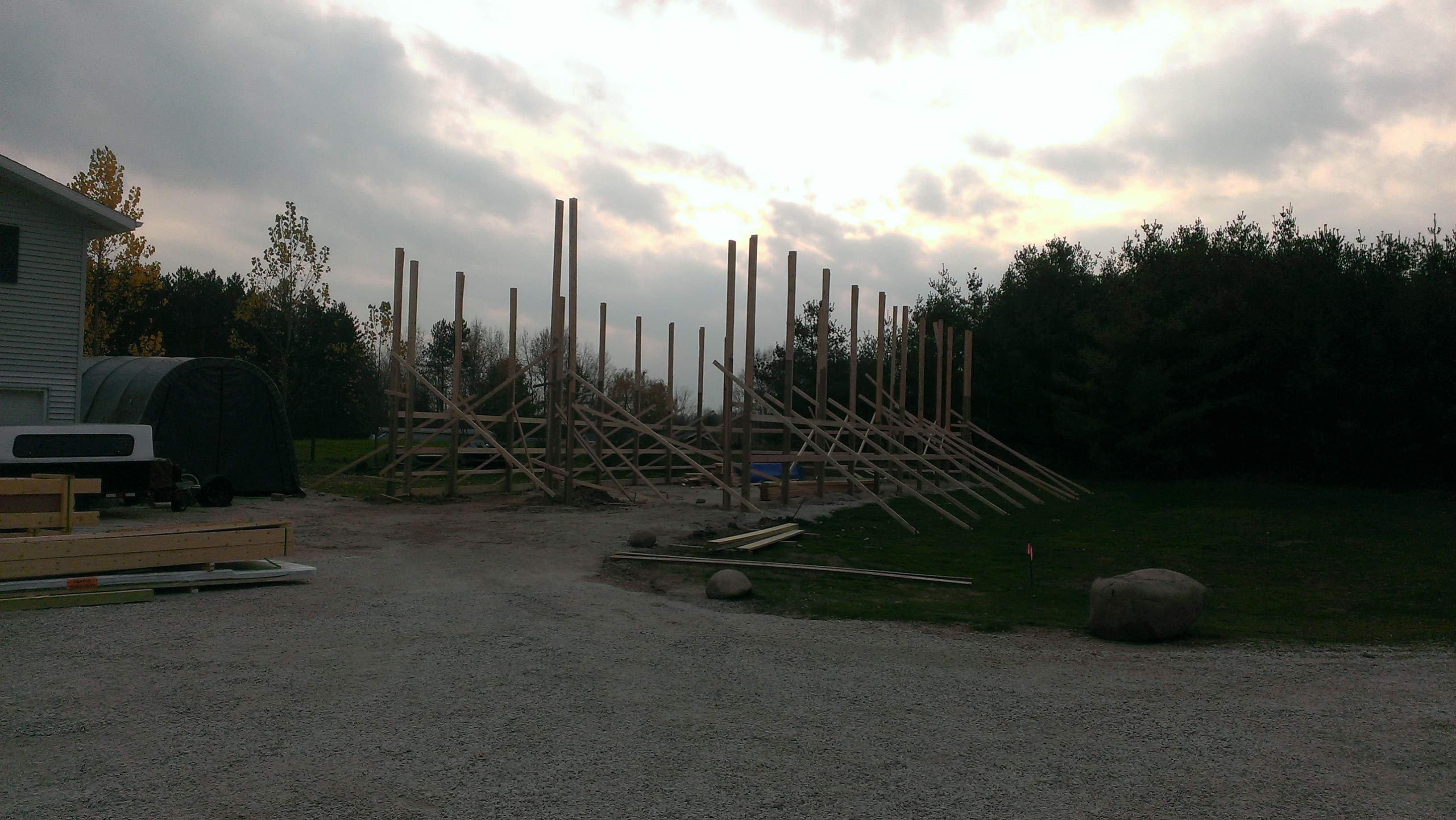

The land before we purchased it was a farm and over the years the farmers throw all the rocks in the whole and scrub trees grow with interlocking trunks and roots. We had to get that area to drain, so we could place the building off to the left. We had just enough pitch to be able to get rid of it without a dry well. In fact last fall we installed one and pumped it out all spring, just so we could get in and work it. (pic 2)

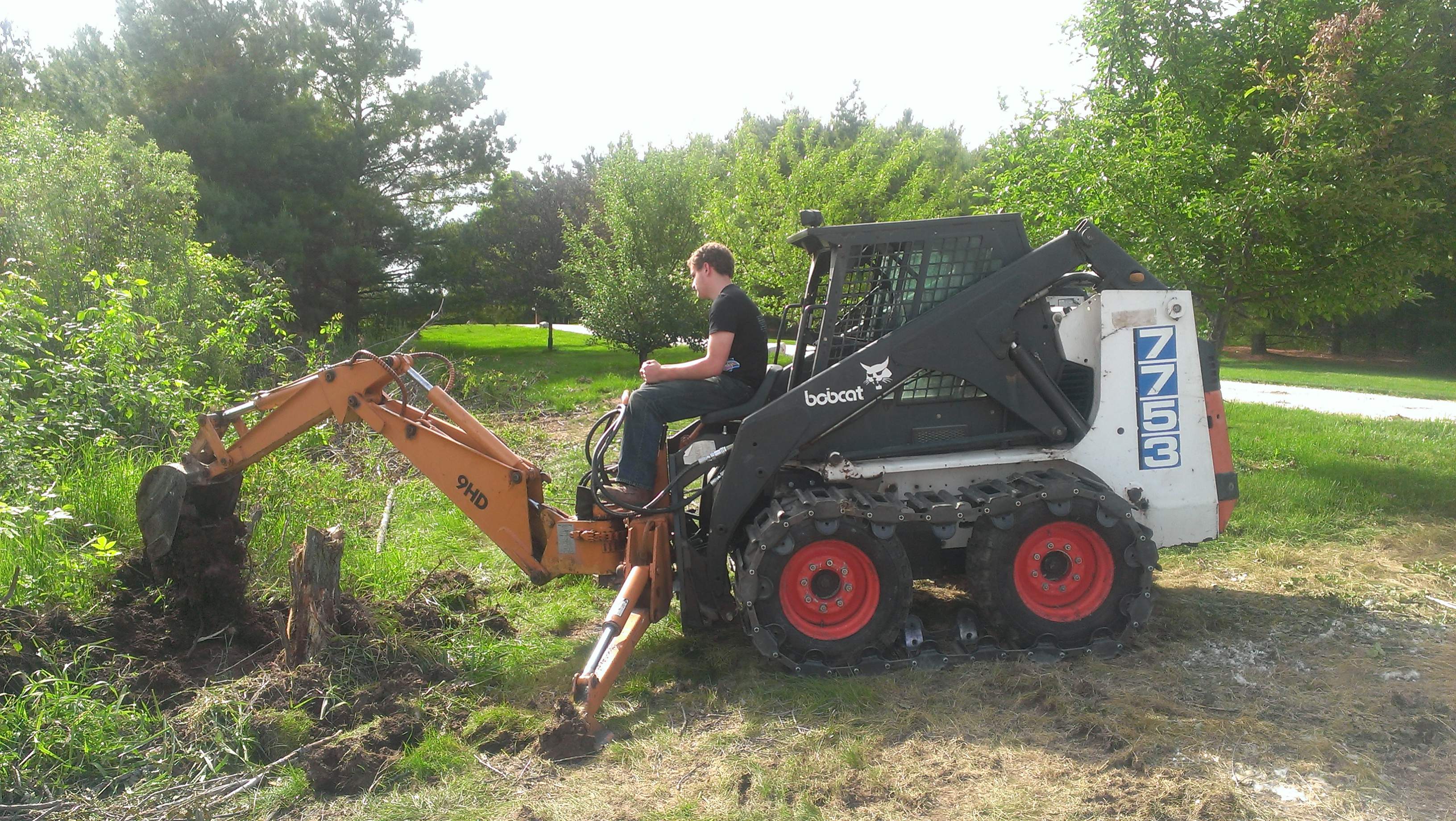

The back hoe in pic 3, waste of time. What we found worked best was leave stump high, use the forks to jab into the ground to rip the roots lose. Then you can put the forks high on the stump, work it back and forth and just fold it over. Then use the forks as a paddle to put the stumps in a pile and burn them.

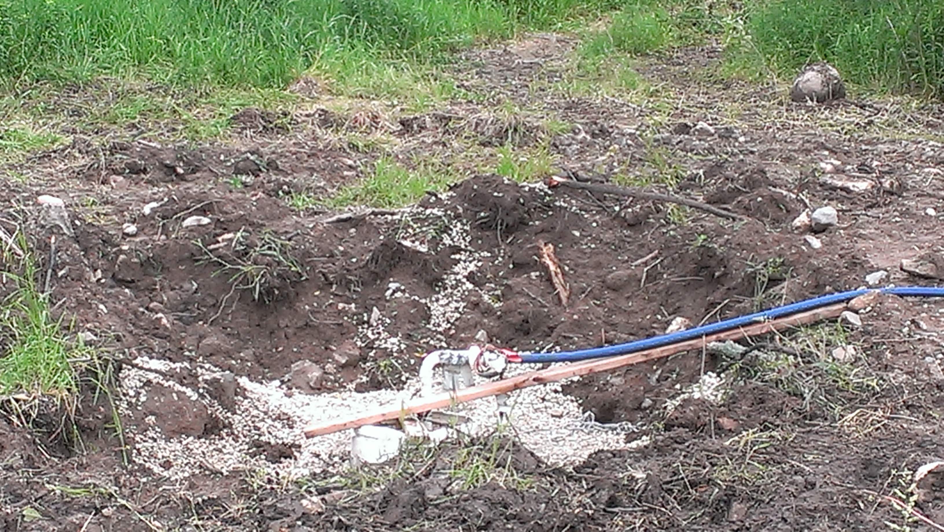

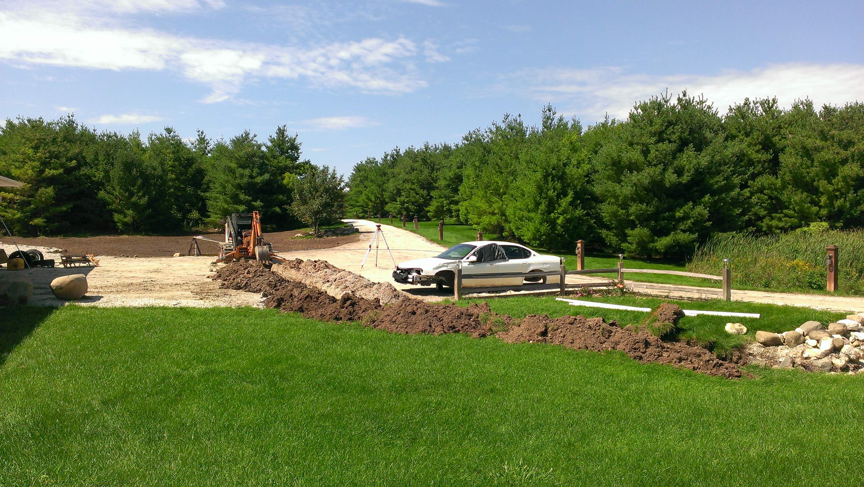

We then used the ripper bar (pic 4) as a rake to pile up the brush and burn. The only thing we used the hoe for was the trench for the drain tile. It was not very deep and we could have used the forks, but we had the hoe so why not. (pic 5).

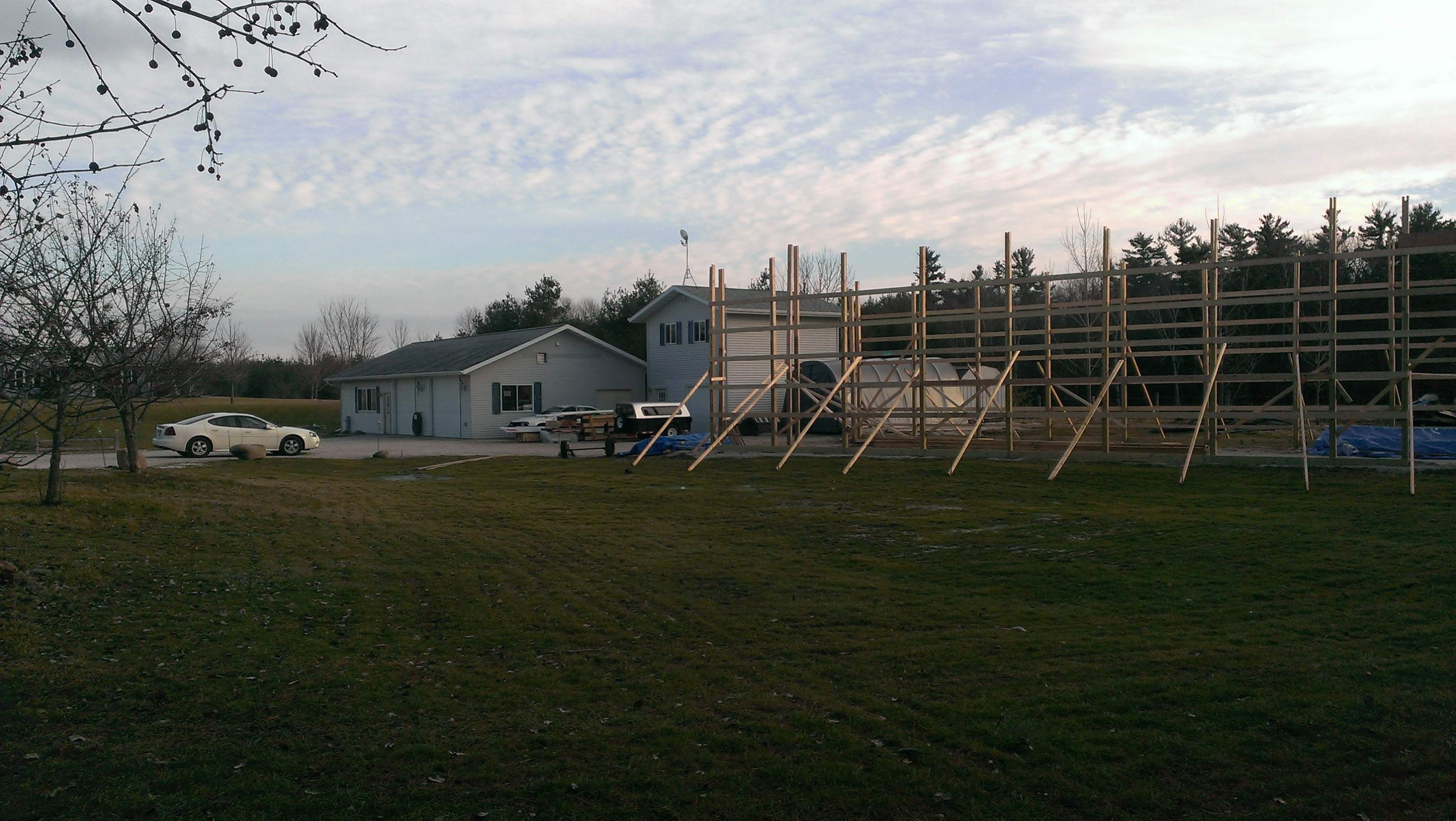

We were able to get everything to look like this (pic 6), without any hand raking. We used the ripper bar to rake the seed in, hired someone for the chain saw work and that was it.

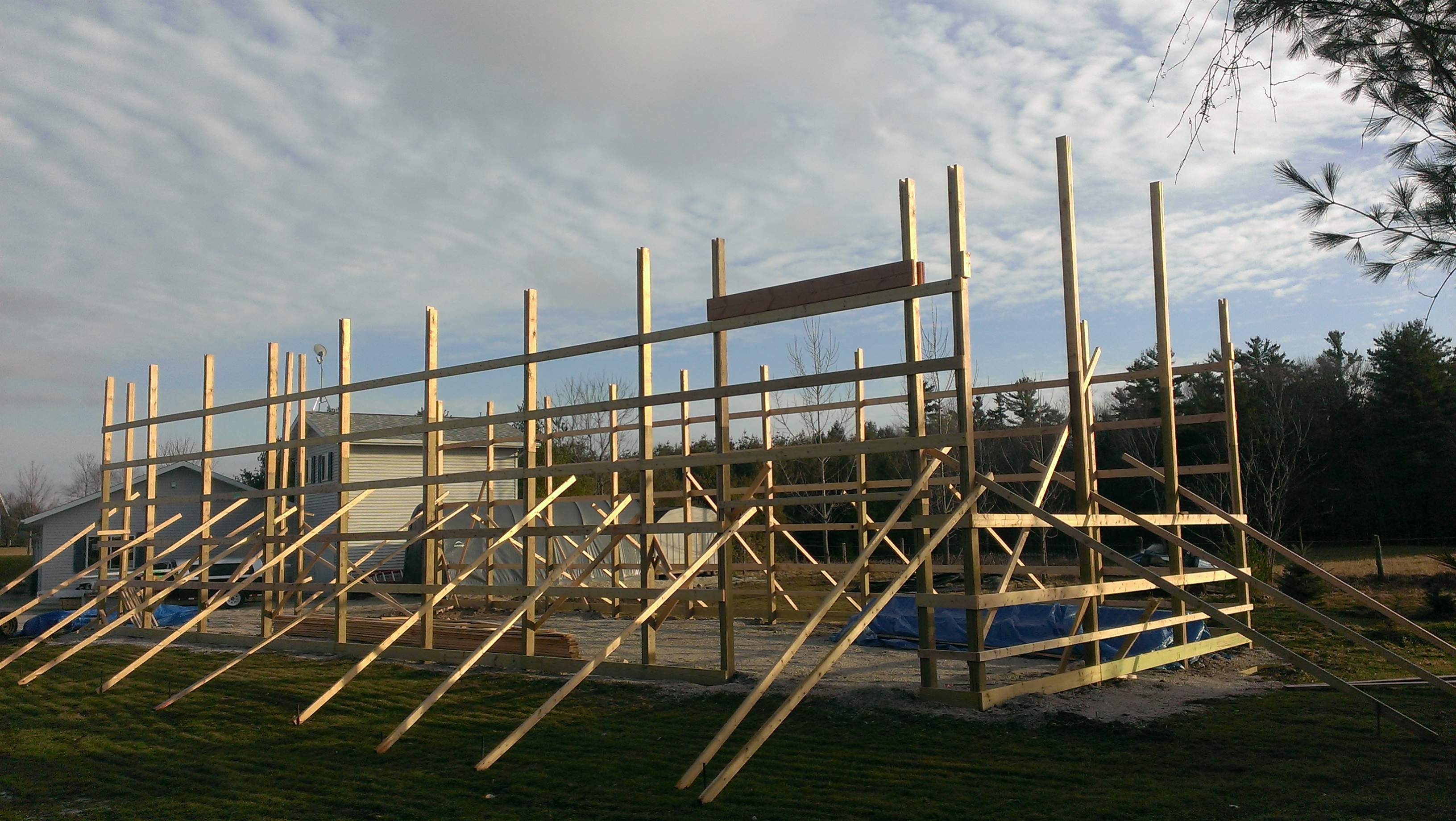

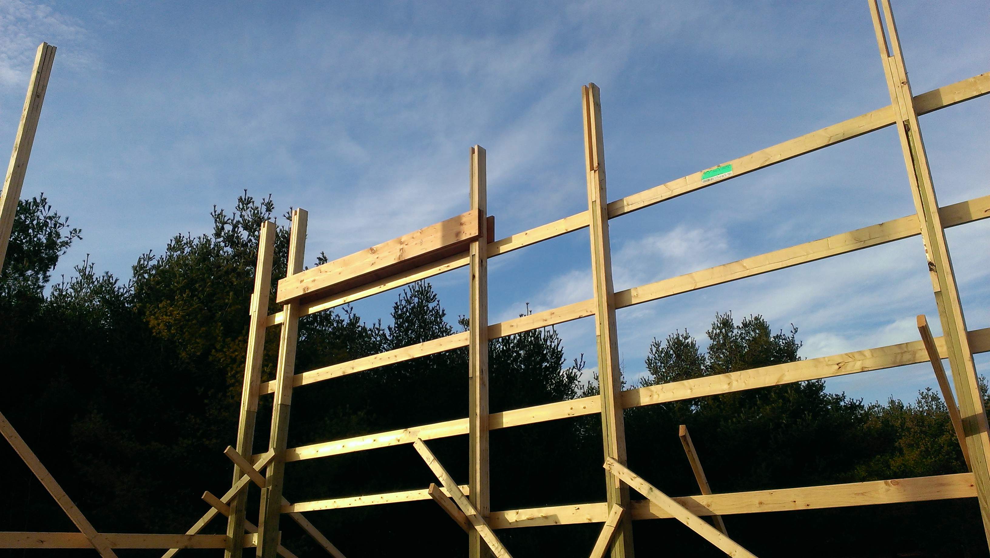

Here is where we sit today. Waiting for the right weather. We put the poles in the ground before the frost. The holes are 52 deep, there is a patio block they sit on then, two by six nailed around outside, this makes it, so the frost cannot push the pole up. (pic 1a)
The header is for a small over head door. The top girt is spaced down for a 24 over hang all the way around. (pic 2a)
We have to wait for the ground to freeze so we can get around the outside with the lift truck without sinking. The building will be finished this winter.

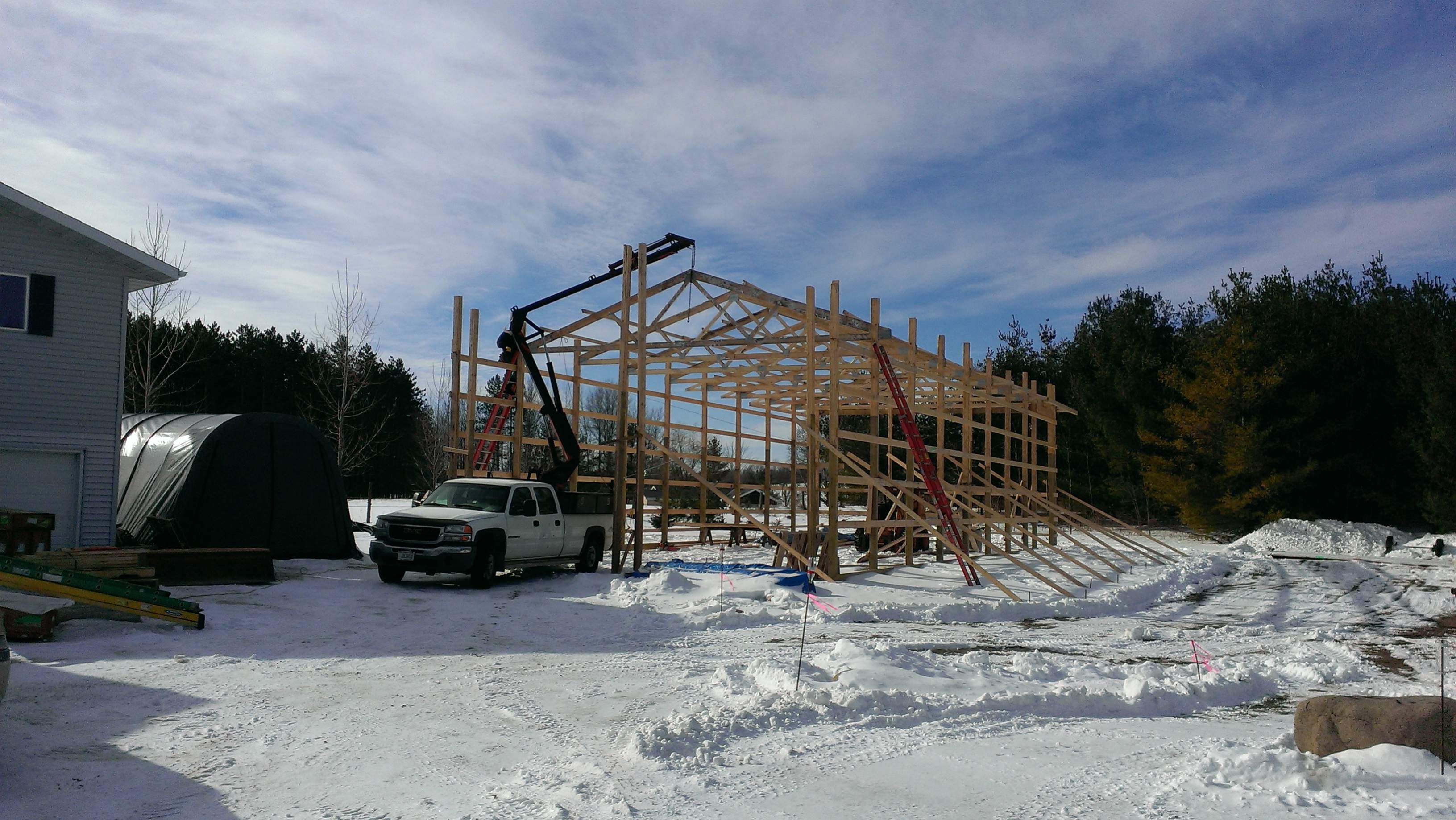

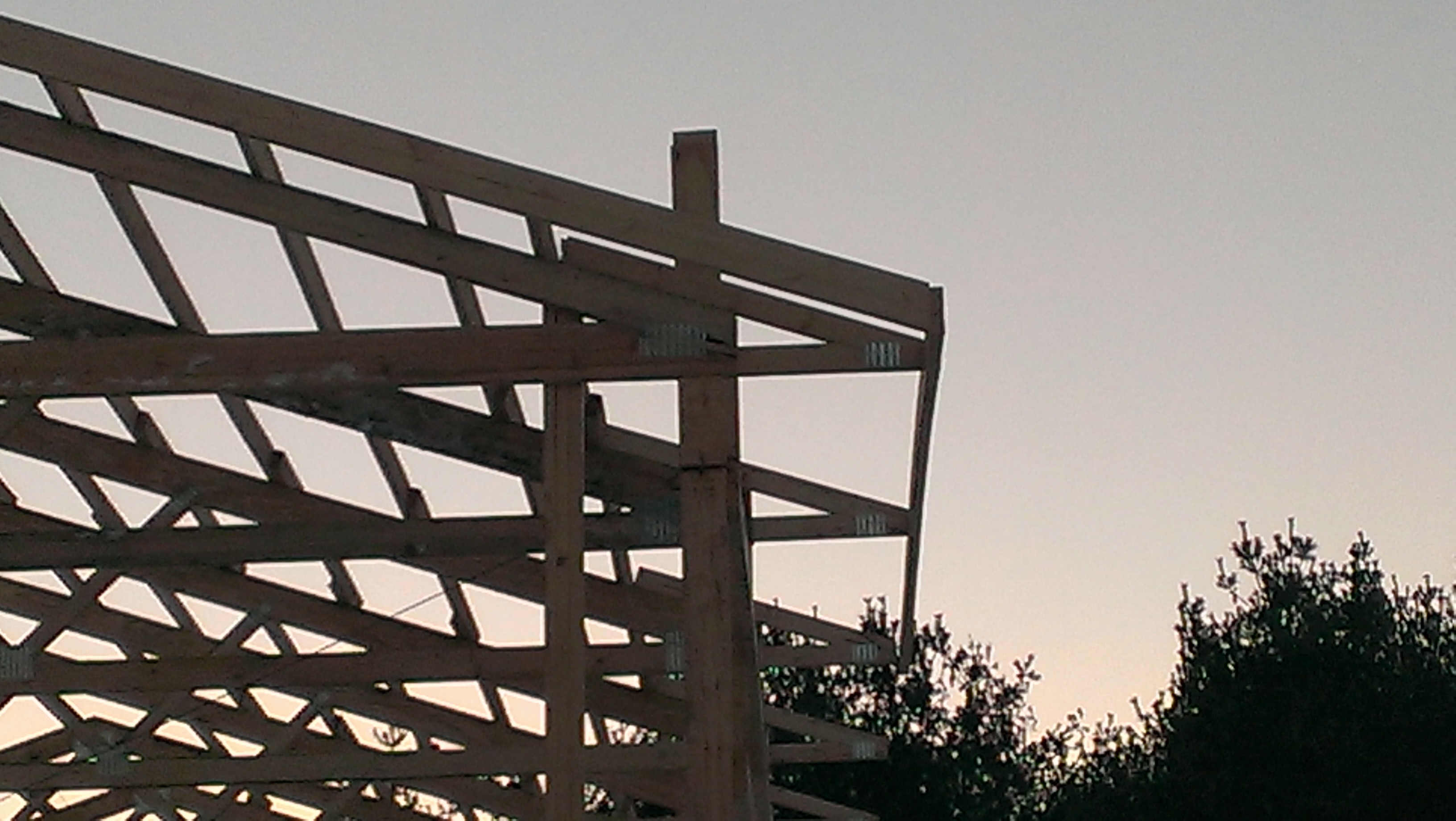

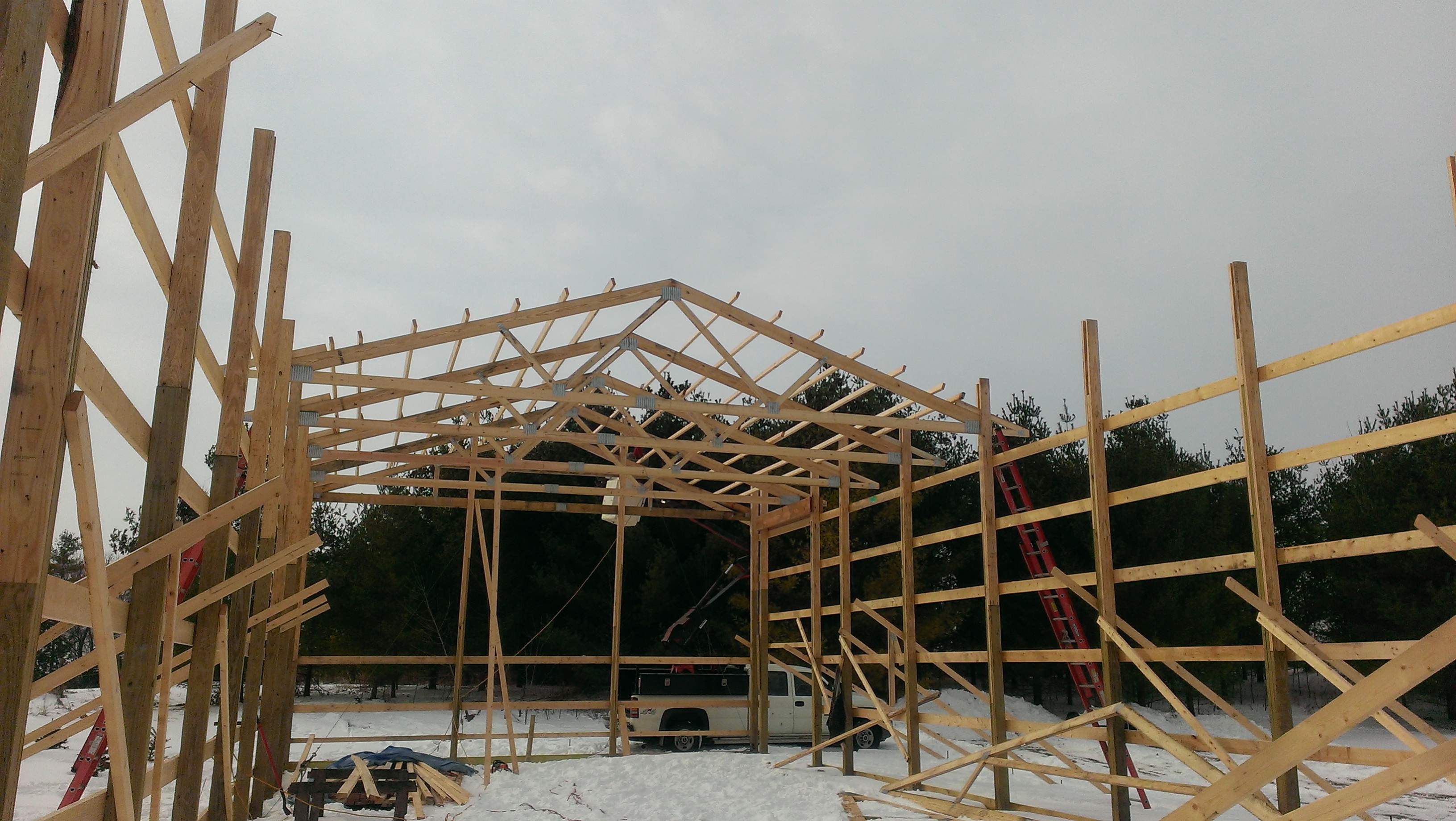

Started back at it. Weather in the mid 20s, as we need the ground frozen so we can get around the building with the lift truck.
just about the last truss
The 24" over hang framing
The is where we/he ended. after the first day. In reality there is only one guy doing it, i'm not doing much, but providing moral support. One guy pretty much built the whole thing by himself. Its fun to watch him work. he has it down to a science. What you are looking at right now poles and everything is one guy, 30 hours.

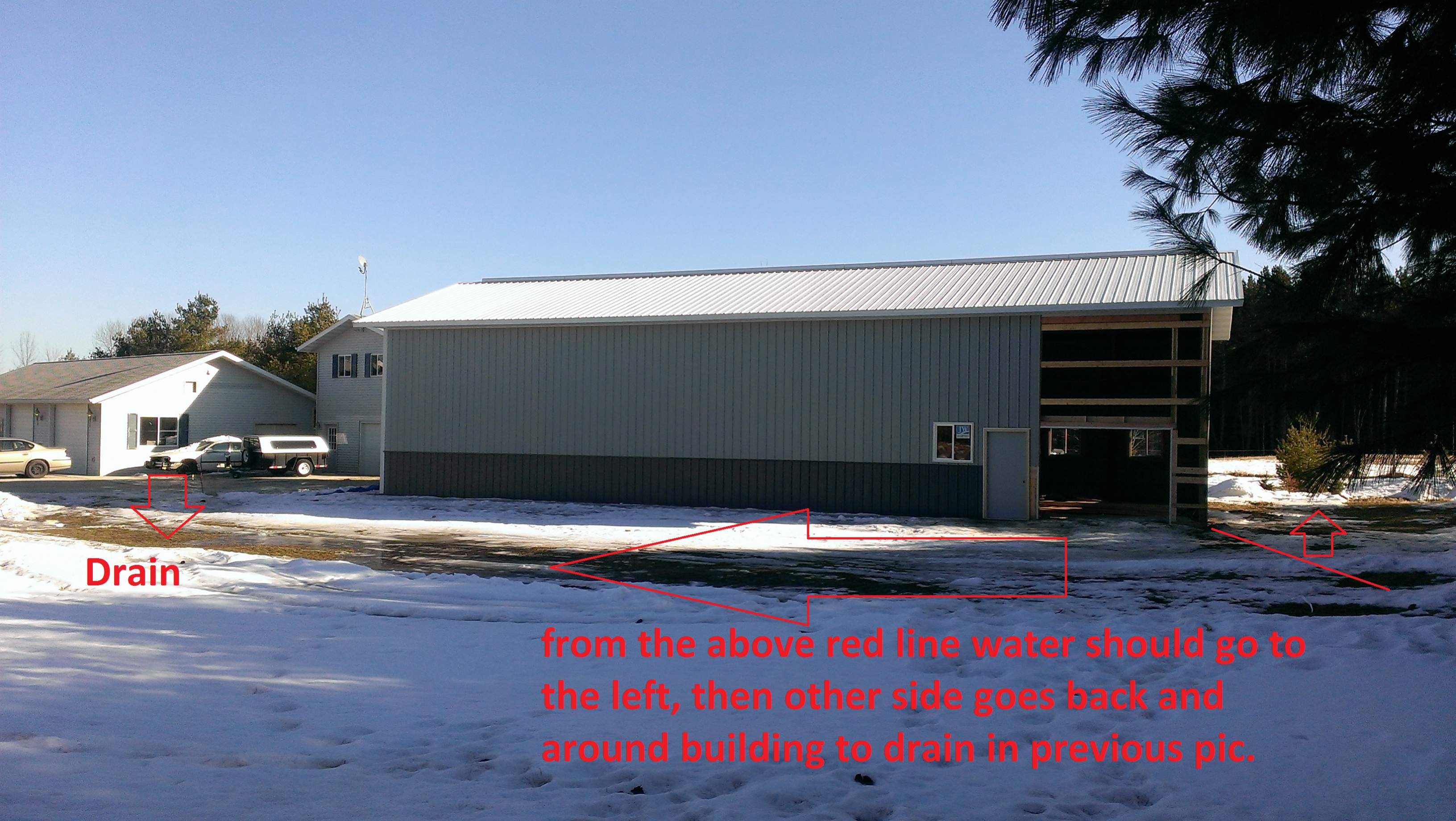

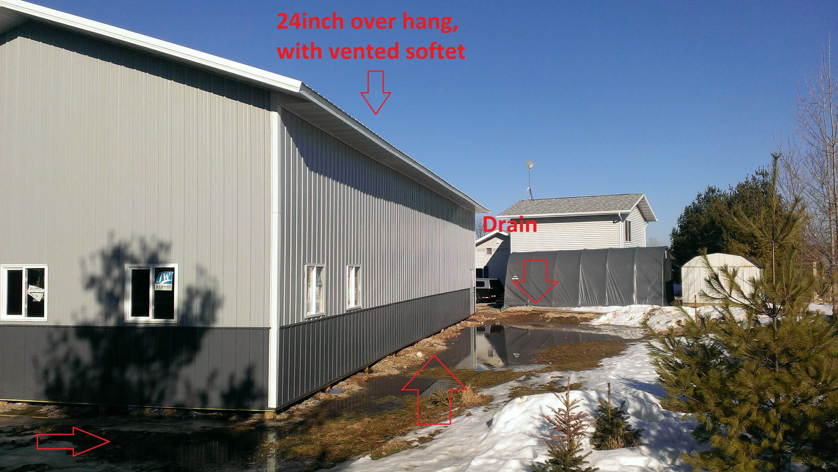

Things are thawing out, this would be why we had to do all the work when the ground was frozen. There is a drain, just in front of the gray tarp building. Looks like we will be putting heat tape in that for next year.
On this side the water goes the other direction. They cut two sheets 8" short, so they will have to be special ordered, around here everything is special order unless is is, green, brown or tan. We had to put most of it together with white screws as they shorted us the gray one and they are special order. We will go back take all the white screws out and replace them. We had to get the steel up while ground was frozen.

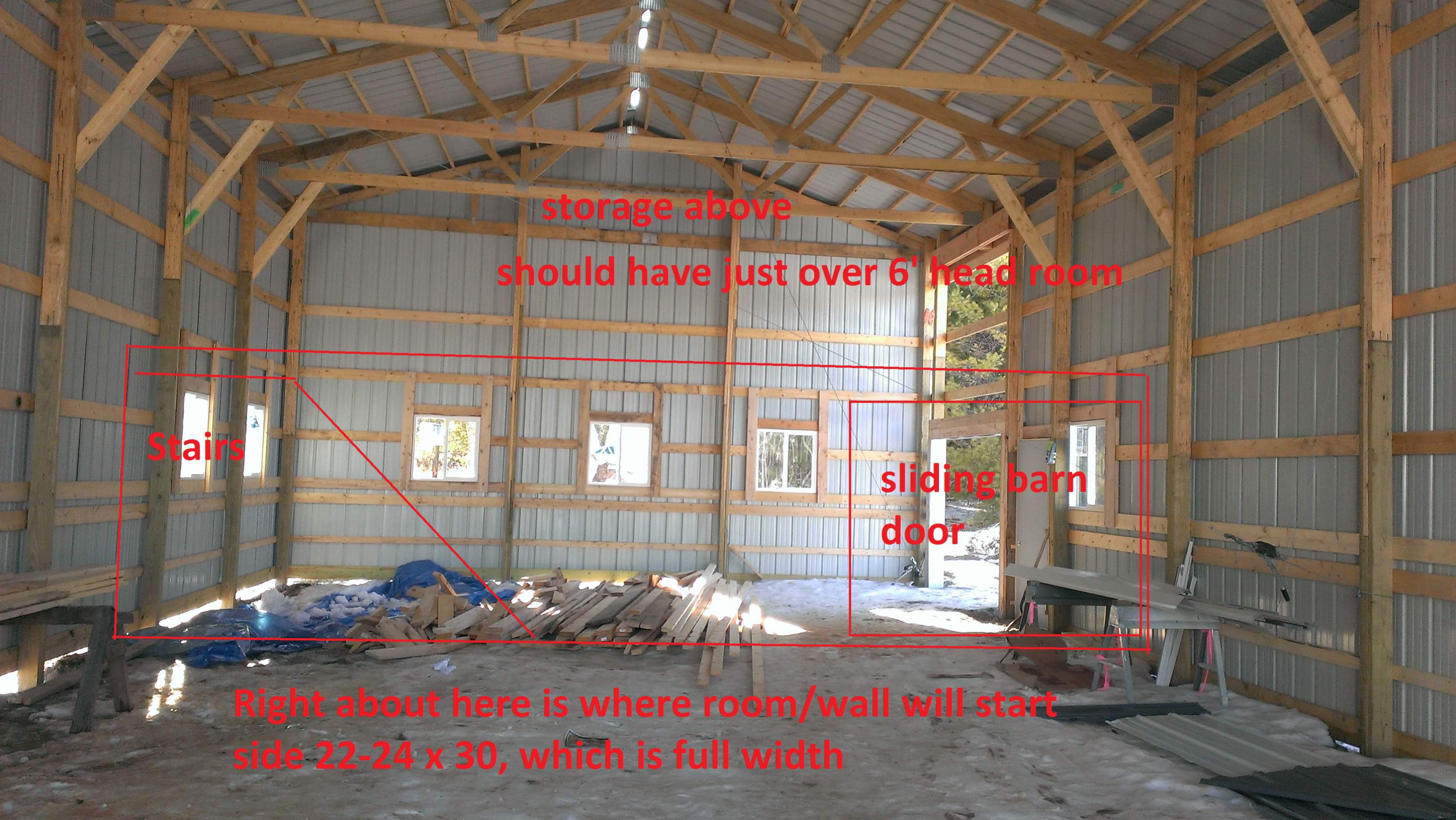

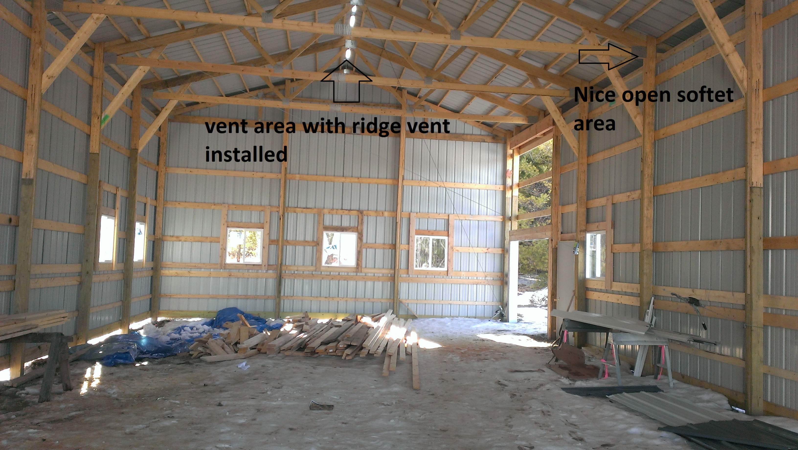

Here is inside view. My big concern was venting the building and keeping condensation as low as possible. That is actually why i went with the white for roof color.
In the back 22-24' I am going to put a heated room with storage above. It will be a poured floor with in floor heat. We are going to use a 40 gal propane hot water heater that is about 2 years old, got it when some one put in one of those instant hot water heaters. As long as everything is insulated real well should heat things just fine. Still not sure on how we are going to do floor joists, I joists or floor truss. Then want to use a Jib crane to lift things for storage. I'll put the questions i have on that in a separate post.:)

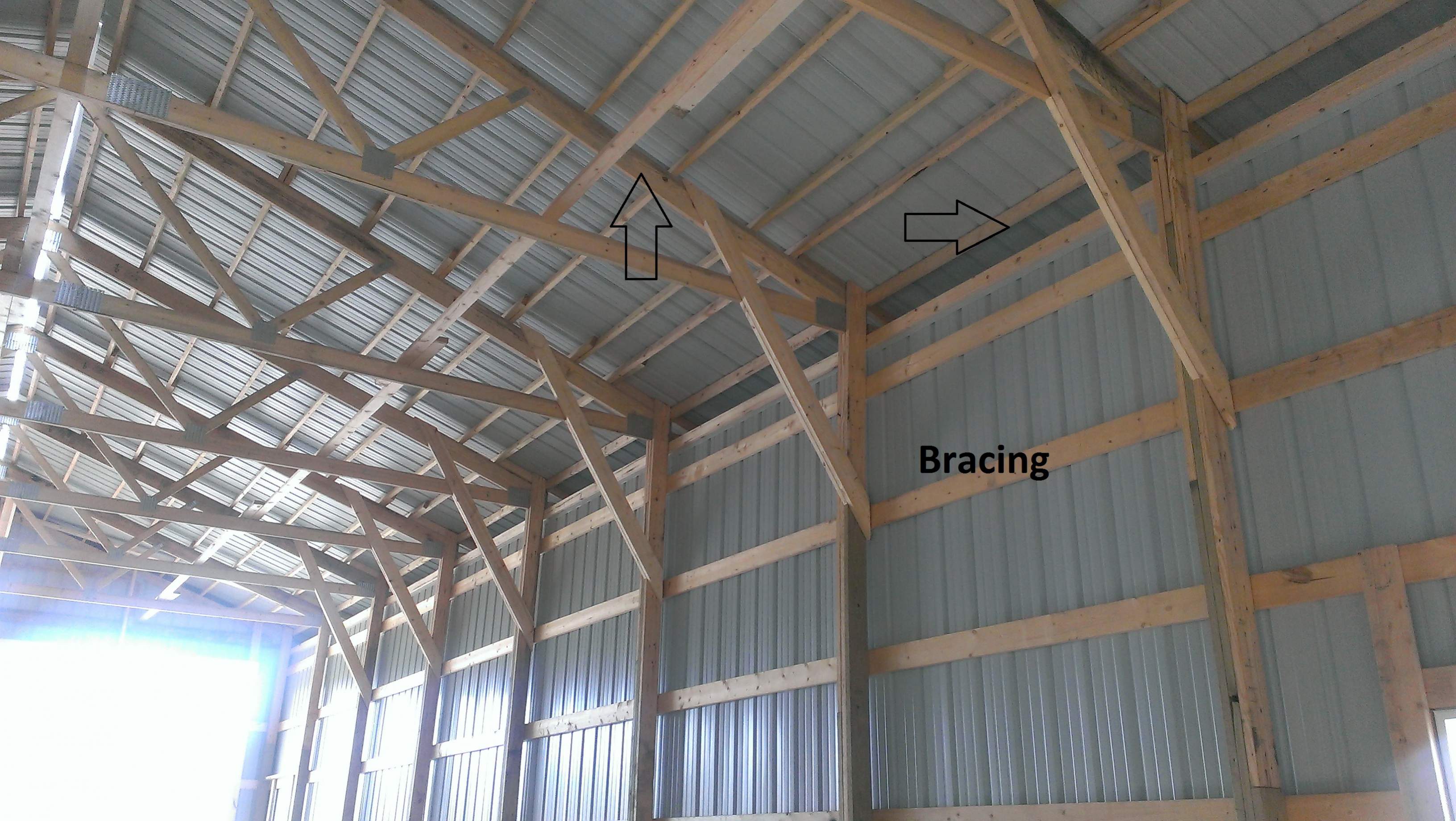

   / Pole Building
#9

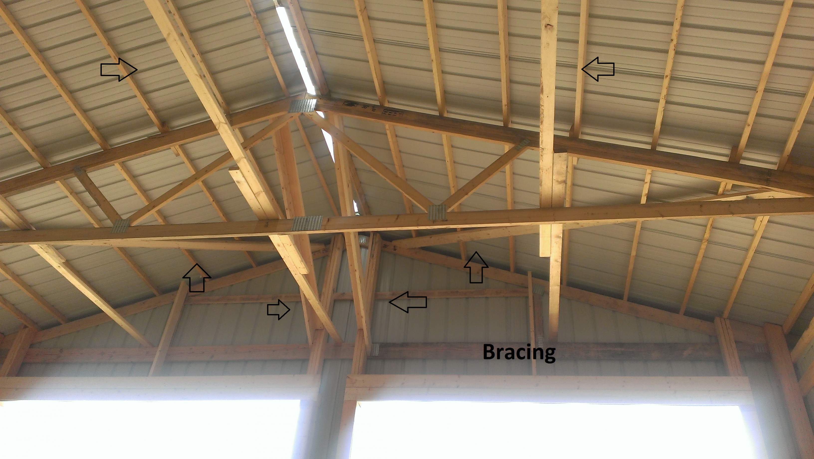

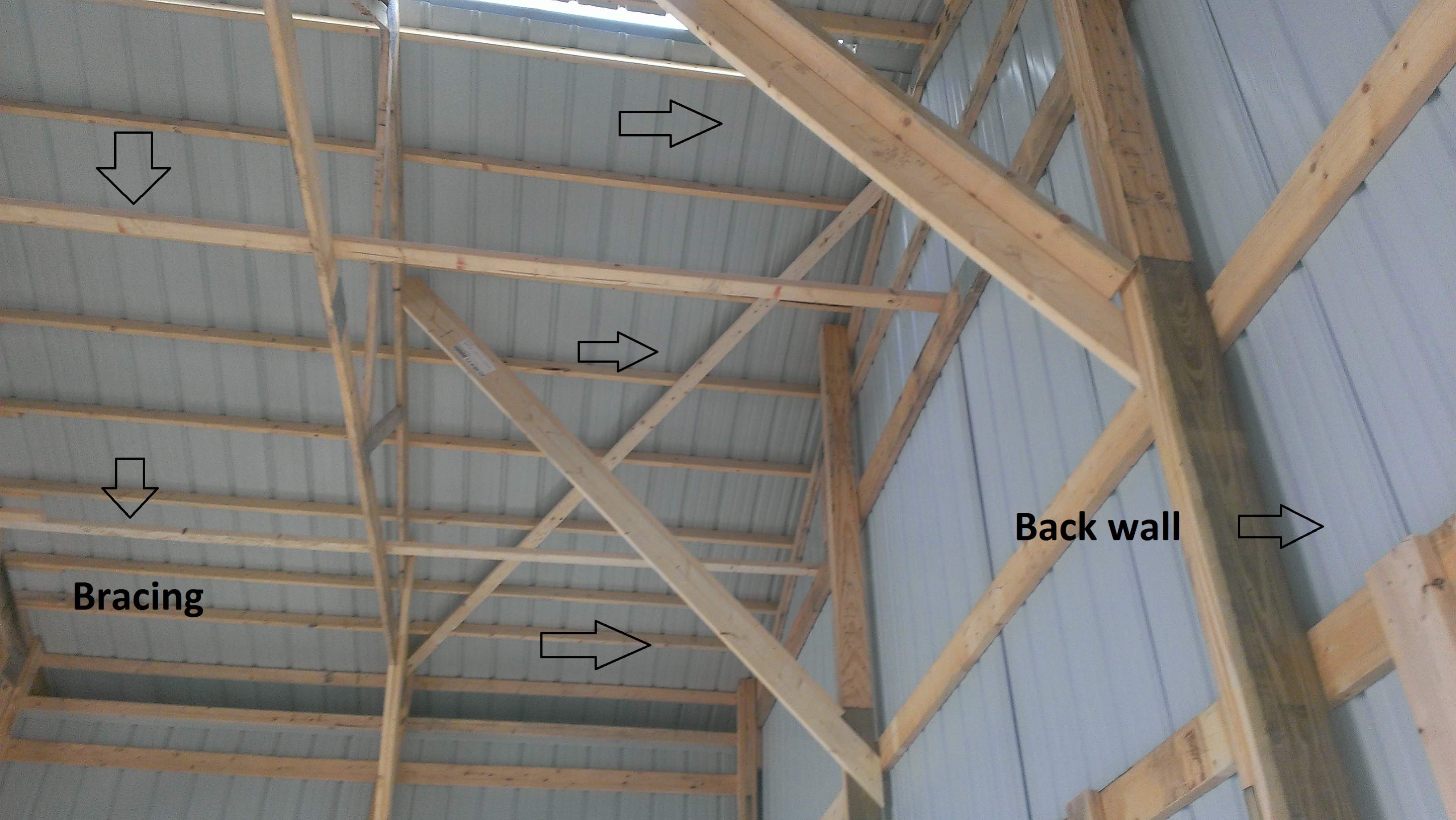

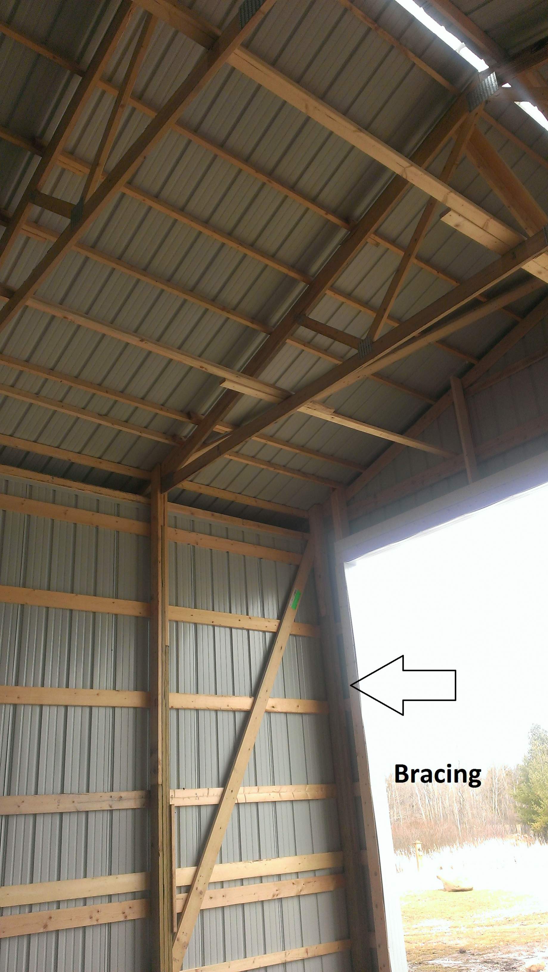

Outside is done. Thought I would post pics of the bracing. Wind loads here are a big deal.
Over head doors is going to be interesting. Haven't put any in that big. Everybody has to start some where.
