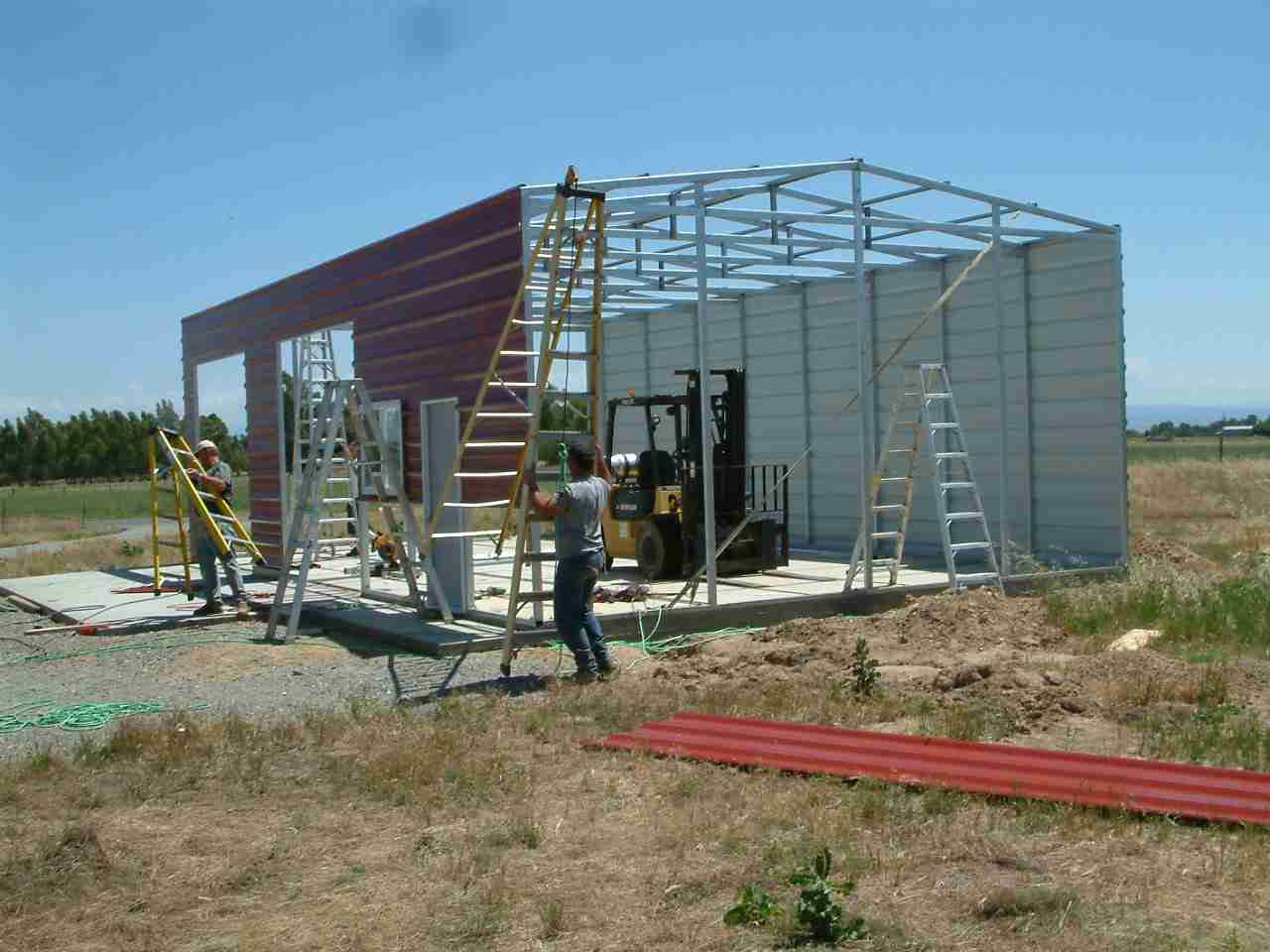

Last June I had an all metal pole barn constructed on my place, 24'x42', 12-ft walls, two 10x10 roll-up doors, one 36" W man door, one window.
Price: $16,200 installed.
The price of the "kit" was about $11,500, not including transportation to the job site.
The concrete slab is 6" thick and cost about $7500.
Just FYI, since IIRC the pole barns you're looking at from the suppliers you mentioned are the wood type.

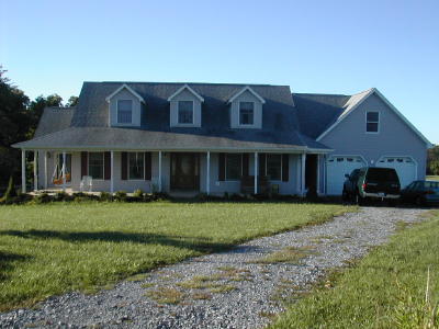

Thanks for the replies, I appreciate the comments and suggestions. More comments specific to Carter/84/APM/other packages appreciated. The goal is for it to be an inexpensive (is there such a thing) building for the tractors and stuff, and shop. I know what you mean about the cha..ching factor when adding changes to the package price. A 30x40x10 advertised built for $10K, goes to $14K by adding 1' overhang and one additional 9x8 door ($500 retail). Taking it to 12' high adds $3k, for less than $200 material price increase. When I see packages for $6-8k, I'm thinking I'll just do the labor which I'm more than capable of doing, it just won't get done in 2 days. The wife insists on the overhangs, which does make a more appealing building as it will sit near the house. She has been pretty patient with me on all my other construction projects, Including building our house, so I will satisfy her requirements.
/forums/images/graemlins/smile.gif Here is picture of couple past projects, the house, and then the 2 car garage attached. Am also working on finishing 3 rooms above the garage and finishing the basement.
