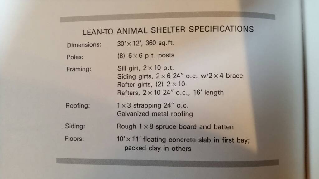

I'll try to post some pics from a book I have...
   / Pole Barn Roof Questions #3
   / Pole Barn Roof Questions #4
This might be helpful too. This is for a 30x12 shed roofed building.
Your roof is not going to be even a 3/12 pitch like the chart above shows though.

I know you are trying to do this inexpensive, I would follow the advice of your friend. Looking at the span calculations you have to space the rafters every 12 inches with an absolute min load to span 16 ft.
I would recommend sizing up to 2 x 8s on 24 inch centers.

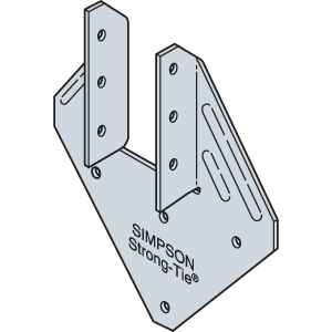

Thanks everyone. Is it better to put the rafters on top of the girders or should I attach them to the side with joist hangers?
If I stand them up on top, what is the best way to keep them in place? Should I use one of those diamond hangers that has the notch on the top?h1.png

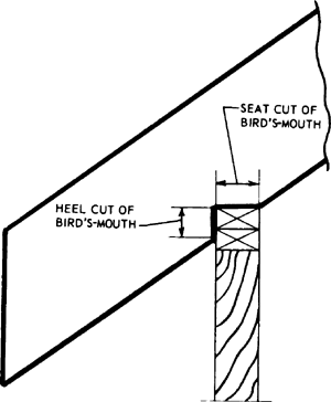

Cut a birds mouth in the bottom of the rafter and use the storm collars (the bracket in your picture) to hold them in place.
