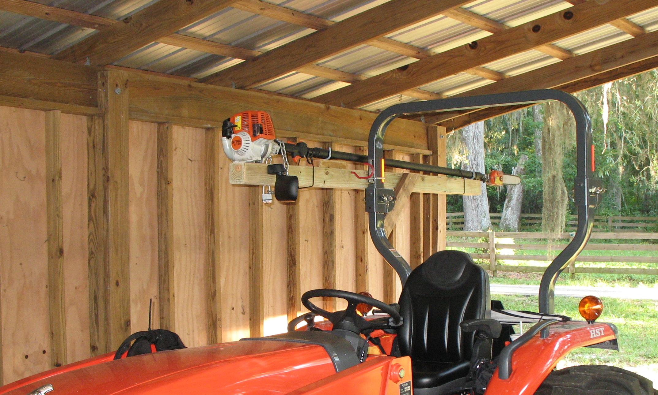

Third method is to notch out the top of the 6x6 on one side 1.5" deep. Then laminate your 2x's together and place them with one being on the notch. This gives you the doubled up strength, plus the strength of sitting on the notch.
This is the exact method a contractor used on the big, tall 40x50 barn I park my tractor in at my parents' place. Just so happens you can see it pretty well in one of my tractor pics. I haven't measured the height, but since my ROPS clears, it must be ~10 feet to the top of the 2x12 beam shown.
