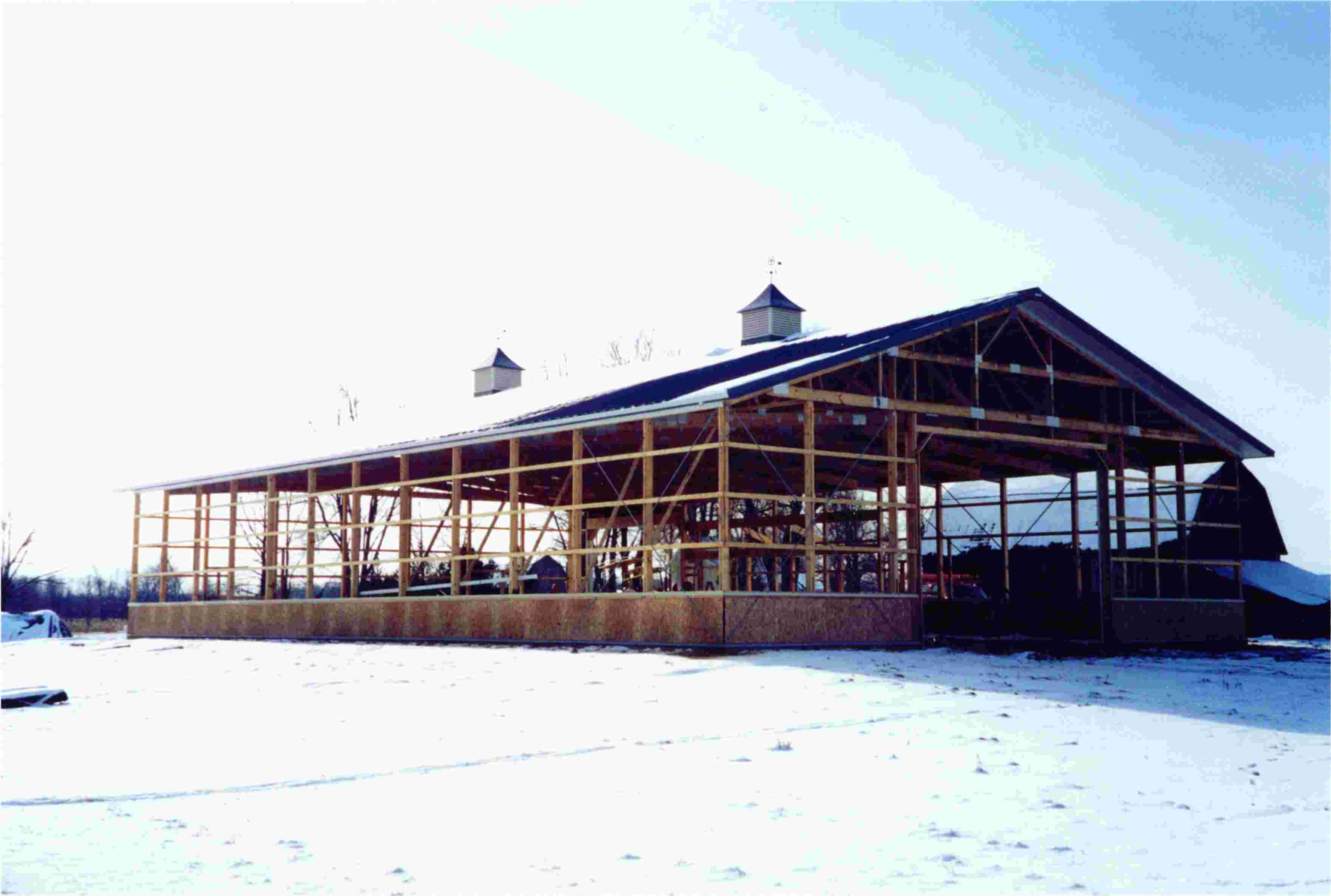

you must be down south? couldnt tell by your bio. just put poles deeper in that area to make sure they are on virgin subsoil. definitely tell the builder the situation.
I had my sight built up 4 foot minus a foot of topsoil, bought an extra foot of depth to make 5' below grade.
