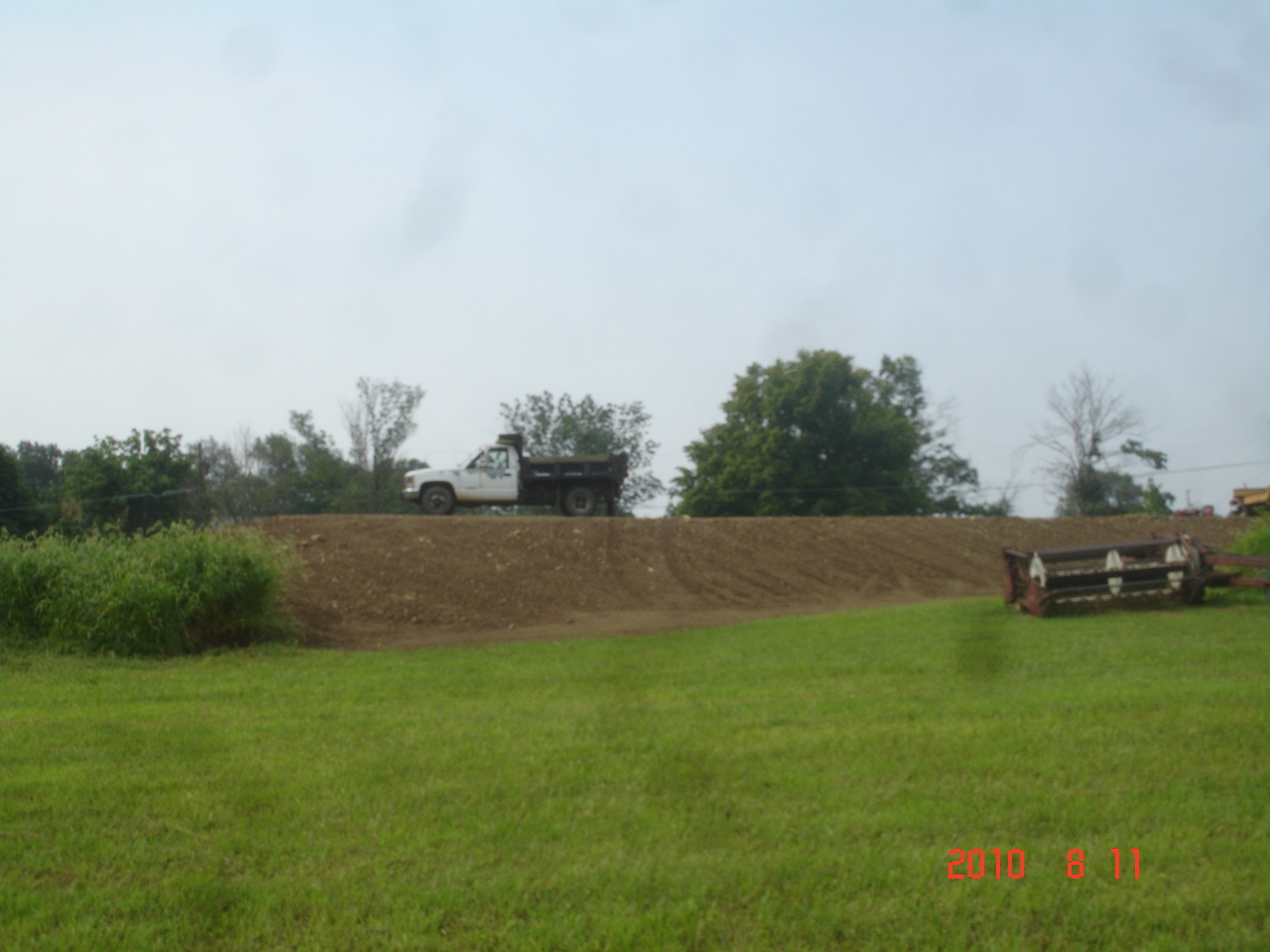

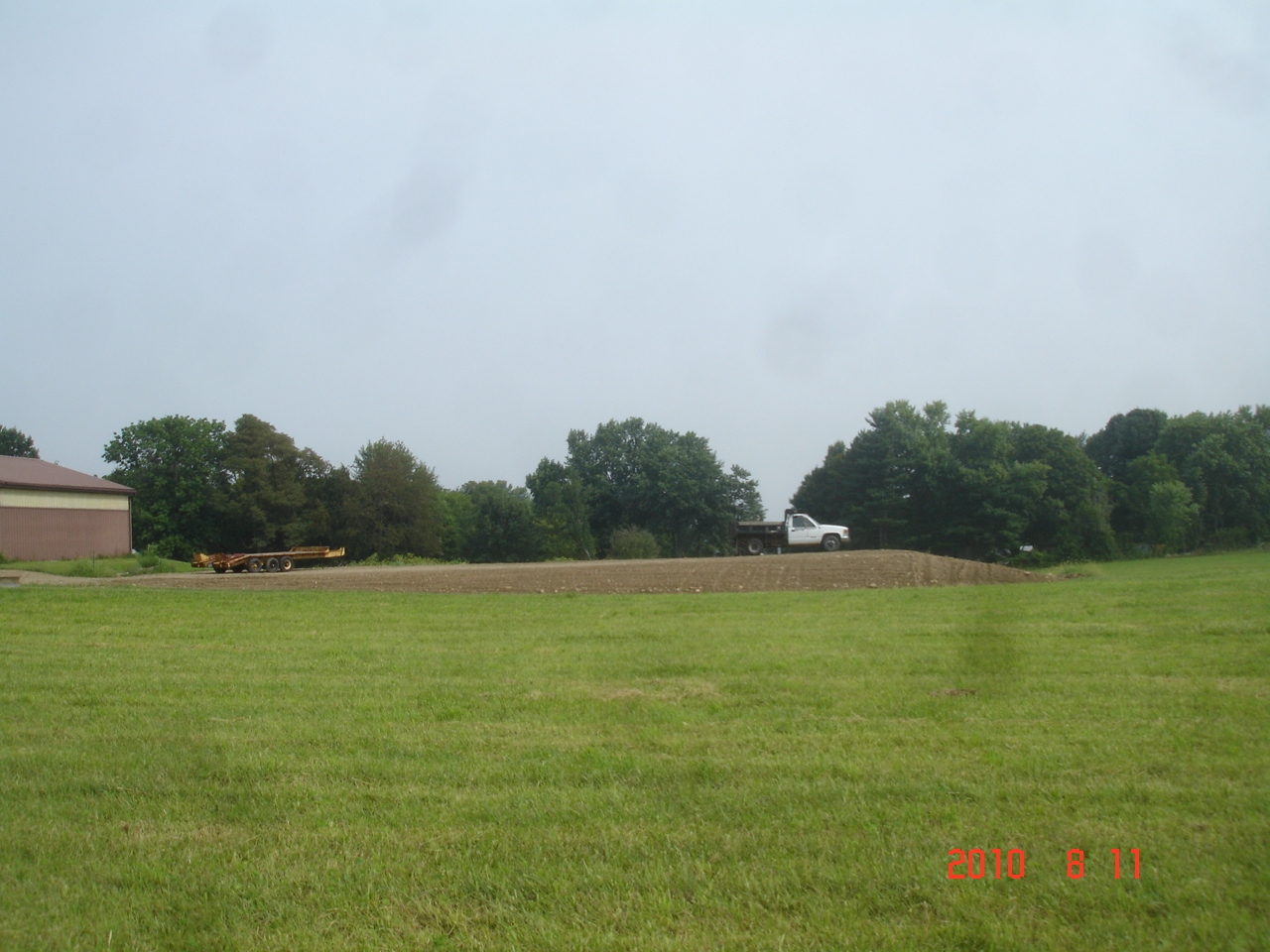

Here is a pad I built last year for my new horsebarn. Approx. 70' wide, and 120' long. Took approx. 2800 tons of 80% bankrun/20% clay mix to build it. Hauled it all on the little 1 ton Chevy Dump truck setting there in the picture.
I put it down in 6" to 8" lifts, grading it off with my little Farmall A, and home made blade, circa 1964. And rolled 3 times over with the ole' 180 Massey, with the carry-all on back, with all the bankrun on it that would stick. Enough weight on there, I had just enough weight on the front end to steer. It compacted well enough, that when I backed across the pad, to make another lift, I just left tire tracks on the previous lift, and did not sink in anywhere.
Last year, we managed to get 1 rain every 7 to 10 days, which helped a bunch. I'd wait 2 days for it to dry some, and start again.
It took me 61 days to haul, grade and compact over 3,000 tons of fill for my barn, and new shop. 735 loads, to get it to rough grade.
If I can do that, with what I have. Your 166 tons should be a piece of cake, with what you have..
Yesterday I tried to drive a 5" post into some of that fill at the front of the barn. 10 licks with the driver, and the post was literally bouncing back. I thought there may be a large rock under it, but no..., just that hard..!!
I've done so much, with so little, for so long... It's just a way of life..!!

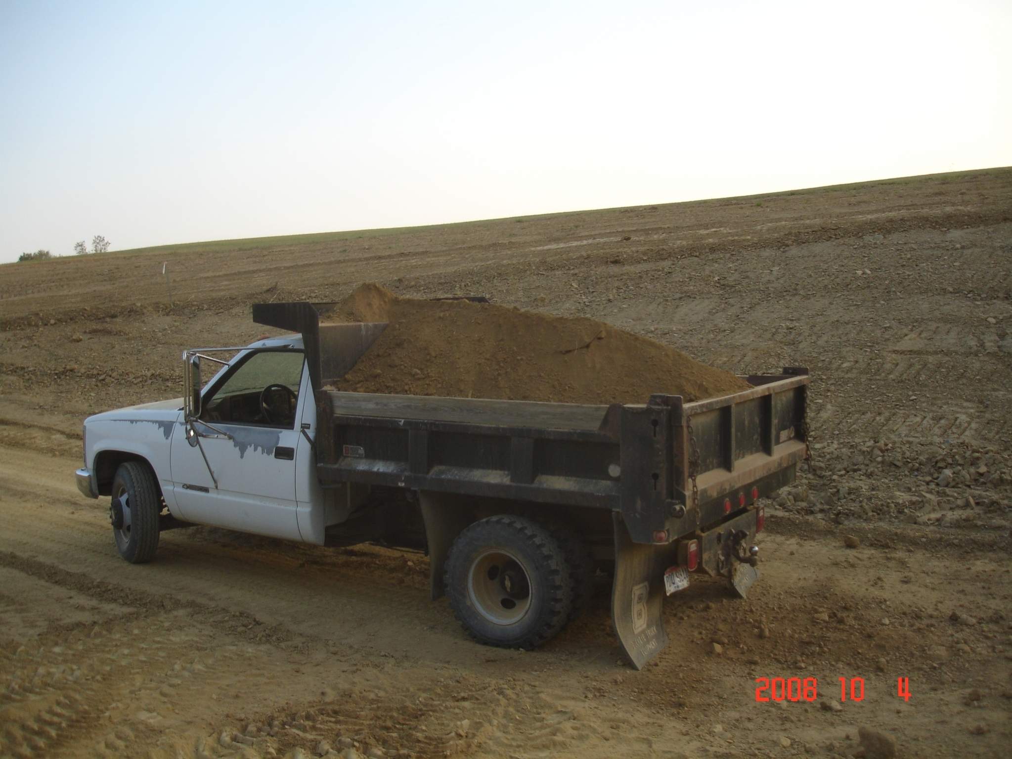

Here is picture from a previous project, and it doesn't get better than this one for me. My young Filly went through the ice on my pond in Feb. 2008, and luckily survived the ordeal. I decided to fill it in somehow. My neighbor next door started digging a new,approx. 3 acre pond. He told me I could have all I wanted, if I hauled it. Used his new J.D. 410 hoe to load it, and he provided the fuel. He just wanted rid of the dirt, which was shaley clay.
7 tenth's of a mile round trip, and was turning 5 loads an hour, loading myself... Ended up hauling 400 loads out of there all together...
I have hauled more for the barn pad, for getting a better slope on the backside, and base for a driveway out in front. Up to right at 3500 tons total for the barn job. So roughly 5100 tons, all hauled on that ton truck, and graded with that little Farmall A.
