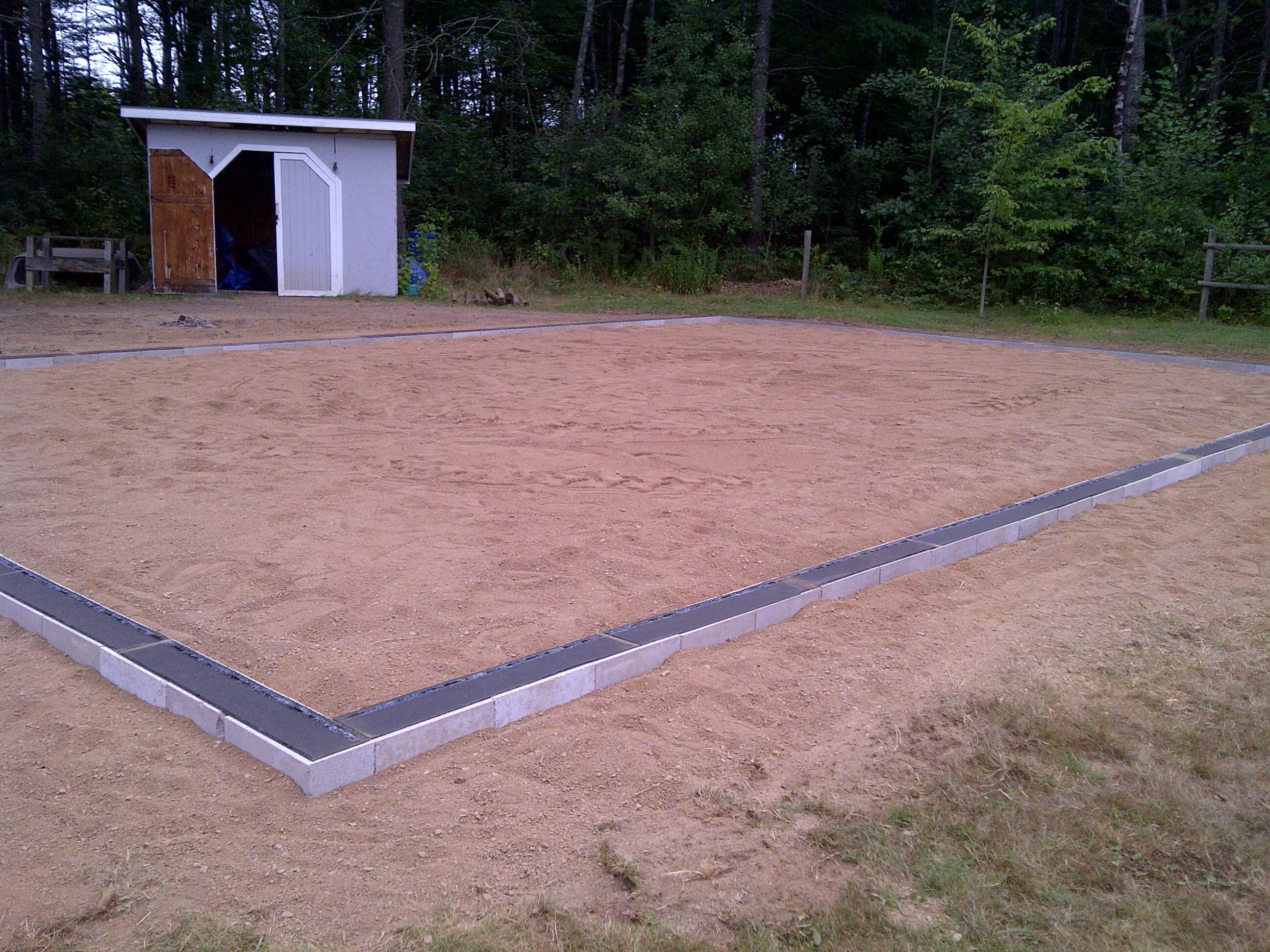

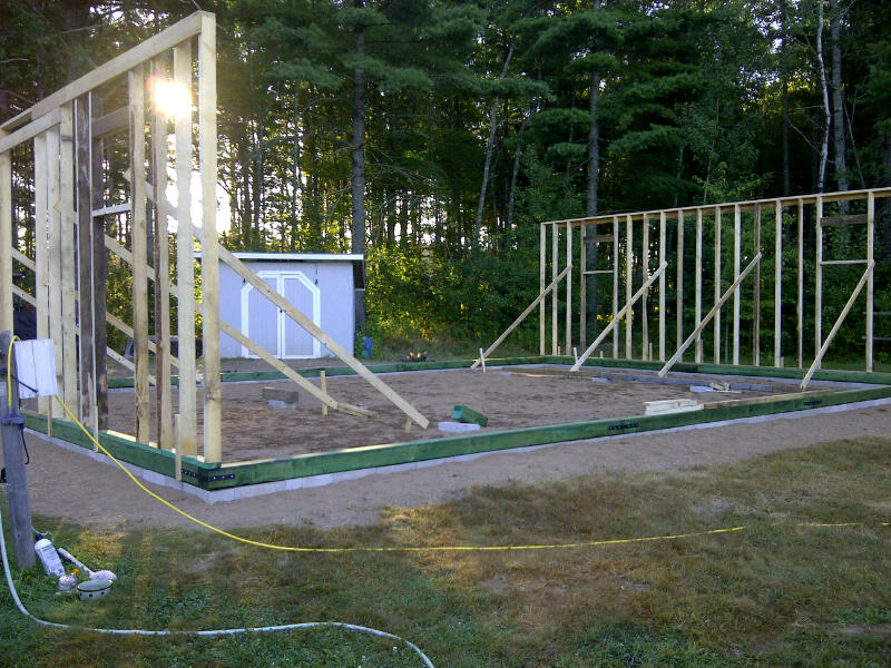

Just built a 26X42 barn. Compacted dirt, laid concrete block, starter course of shingles on top of that and then 6X6 pressure treated as my sill, framed up from that. Just had over 100km/hr winds and driving rain last week, no anchors and building stood it no issues at all. A lot of wieght in a stick framed building.
As has been said in other threads, most older barns were built in a similar fashion, sometimes on rock walls.
<img src="http://www.tractorbynet.com/forums/attachment.php?attachmentid=348174"/> <img src="http://www.tractorbynet.com/forums/attachment.php?attachmentid=348175"/>
The OP stated it is going to be a pole barn. Not a stick built structure. Like comparing apples and oranges.
