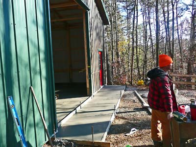

I'd say that 2x4 for top plates on posts 10' apart is definitely inadequate. Personally I'd use 2 2x8 at a minimum. Those top plates will be bearing the weight of any trusses not directly over the posts as well as the additional weight of bracing and roofing. I'd also agree that you wouldn't regret going 12' high on the side walls; consider an overhang of 12" to help keep water away from the sidewalls and provide a little shade in hot GA Summers. When I built I used the bottom stringers as my form for the concrete floor and definitely above surrounding grade to keep any water from entering the barn. Poured an approach at the door entrance leaving a lip behind the door to reduce blown rain while still not having to drive over a thick slab edge.

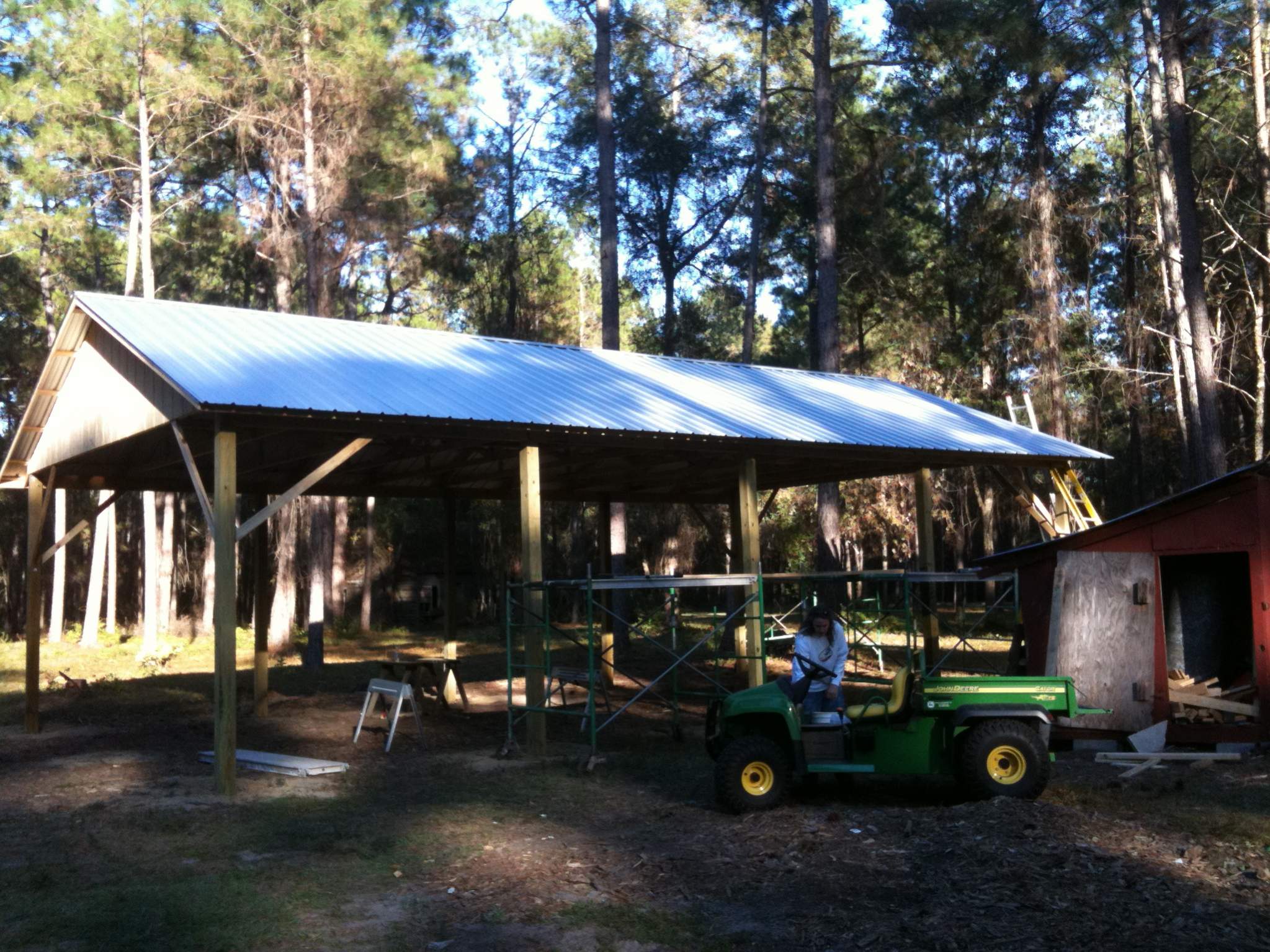

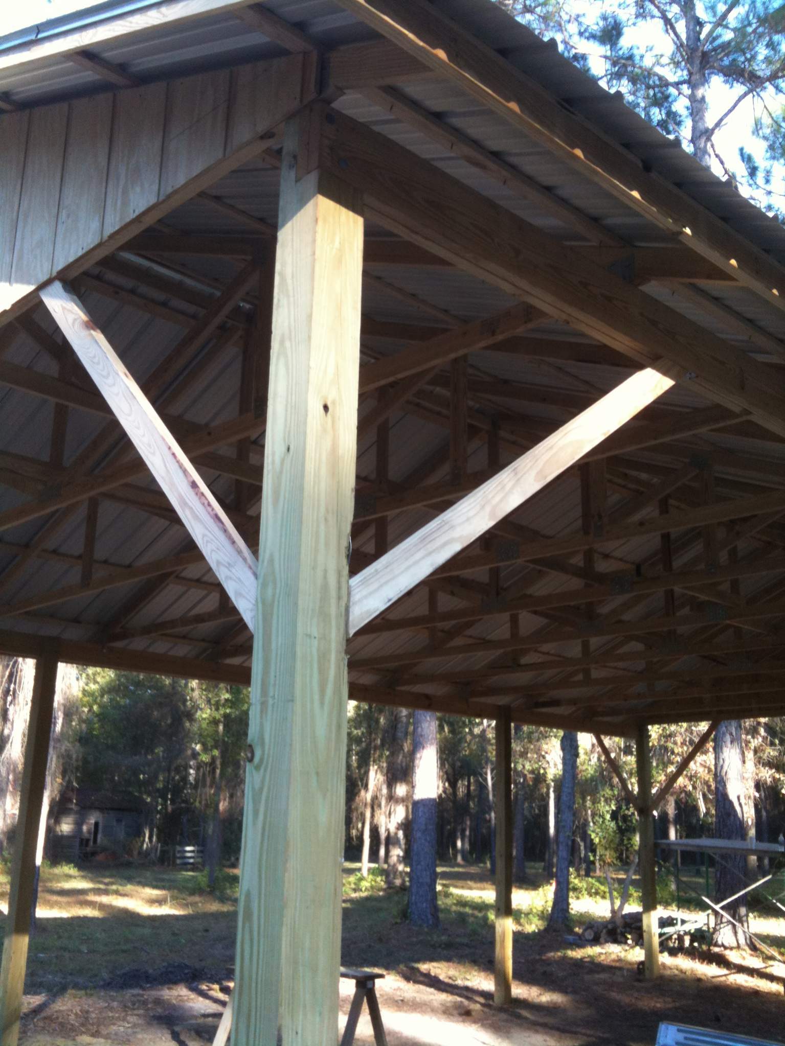

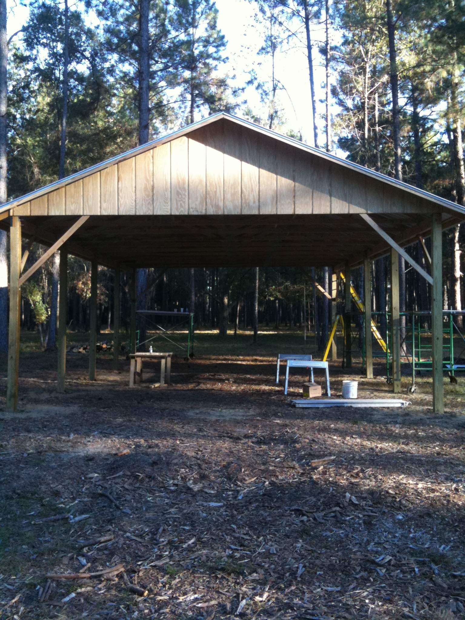

Thanks for the feedback. Pole barn basically done. Followed advice and upped the top plate to 2 2x8s. Notched poles and set top plate in notch. Went up well.
