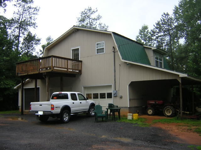

This isn't really a pole barn since it is standard stick framing on top of 2' cinder block walls. Center garage area on bottom is 30'x30' and one bedroom living apartment on top is 24'x30'. The side sheds add an additional 12'x30' feet of storage to each side. We did all of it ourselves except for the concrete slab and the drywall upstairs. What little we borrowed used the property for collateral so there were no mortgage hassles. I plan on starting the main house within the next year. That shouldn't be too bad since we will already be living in the backyard.
Jeff
