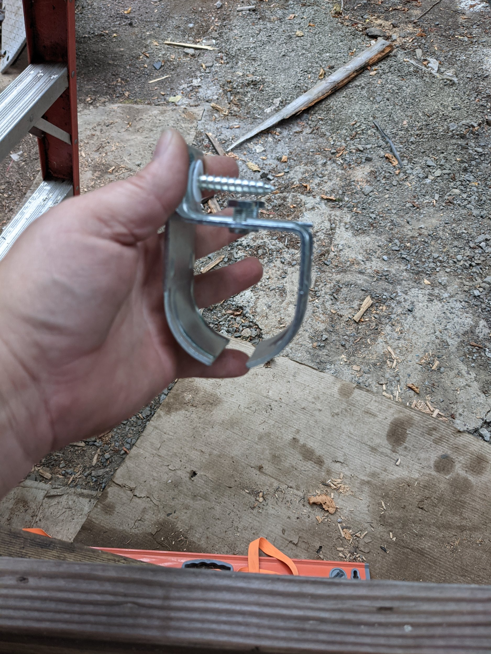

found this connection at the local farm store.

That splice looks like what I used. The round track is from National Hardware, sold thru TSC. I had to "adjust" the splice to get it to fit on the ends of the tracks. A crowbar, a huge vise, and a big hammer helped in the "adjustments". I had to do some grinding to make the ends a little better transition between the tracks also.

That splice slid into the end no problem. It has two screws on the top that clamp each side of the rail into it. Worked great. I should have got a picture of it installed.
