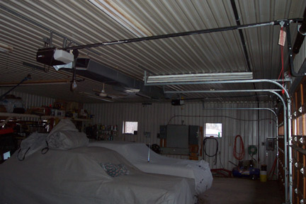

The interior walls and ceiling of my 30' x 40' garage (pole barn) are clad in metal siding. This was done by the previous owner. The trusses are 6'c/c and this doesn't appear to present a problem. /forums/images/graemlins/smile.gif
