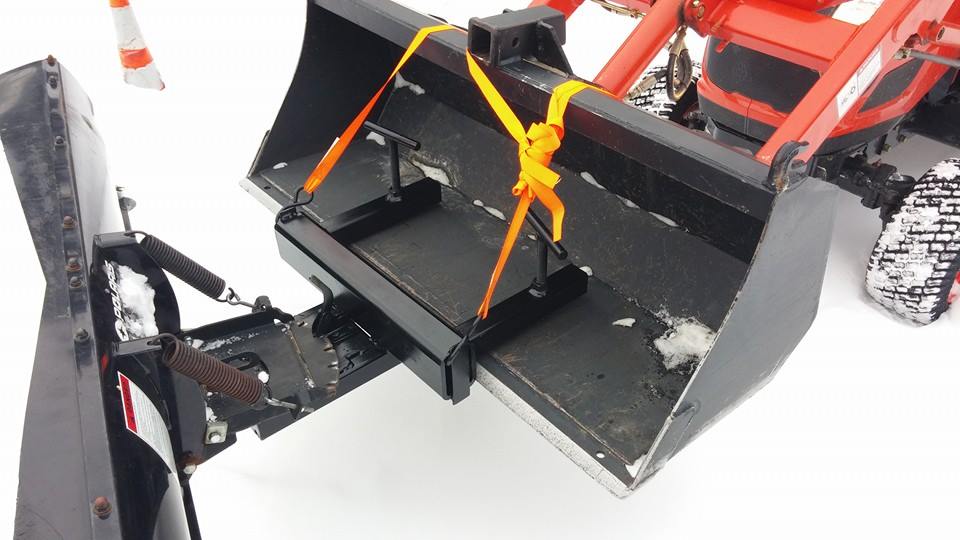

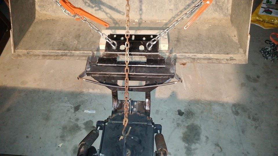

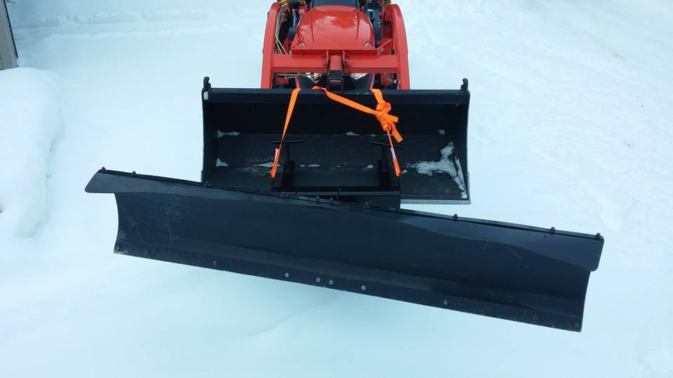

Last year I cleared snow with jut my 48" bucket. Yeah, it took a while
This year I bought a 6' Polaris UTV Snow plow and rigged it up to my bucket. I also used my Everything Attachments 48" box blade as counter weight and a rear pusher plow too. The plow worked great. I cut my plowing time down from hours to 30 minutes...
...the mount - not so much.

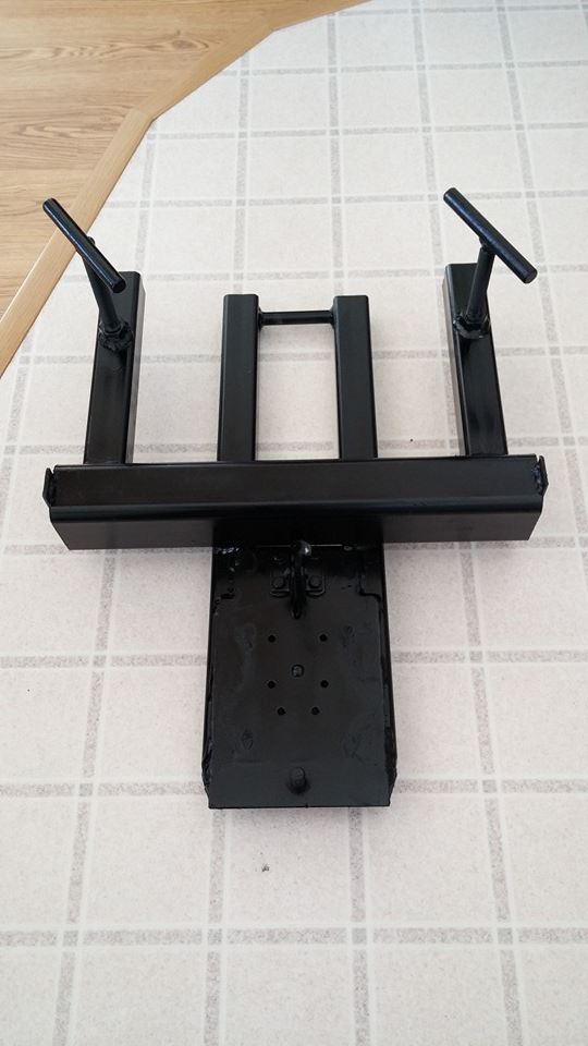

I ended up bending the mount twice. The second time I ditched it and welded up a new one. Just came in from plowing again and it works awesome.
By the way, the new mount weight about twice what the entire mount and plow weighed before.
Last picture is the old mount Notice how small the arms are.

nice work. any visibility issues and does it do well in float?
   / Polaris 6' Snow Plow on a 24hp Sub Compact
Normal visibility issues with having any attachment on the front. Working at night, the lights cast a big shadow in front. Lights up on the ROPS is the only solution to that.
As for floating. I simply put the bucket in float mode and it works fine.
