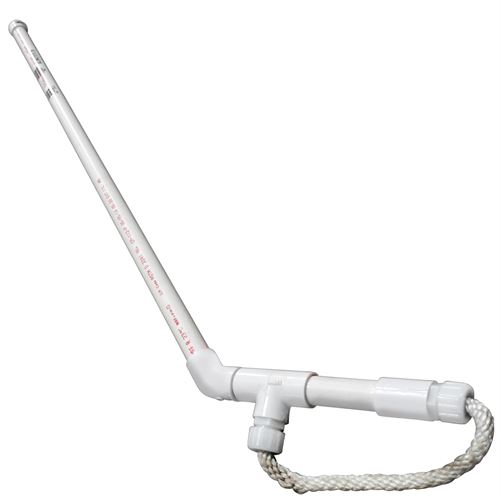

I don't know of such a herbicide, but you could use a wick applicator to apply the herbicide of your choice to the poison ivy and avoid contacting other plants.
Steve
That's a handy looking gadget thanks for posting it. I've seen the ones that are used in pastures and such but not a hand held. I've a few places this could be used. Thanks for creating more work for me. :)
