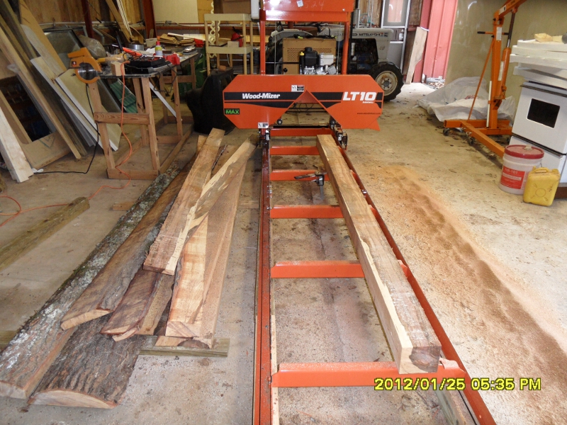

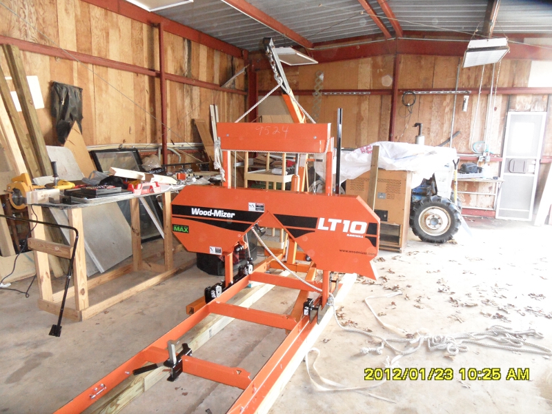

My bad, I didn't report back that the glow plugs worked after about 35 seconds at 30 degrees.
The Satoh (in background) liked to work and I used it in January to get the first logs for my new Woodmizer LT10 sawmill.
