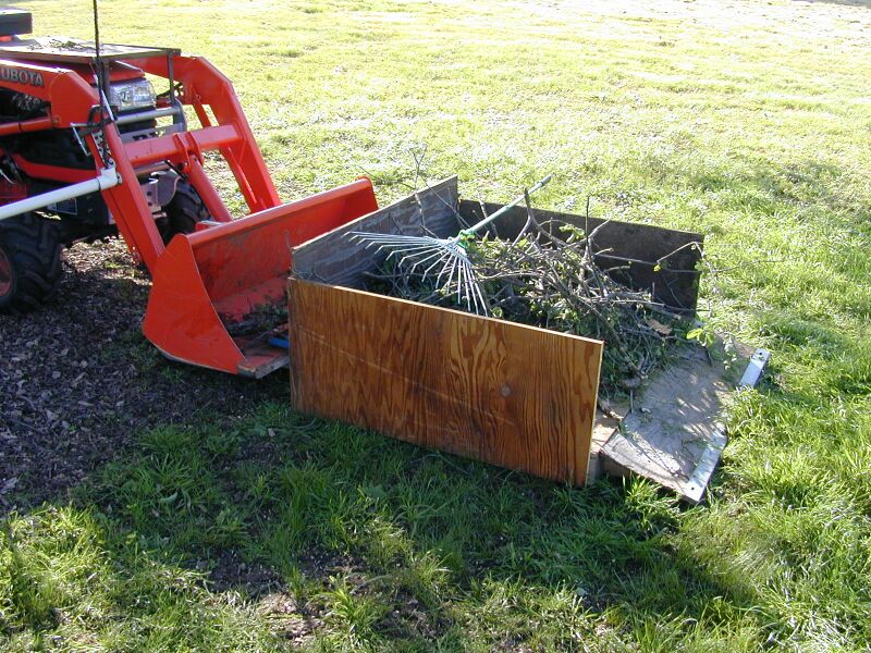

I did exactly as firemanpat said. Works good. With my limited lift capacity, it won't lift much firewood that far out front ... but it wasn't designed for it either. Note, I added a front lip to make loading it with little stuff easier :)

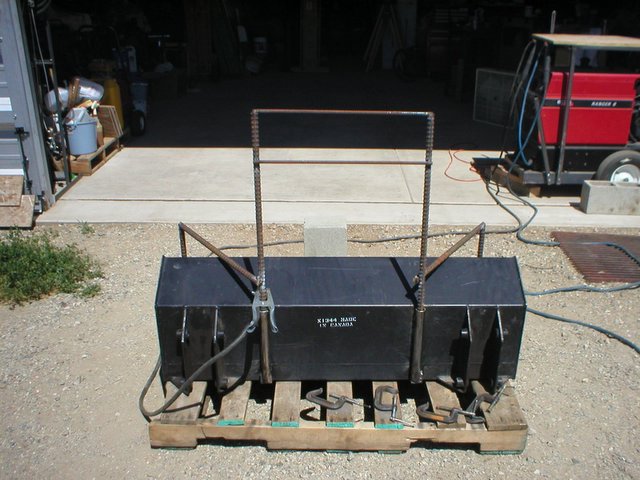

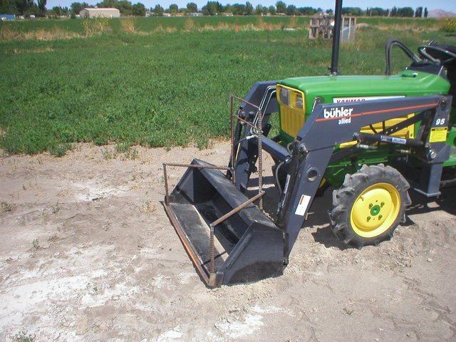

Hi-
I attached some photos of a *very* simple and quick stand I made to sit on my FEL. It allows me to carry things without smashing hydraulic hoses. It just sits on the bucket and two legs on the back rest in some pipe. Much quicker for me for many items than attaching forks (don’t have a quick attach). Comes on and off in a heartbeat, and was made with three quarter rebar.
I’m sure you could add a big plywood box easily and make it so your box could be dumped without the whole rig coming off.

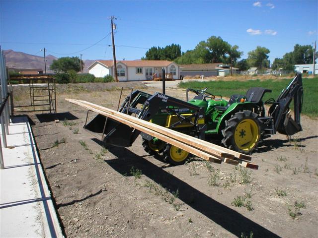

   / Plywood cary-all for the FEL??? #8
Finally found a pic of mine
