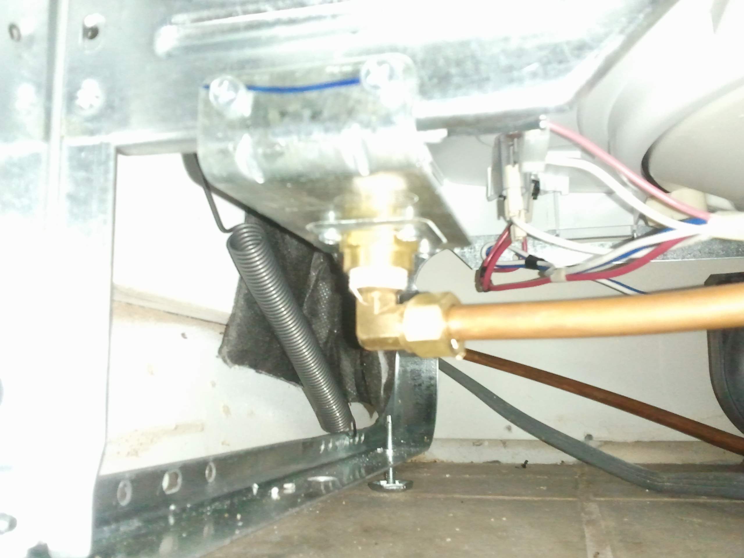

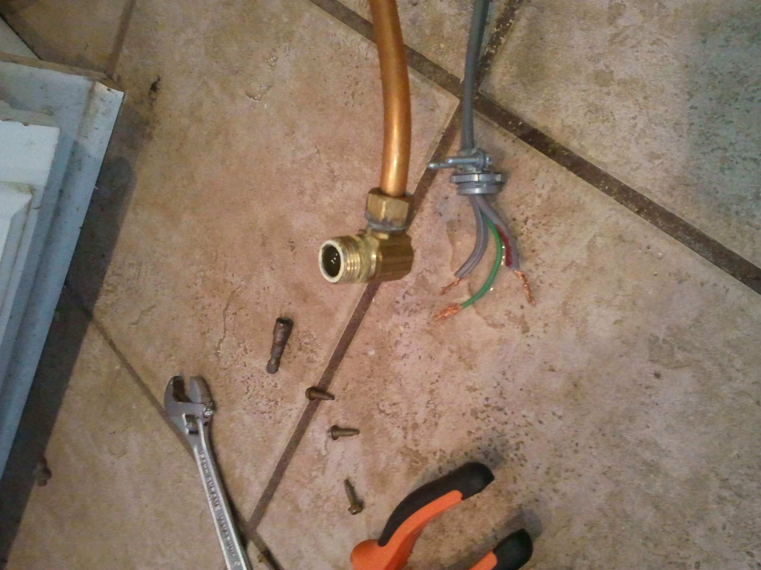

I know this is not a plumbing website, but so far there has not been much I can think of that hasn't been discussed and usually resolved. I recently had a several year old dishwasher go out. I bought a new one and began to change it out. Attached are a couple of pictures to help explain the question. The copper water supply line had what appeared to be a fitting that was soldered on. This wouldn't work with making the water supply connection to the new unit. I have little to no plumbing background so I went to parts house to see what was available. The second picture is what was recommended. I put this fitting on after first cutting the old one out of the copper line. I got everything put back together and unit works great. I noticed that I now have a very small leak at the new fitting. You can see the water at the edge of the nut and copper line. This is not a bad leak, but is leaking some.
The question is, what are the options for correcting the leak? Do I need to replace the fitting and try again? Is there something I can put on the connection to seal it off? Pretty tight quarters working on it under the unit. My concern is if the new fitting leaks what are the chances a second would solve the problem. Any advice and suggestions would be appreciated.

One thing to consider is removing the tube from the connection and sanding the end of the tubing to make sure you have all of the burrs removed for proper seating. About any grit paper handy should do the trick, if that is the problem.
Also, Sharkbite or Gatorbite connectors are an option if that connection fails. Available at the typical Lowes / Home Depot type stores.

Looks like the compression nut may not be tight enough, or overtightened?? Did the new ferrel in the fitting have any nicks scratches?
   / Plumbing Question - Dishwasher Change Out #4
Yep. I'll bet it was not seated properly before tightening, and or not tightened enough. 1/2 a turn of the nut can make the difference.
You can also get a leak with a compression fitting, if you move the tubing around after you tighten the nut.

The first fitting shown is not a solder connector. It is compression. I suspect that what looks like solder is just discoloration from a slow leak.
I agree that a flexible, preferably stainless braided, line is better.
In most installations, there is no need to cut the existing copper line. Just follow it back to the shut off valve and replace the whole thing with a flex line labeled for compression to compression fittings. The flex line compression fitting is a whole different beast than the copper one and it uses either an o-ring or a rubber "cone" , depending on design and who makes it. But, it fits on tyhe existing male part of the fitting and is pretty good against leaking.

Your leak could be from several issues. Not tight enough, rough ends on the tubing, tubing not round, compression fitting not installed correctly ( not slid far enough on tubing),just to name a few
