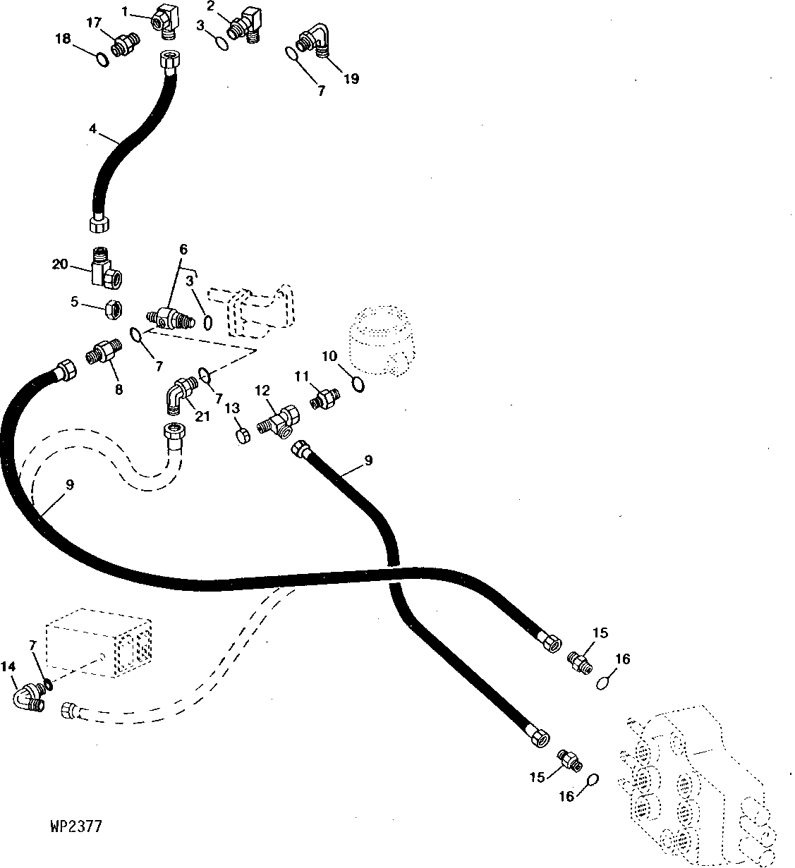

I have a 46 or 146 loader (mine has the two dump cylinders) on a Deere 4010 diesel. It is currently driven by the rear hydraulic outlets but I've purchased the parts to plumb it in.
With the parts, one of the hydraulic lines goes into the replacement hydraulic filter cover but I don't see where the other line would tap into the system. Anyone have one of these or seen one that can point me in the right direction?

www.ytmag.com has a JD forum that has lots of info on this. From what I recall you T into one of the pressure lines to feed the loader control valves, then run the return back into the top of the filter housing as you mentioned.

dsb,
Here is a picture from JD's online parts listings. I do not know if this will help. You will want to hook up to the pressure control valve. This is most likely where your remotes are tied to. You can hook both up at this point. The valves will be in parallel since you should have closed center hydraulics. Let me know if you need a better picture.
Russ
