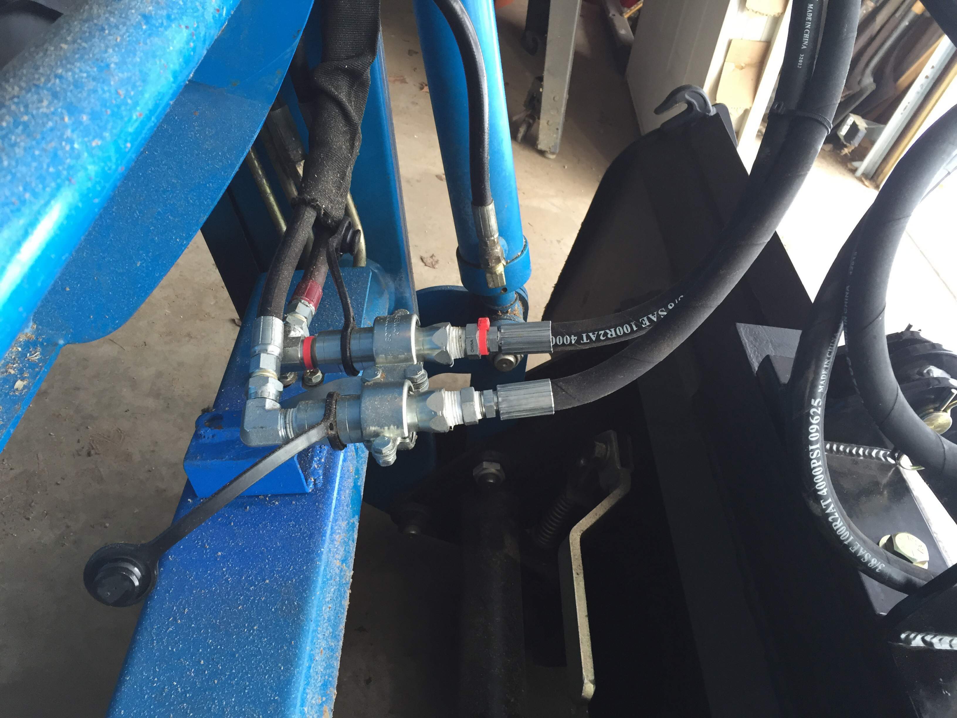

I run 1/2" hoses only because I also run a hydraulic auger off of the FEL. If just a grapple, smaller is fine. Often the grapples you buy have the little hoses on them anyway.
/ Plumbing for a grapple #42
I put together a parts list for my plumbing job and took it to the local hydraulics shop. $300
I'm pretty sure I can do better through one of the online sponsors here at TBN.
Pat,
I bought all my hoses and fittings at TSC and was about $200.
I used 1/2" hoses and both type fittings are usually in stock.
When I get home I'll post the parts list I used.
#43

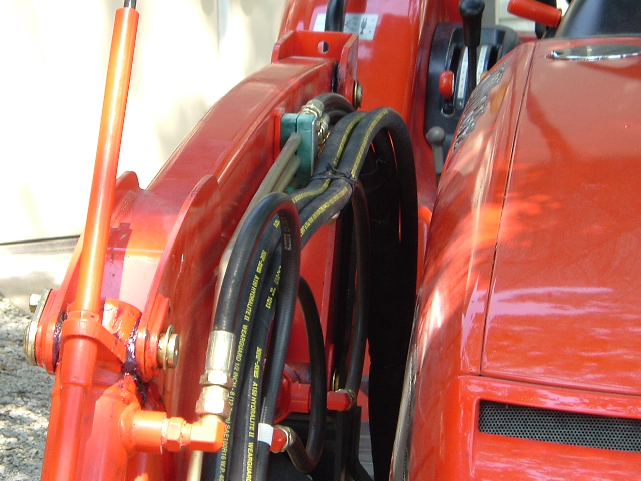

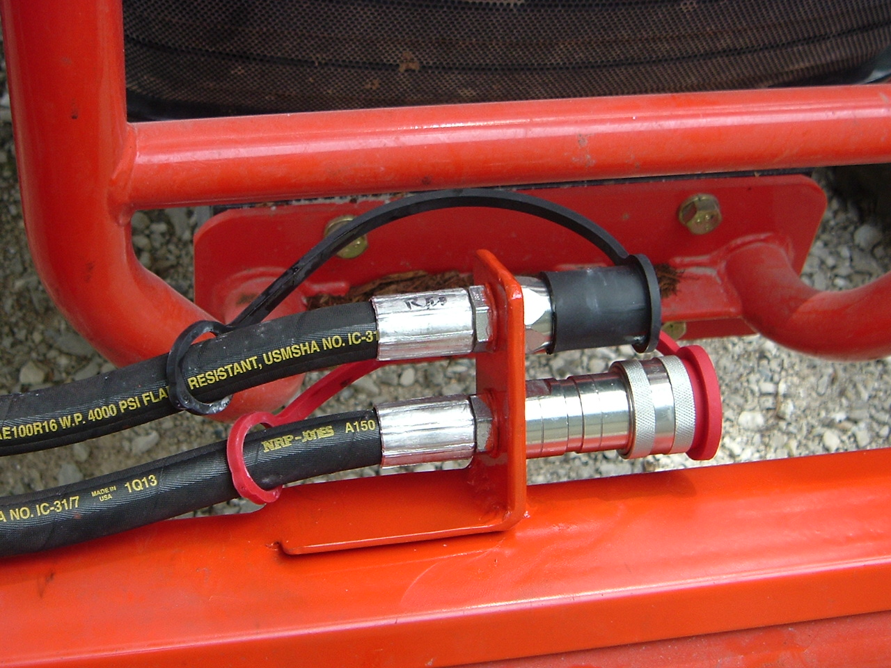

My list is/was
2 120" 3/8 hydro hose
2 60" 3/8 hydro hose (all 4 hoses with nptf ends)
2 sets 1/2" quick couplers
2 sets 3/8" quick couplers
4 90 degree elbows (3/8" female, 1/2" male)
caps for all coupler ends
I ordered from 2 different dealer sponsors here and it came to just under $200 shipped.
I went to TSC and they didn't carry 120" 3/8 hose assemblies or have all the couplers and fittings at that store.
I did like their clamps, though.

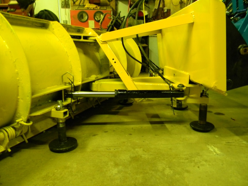

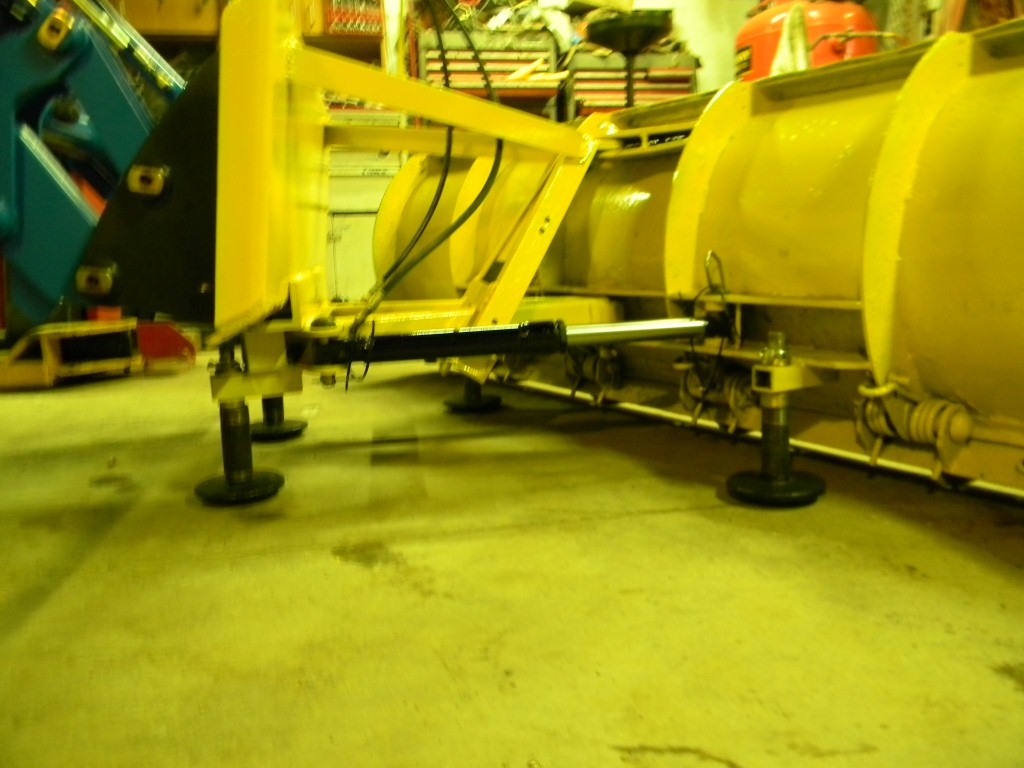

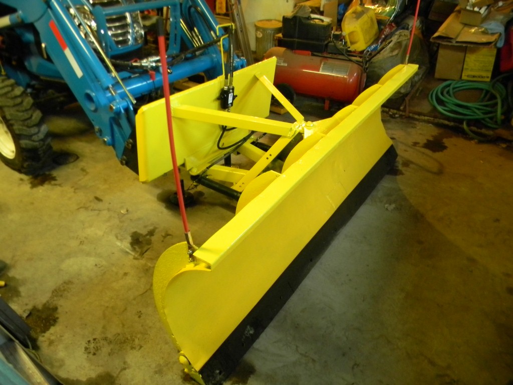

As James mentioned, yes using 2 single acting cylinders will work fine. One double acting cyl. will work also. I originally had a DA cyl. on my plow but decided to use that cyl. for something on the 3 pt. and bought 2 SA cyls. I hooked mine to the remote that has the center detent. I also installed a crossover relief. Plow frame is welded to a 1/2" QA plate like you have.

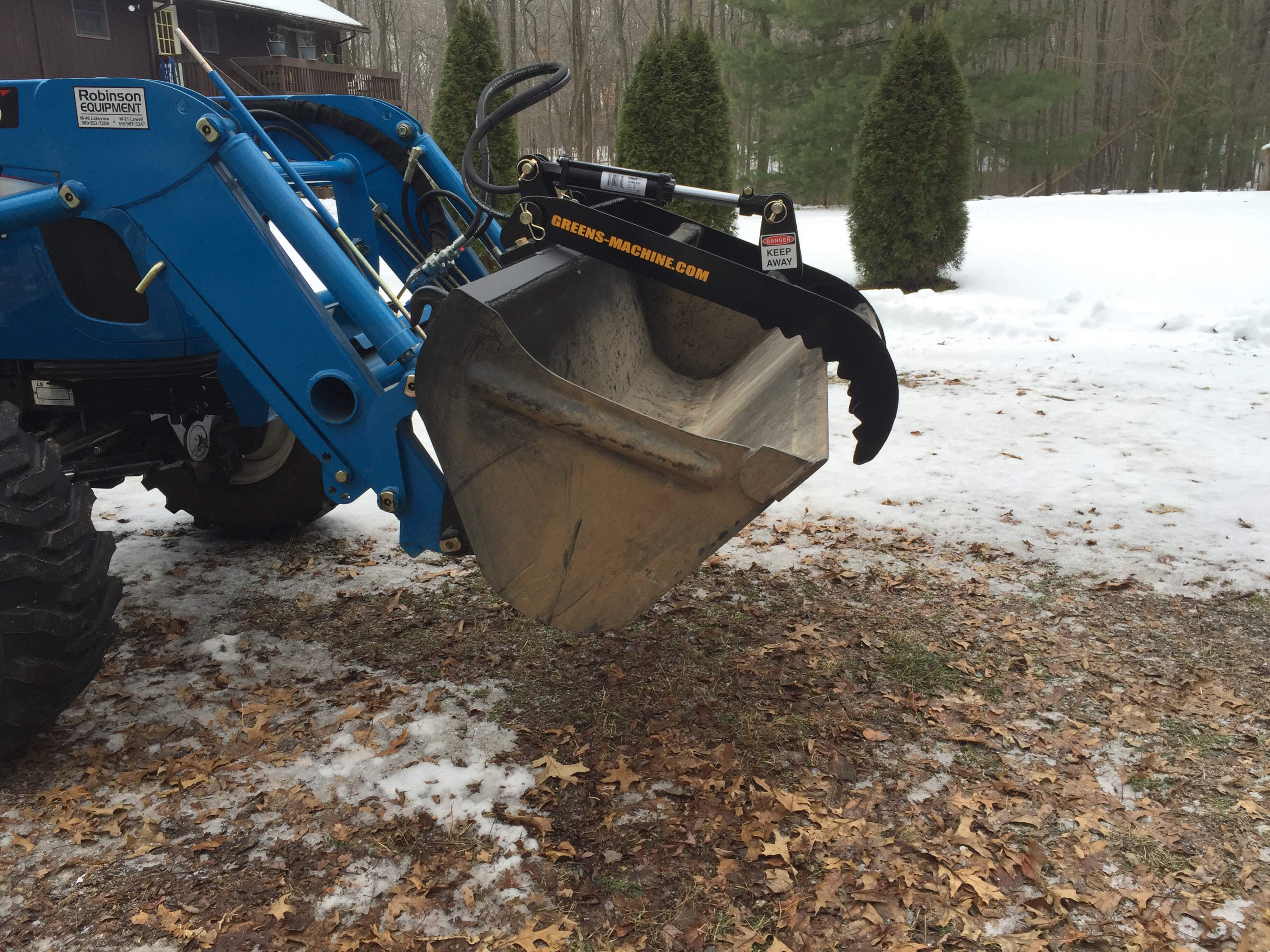

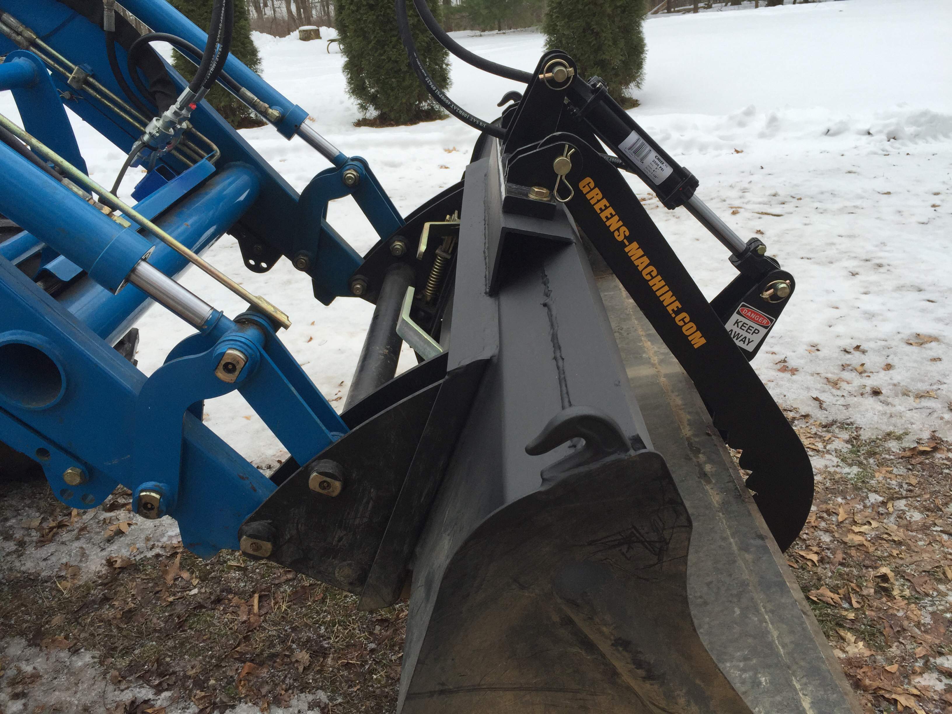

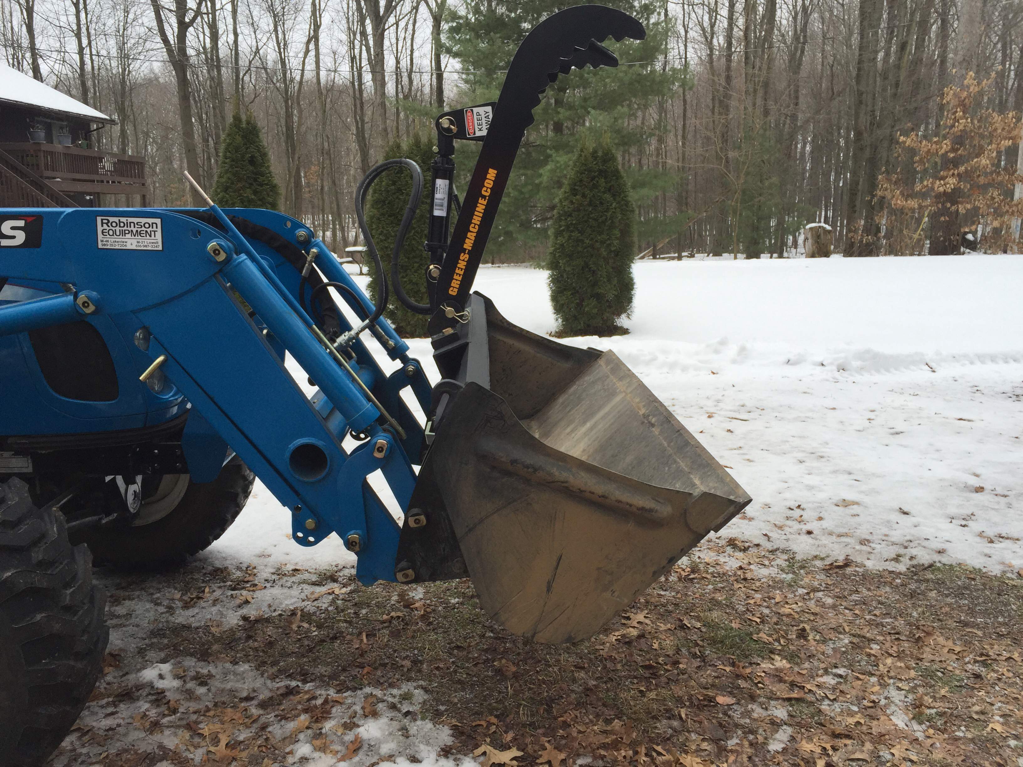

When you get your grapple, please post a picture of it or does the person building it for you have a website to see what they look like? What size are you getting? Can you share some of the info on it. I'm looking to get one in the future. Thanks
Tom
/ Plumbing for a grapple #49
PatMcD
Tom
Here is their site.The Thumb

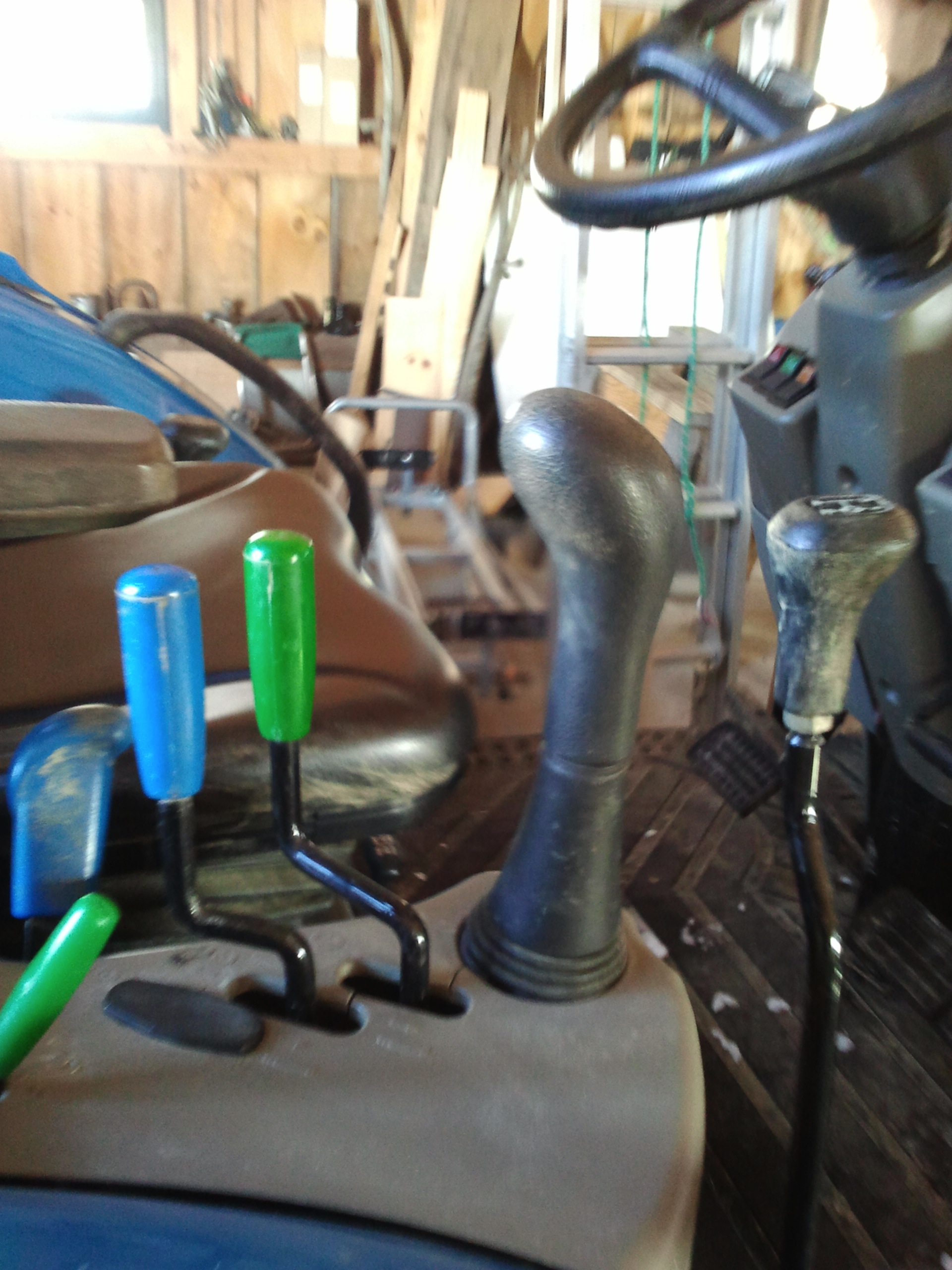

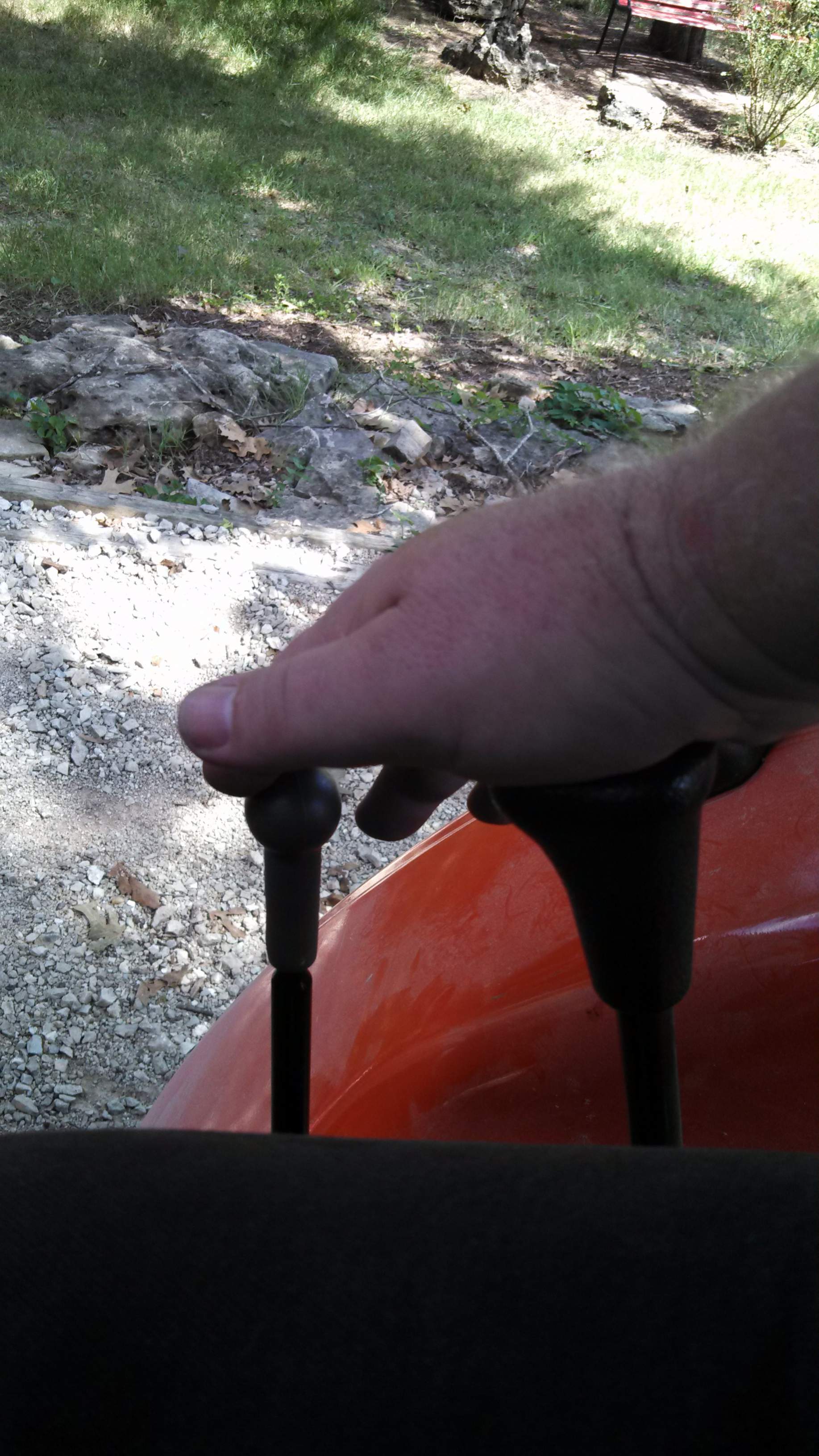

I'm kind of lucky with this model tractor as the remote levers are very close to the loader joystick:
The Green one will be my control.

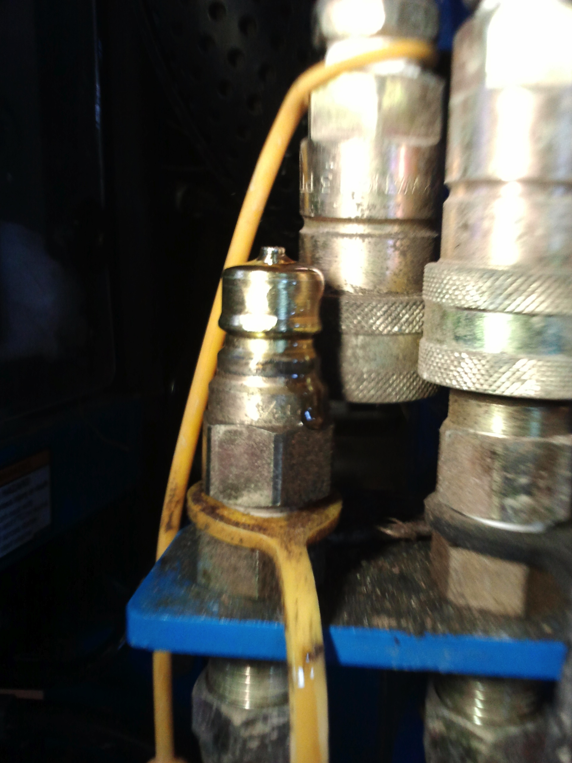

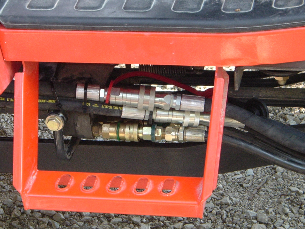

The rear remotes take 1/2" AG fittings, and I think you would be fine with 3/8" hose, works fine for me.
When you use the 1/2" AG at the rear remotes and use lets say 3/8" hose do you have to use a reducer on the NPT threads or can you get couplers that will plug in to the remotes and accept the 3/8" hose?
Also which is the better set of rear remotes to use (blue or green) or does it matter? Does the green have the detent in the center? Sorry for all the questions.
#56
I don't think there is any difference in the blue/green remotes. The green works better because it's closer to the joystick and the location of the remotes is in a cleaner spot.
I just bought 3/8"-1/2" expander fittings to use the different sizes. If they make a 1/2 QC that goes straight to a 3/8" NPT thread, I couldn't find it.
/ Plumbing for a grapple #57
Thanks PatMcD. That's what I was thinking on the reducers.

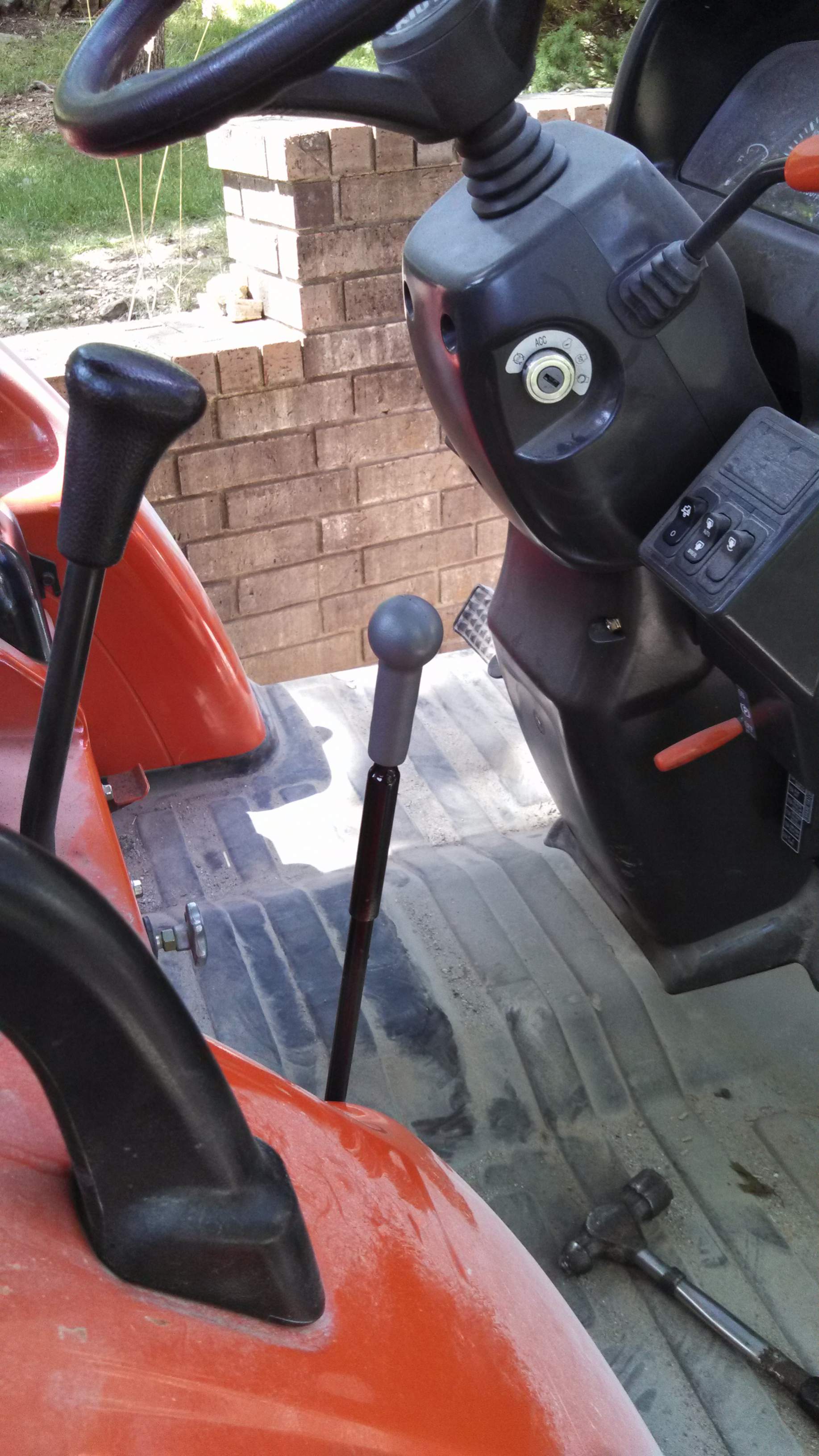

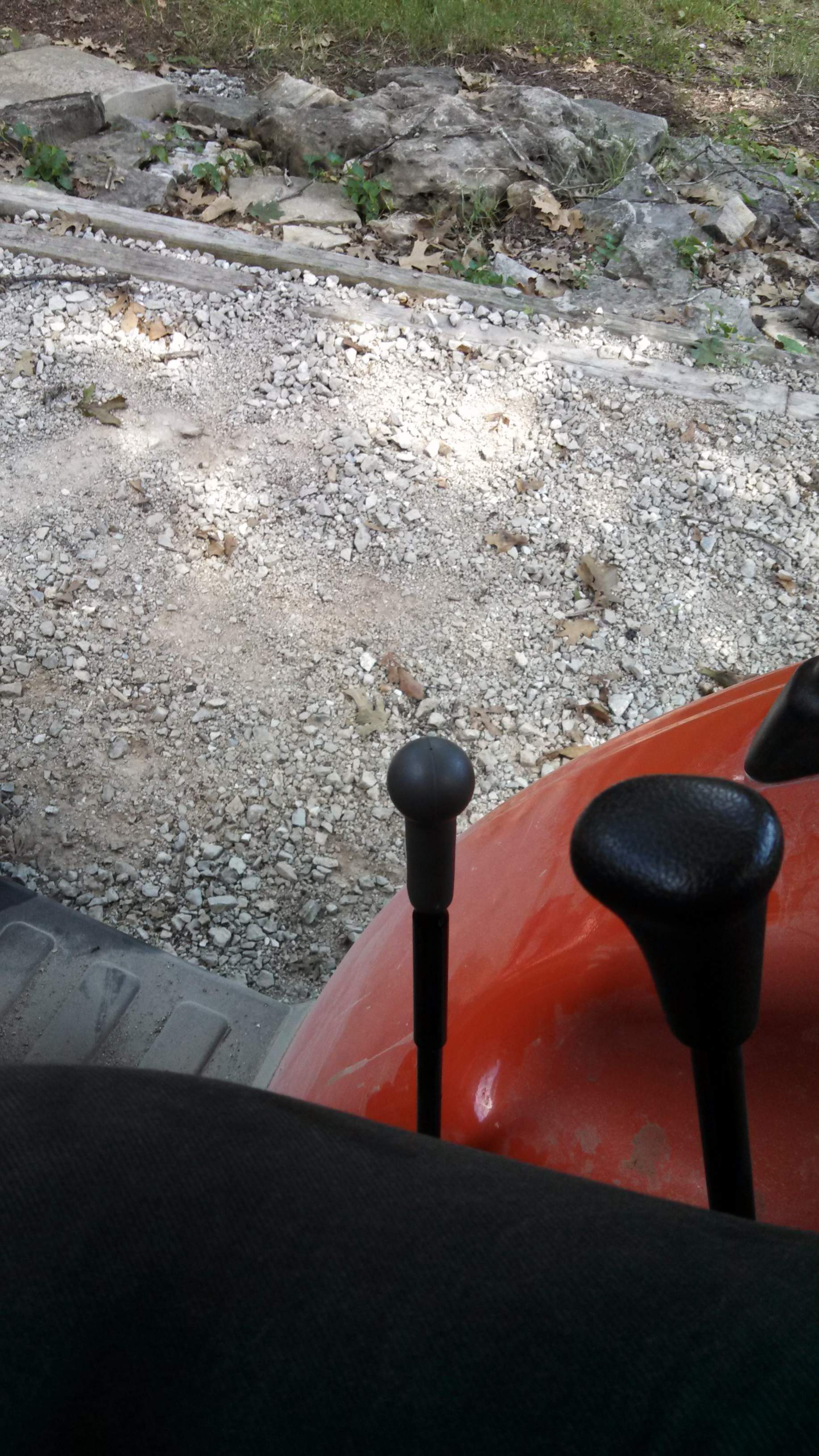

FYI, I think your loader joystick is 'backwards'... rotate it 180° on its threads (not sure how to get to the locknut on yours) and you will be much happier i think.
/ Plumbing for a grapple #59
You know I wondered about the "funny looking joystick" it never occurred to me it was on backwards.
