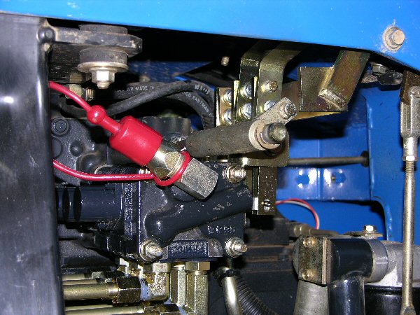

Power Beyond does give you hydraulic power but no control valve to manage. This is the means NH uses to connect a BH into the hydraulic system since the BH has it's own control stack.
Bower beyond doesn't interfere with adding remotes. I installed 3 rear remotes on our 40D and it also has the power beyond.
The red cap in the picture is the power beyond return to tank line. You can see that it's threaded into the end plate on the 3 remote valve stack.

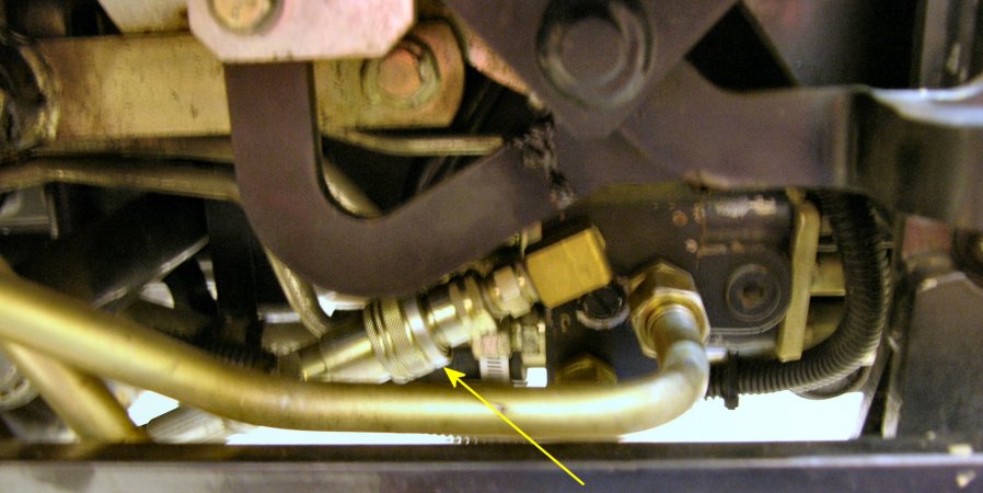

The supply is picked up mid-point on the tractor at the hose from the joystick power beyond port that normally ties into the hydraulic manifold block.
This picture shows the normal configuration.
When you need to connect the BH you disconnect the female QC from the manifold block and plug the supply from the BH up to the then disconnected female QC. Another red cap then gets put on the male end of the QC at the manifold block to keep the connector clean. Understand?
BTW: This connection temporarily disables the 3-point lift mechanism for safety reasons.
