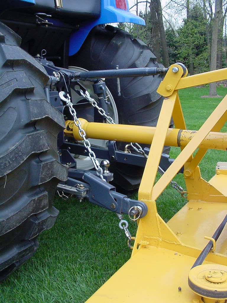

Do the leveling as others suggested, on a flat surface such as your drive, garage or barn. THEN, do a search of TBN for "check chains". They take all the bother about precisely setting (and resetting every time you lift and lower) the deck. Simply drop the lift control all the way down and the chains precisely determine where you want the deck, every time. Here's a picture on my RFM, but my brush hog has the same setup minus the turnbuckles.

   / Plowing with my Bush hog?? #7
... do a search of TBN for "check chains". They take all the bother about precisely setting (and resetting every time you lift and lower) the deck. Simply drop the lift control all the way down and the chains precisely determine where you want the deck, every time.
That's an interesting idea! My lift control is numbered. It's infinite (not notched or stepped or whatever it's called), but I know if I set it at 6, that's the right height. Or if I see it dug a little, 6.5 is needed.
