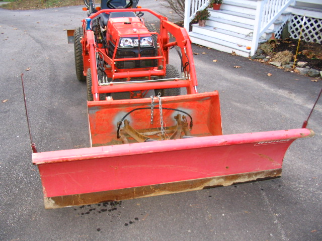

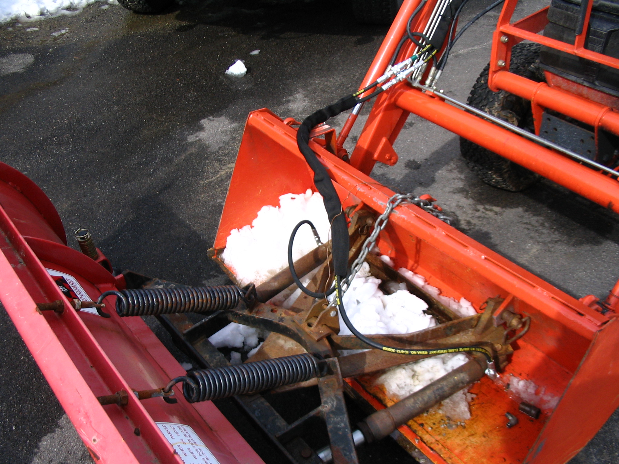

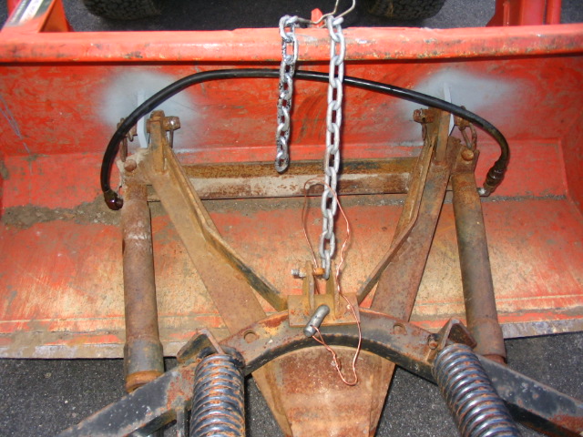

I was waaay to cheap to buy either... For my B series, I bought a 6.5 plow off ebay, $250 and fabbed my own bucket mounts... For the first season it was manual angle, but I added hydraulics the second year..I also cut the blade down 6" to loose some weight
No issue with manuvering... There is a bit more weight on the end which can be good and bad... The added length allowed me to push pile the snow right up... more so than on a shorter mount... Just another option...
Also, This way I could plow w the blade and then quick unmount and use the bucket if needed...
BTW, I now use a 3 pt snowblower.. Its certainly the way to go, Thru that snow way out of your way!

Hello Firefighter,
Your setup gives me yet another option. Nice setup! Nice job mounting the plow, with the mounting tabs inside the bucket, the overall length is shorter. Thanks!
