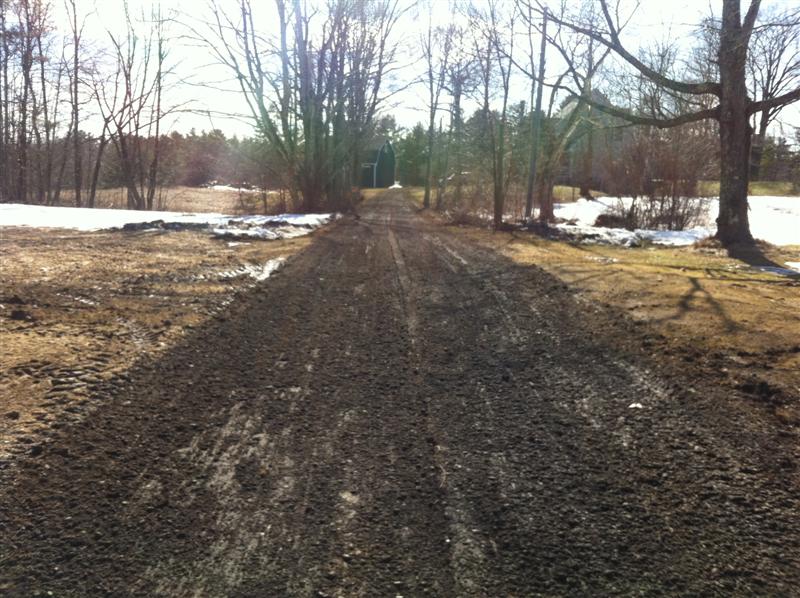

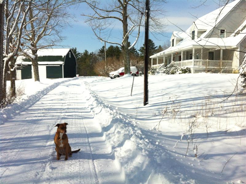

First day of Spring in Maine. I just box-bladed the driveway on Sunday to fill in the ruts and potholes and mix in all the driveway gravel I've power-broomed off the lawn from a heavy plow season. Today is Wednesday, three days later, the first day of Spring. Naturally we got a foot of snow last night, so here's what I did to keep from ripping up the soft gravel.
My tractor has a front plow and rear box blade. I raised the front blade just off the surface by a couple inches or so, to shave off the top layer of snow. On the three point, I full extended the top link so the rear-most blade on the box would compress the bottom layer of snow at an acute "\" angle.
Worked out pretty good me thinks. The box blade didn't fill up and did a great job of packing down the bottom layer of snow. I didn't rip up the gravel at all. Here's some pics.

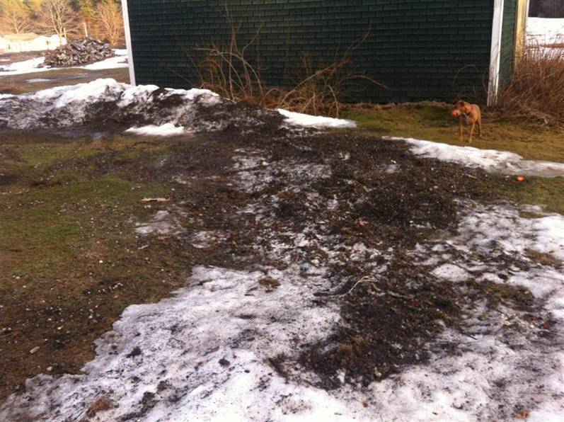

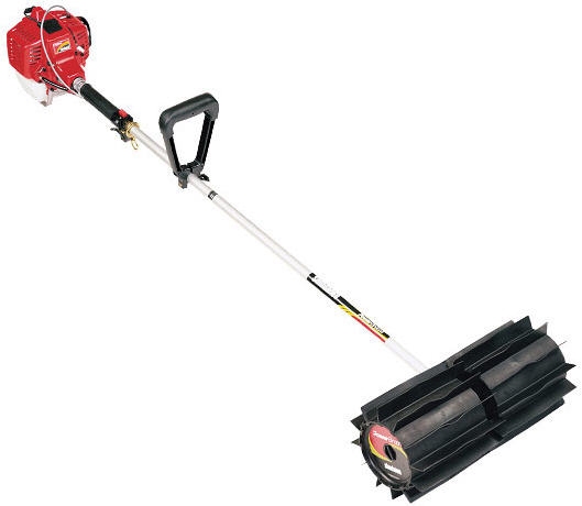

Yep, I've had my plow shoes on all winter and it doesn't help much when the gravel is soft/wet. Note, my problem may have been exacerbated by the fact I spread 60 tons of new gravel on the drive last summer (and the almost 100 inches of snow fall!). In any event, this next picture is of the mess from the melt just before this last storm....oh well, it gave me an excuse to go out and buy a power broom to sweep the displaced gravel back onto the driveway. I highly recommend buying or renting a power broom if you find yourself in the same predicament. :thumbsup:
I agree with that. This'll be my third spring with a broom similar to the one pictured. Takes a pretty good man to run one for any length of time. But still a big time saver. Beats the heck of out the old fashioned way.
