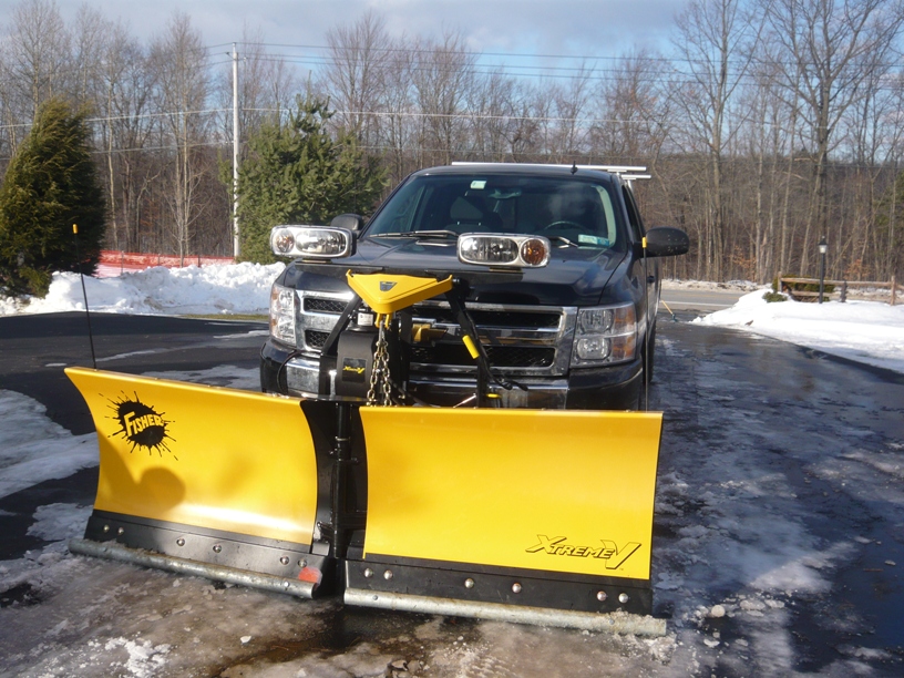

FWIW... I have homemade pipes on my truck plow. I clear a big section of the front yard for the dog and kids to play and the pipes work great for keeping the yard from getting torn up. Went with the slit pipe method because I don't weld (yet!). To mount them I put the pipes in place and then drilled through the pipe and cutting edge - two bolts per pipe.
I'll also add that once you wear a bit of a flat spot in the pipe it will actually scrape a little too but not so aggressively that it tears stuff up. Of course, my drive is blacktop so that helps wear the pipe faster.
