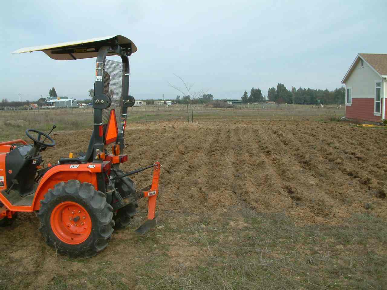

I plowed my lawn area with my 2005 Kubota B7510HST and a middle buster with no damage to the tractor.
A single bottom 12" moldboard plow should work OK with your 7500. My guess is that a properly aligned single bottom plow should pull easier than that middle buster.

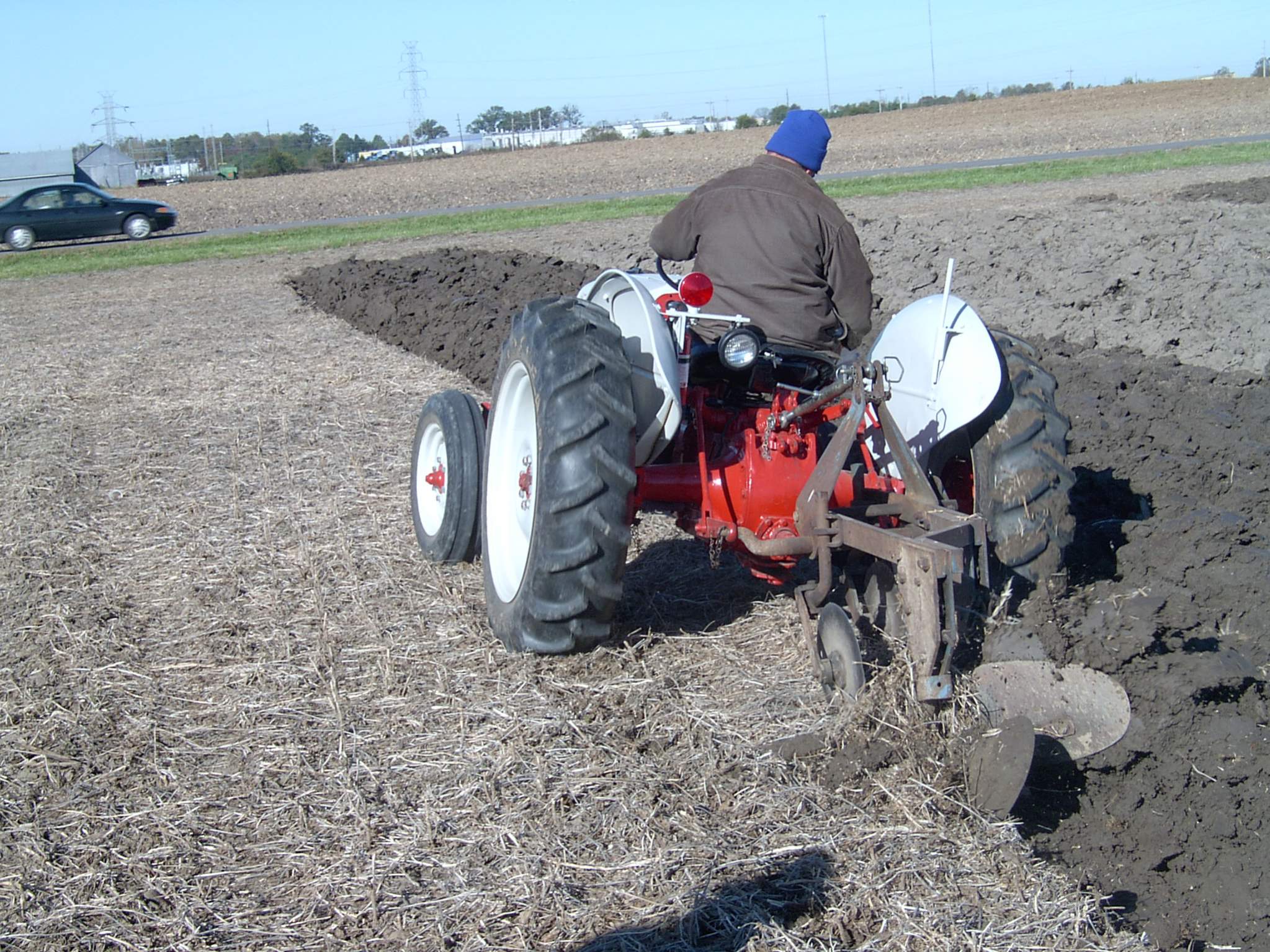

What about a tiller? I pull a Dearborn 2-12" trip plow behind my 3000# 1948 Ford 8N that has 28 flywheel horsepower and 18 drawbar horsepower all day in Indiana clay dirt. Not sure where you got that 20hp a bottom quote. If I need a small garden now, I borrow a buddys 6' tiller to pull behind the L3940, really pulverizes the dirt. Philip.
