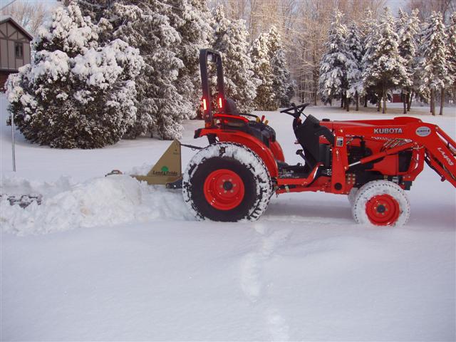

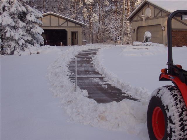

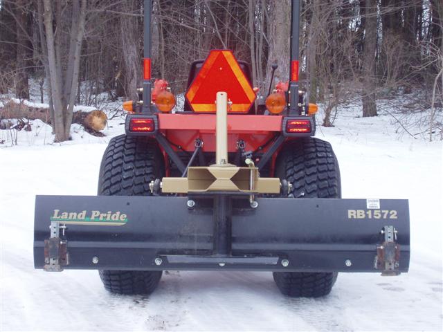

A rear blade with skid shoes will work very well. Driving over fresh snow that is not so deep that the tractor has a hard time is OK. The rear blade will move it just fine. The problem that develops, and it is a problem with any piece of snow removal equipment, is snow that has been driven on several times and then packed into ice. That is very difficult to remove. I try to plow my driveway any time there is even a small amount of snow so that it never gets a chance to turn to ice. Usually in the morning before work and then in the evening if it snowed during the day. Even if it has been driven on a lot during the day the sooner you can get it off the better.
