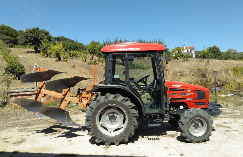

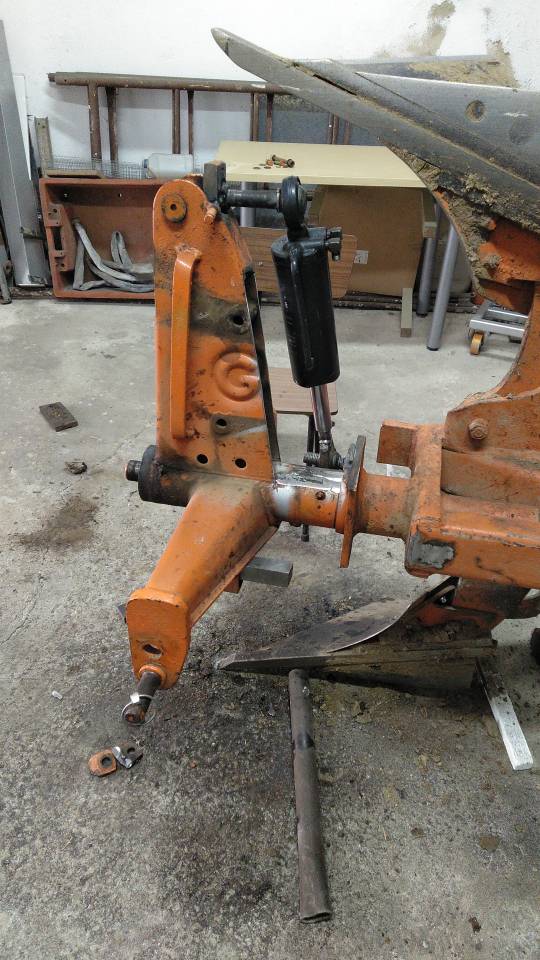

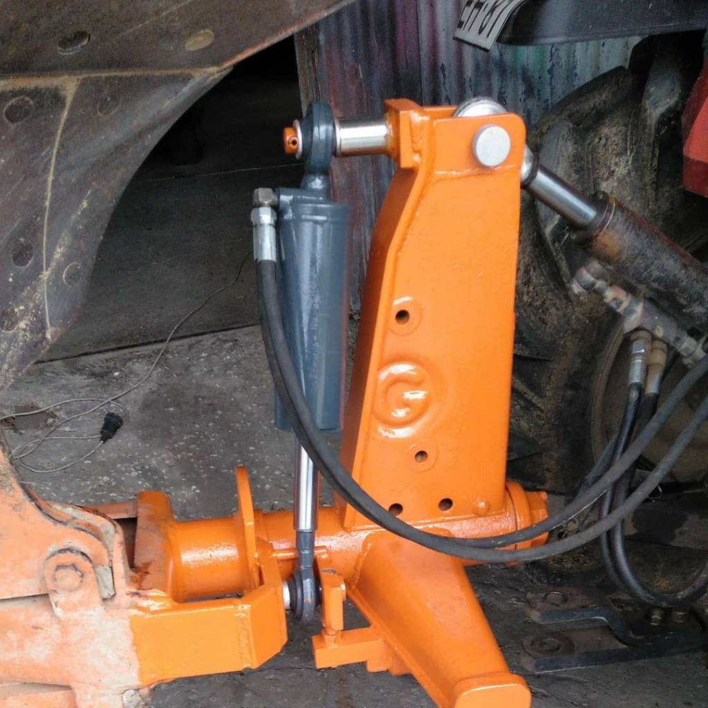

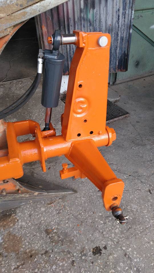

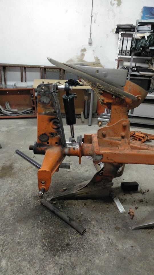

Turn mechanical plow into hydraulic plow.
After a little work, finally the deserved result .Here are some pictures IMG_20191111_094537_553.jpegIMG_20191112_120037_125.jpegIMG_20191113_135850_285.jpegIMG_20191114_172609_126.jpegIMG_20191114_160328_928.jpeg

Nice work iseki!
How many bottoms?
I always hated mechanical trip. If too much dirt got hung up in sticky conditions or you snagged a tree root it wouldn’t trip completely. AND you now have the advantage of placing it “mid trip” (horizontal) to avoid getting stuck in wet conditions.

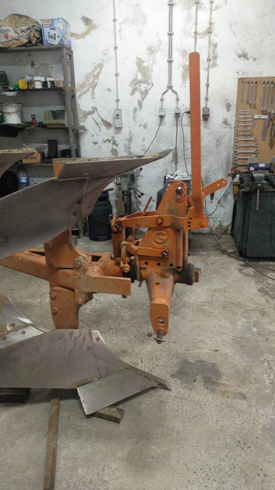

It's plow two furrows, you're right, manual turning really isn't very good, it was a project I wanted to do a long time ago but I finally got the courage to startIMG_20191024_004708_789.jpeg

And now you don’t have to open the rear window to roll the plow over!
