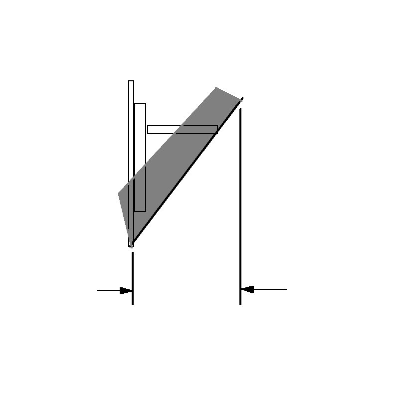

Hi, what it is the proper way to measure plow , for instance two bottom 14" plow. Thanks.

The amount that the plow cuts is the measurement that you need. See attachment.
