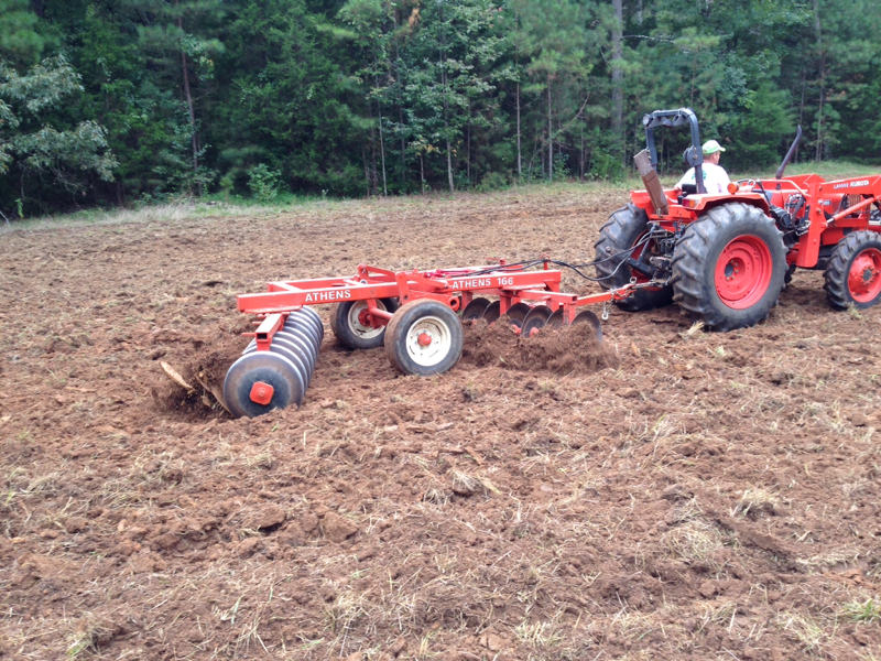

you have plenty of power. The more bottoms , the faster. But after you plow, I think you still will need to disc and drag a harrow of some kind to break up the clods and level it. So expect many passes.
I would use a heavy disc harrow instead. Then it still will need smoothing. And a tiller would certainly work. But I've never used that method. From what I've seen, larger areas are usually disked, with enough passes to break it up, then drug over to level, or even cultipacked
   / Plow buying advice needed #5
I have opened virgin acreage with a plow - 10 acres. Its a multi pass operation - plow, disk, then some type of drag. I would much rather have the option of one pass with a rototiller.

If your only wanting to look for arrowheads get you an offset hare, do that first and do your search then get you a plow and roll it over. Let it rain on it several times etc. and keep looking. That way what ever is near the top will still be near the top and you won't plow it under the first time.
