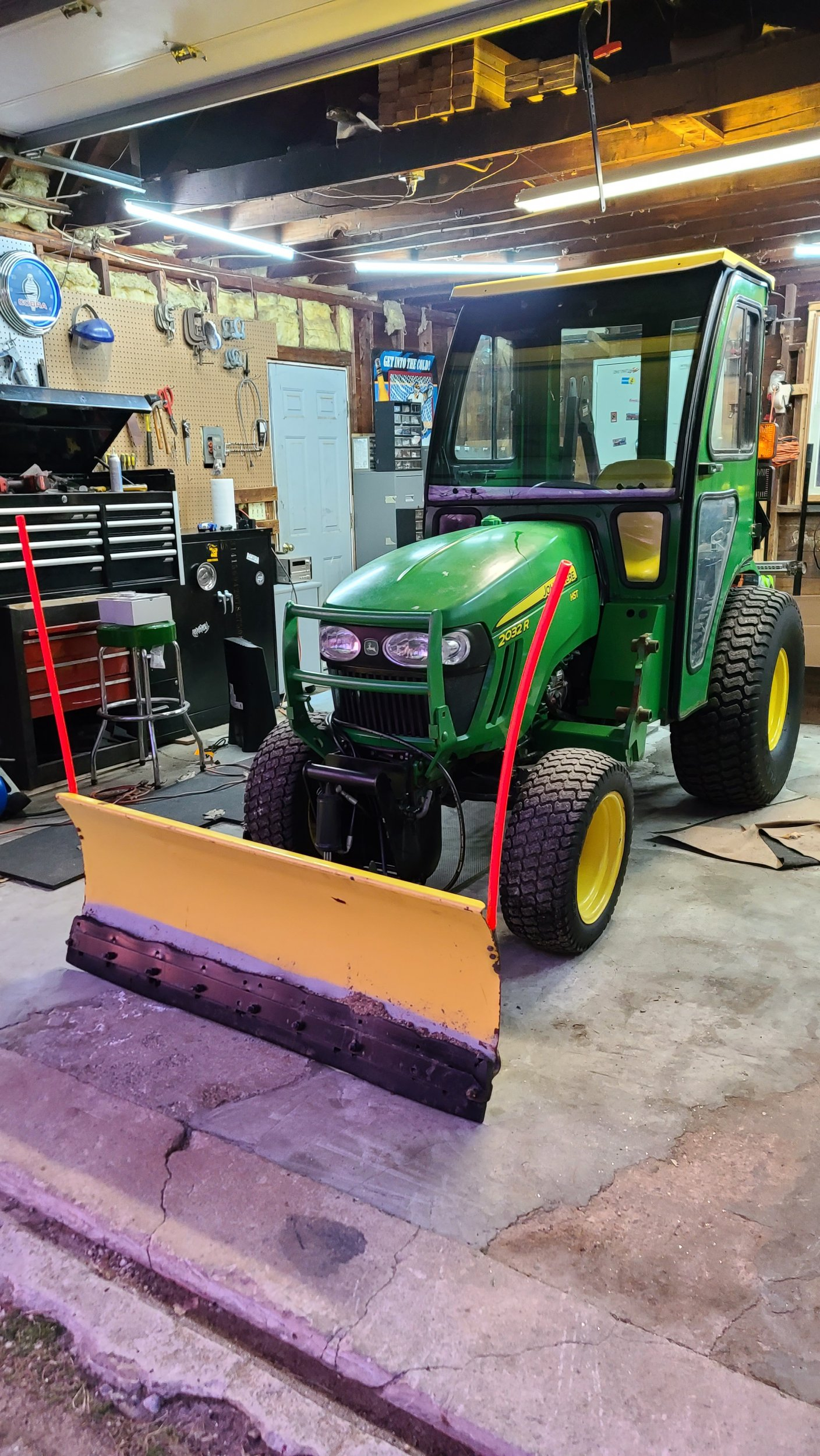

Hey everyone I've been having an issue with the JD quick connect 54" plow on my 2014 JD 2032R (first gen). It operates normally up, down, and left, however when I move the joystick right I cannot move the lever all the way or the plow will go the opposite direction. If I move the lever 60-75% it will move at full speed in the correct direction. When i go past that, the plow goes left. My best guess of the cause is that there's some blow-by in the piston at full pressure causing the blade to reverse direction.
I am new to larger tractors and hydraulics, so please be gentle. Also hoping this hasn't been asked before, I searched for answers before posting and found nothing related. Thanks in advance.

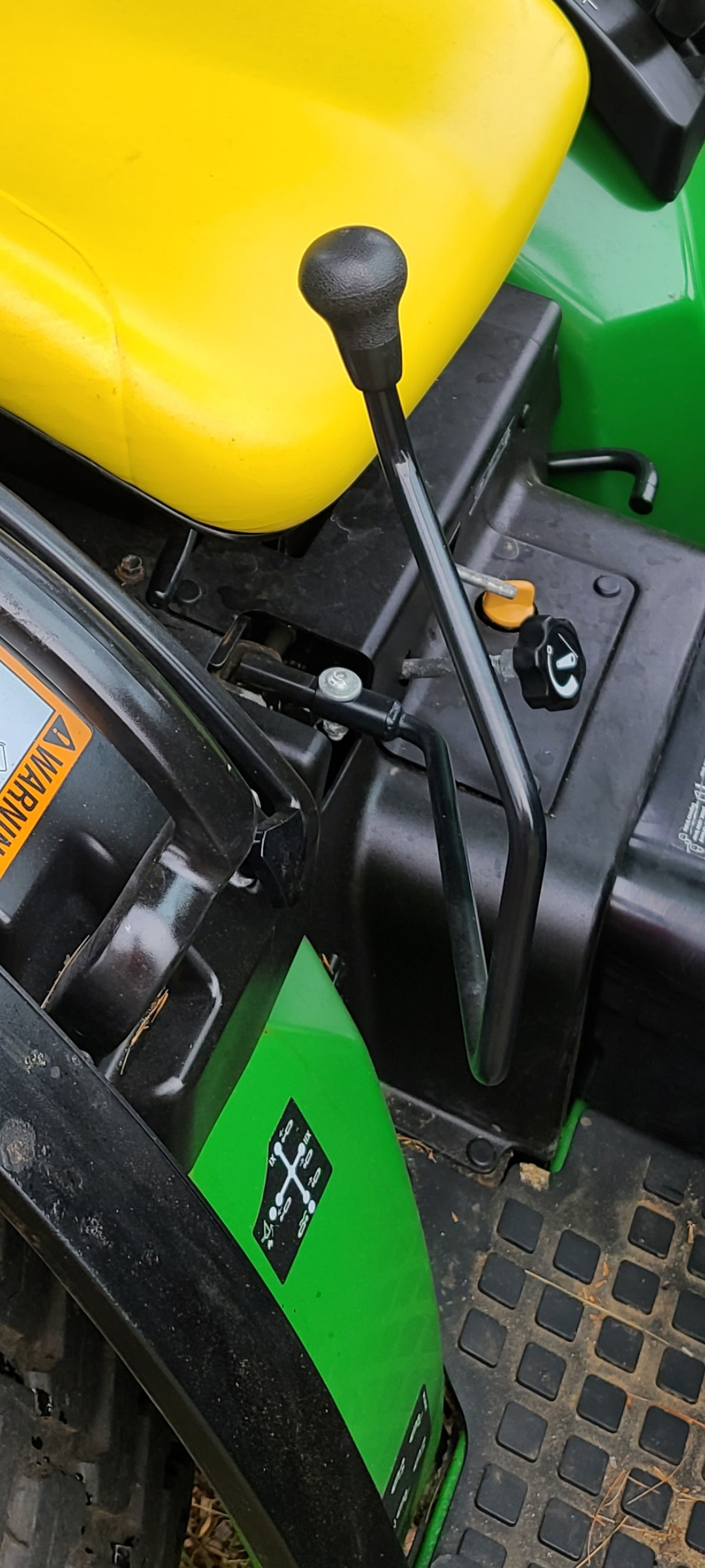

It's a deere brand 54" plow attached with a deere quick disconnect system and it uses the loader controls. Below is the best pic I have of the setup right now.
There's also a deere snowblower that attaches with the same set up (plus pto shaft etc). I'd like to assume that the plow and SB are designed to work with this tractor, but the dealer couldn't find me a u-joint for the SB pto shaft and said this tractor should only fit a 59" or 48" (or something near that) SB. So it may not be an exact fit, but close enough to clear snow.
I think this plow uses just one cylinder to angle the blade, so it must be double acting. It has a second cylinder for lifting (and no float function afaik).
I'm not sure if it's economy or premium, but I expect it to be economy.
This isn't really a major issue to using the plow, I'd just like to address any issues if possible.
I think they're hooked up correctly... but could be wrong. UDLR all correspond to the according lever movements.

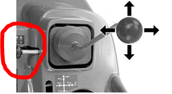

I *think the pin circled in red will help with this. I may be remembering incorrectly. If you push this pin all the way to the right I believe it locks out the entire loader control valve. If you push it part way in I think it's supposed to lock out the regenerative dump feature. I haven't messed with mine in a while so I don't remember enough to be sure.
If it does lock out the regen feature you should be good to go.

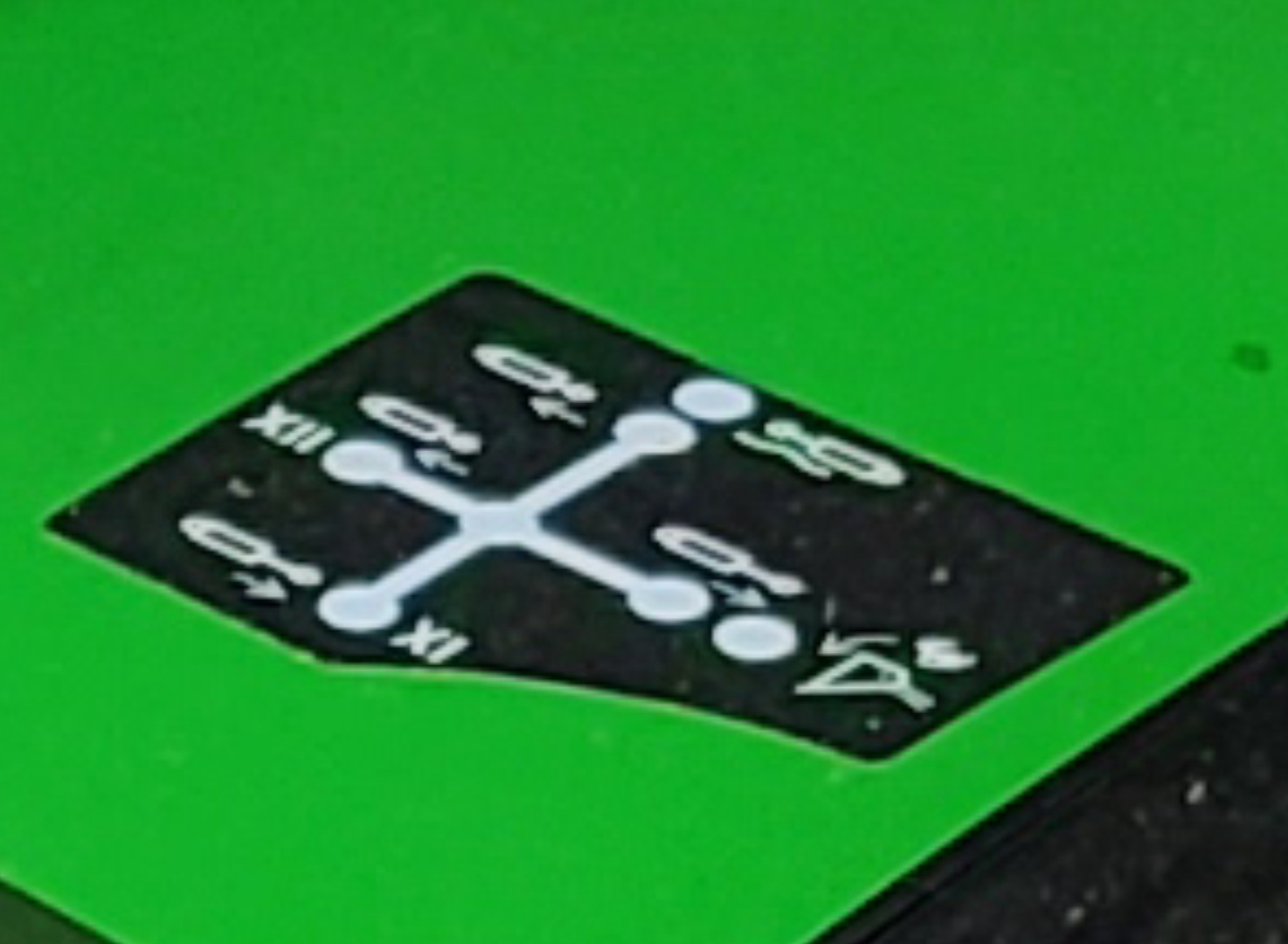

This looks like the controls for a 2nd gen 2032r. I've got the first gen, and don't see a pin like that.
Upon closer inspection, the control diagram seems to show me exactly what you guys are all saying! If only I was smart enough to figure it out in the first place.... thanks for all the input.
