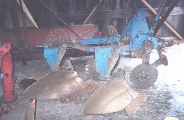

A 2wd NH3930(50hp) with loaded tires pulls this double 16 thru our rocky New England soil.
DFB
