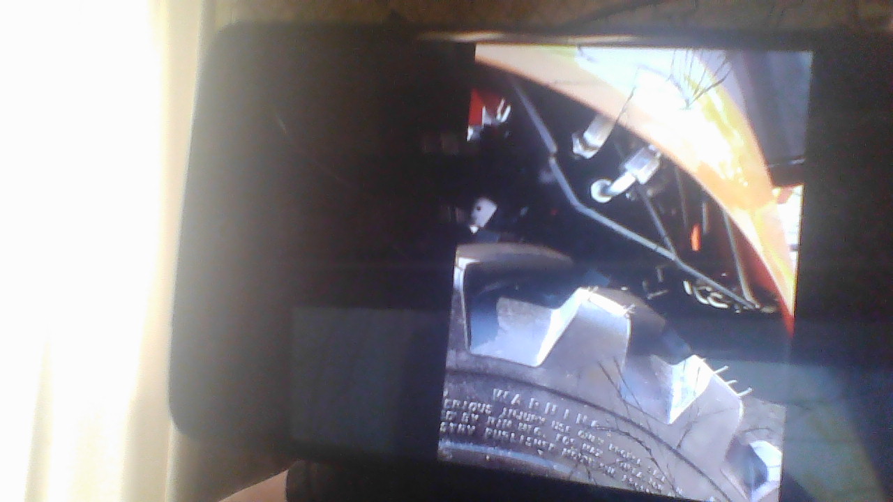

I have purchased a BX23S. To me something seems wrong at the right side (while sitting it seat facing forward) rear wheel well.
What I am asking for is a pic of your BX23S rear wheel well area. Specifically, the 12 o'clock to 3 o'clock area. Thanks in advance. Dealer tells me that all of them are like that, but I don't think that I would have missed what is on there now. Pic is below. IMG_20200512_142847.jpg

Thanks! That is what I remember. Dealer says they did not alter mine, yet I think they did.
   / Please send me a pic #5
It's normal for the BX with that option. And you already made a thread about this, why the need for another one.
   / Please send me a pic #6
One other thing, the mounting of the controls near the seat means that the valve is right under the FEL lever which is much better in that there are no cables running from the control. This means the lever is much more responsive and less trouble over the years, bxs that are sold with a FEL are like that.
   / Please send me a pic #7
Just spent a couple of hours redoing the wiring for the third function valve. The installer routed the wires on the wheel side of the shield for the loader valve. I thought it looked a bit sketchy in that a loose chain or a stick could rip the wires apart. there are plenty of plugs so you can just unplug all the connections in the wheel well and reroute the wires behind the shield and the hydraulic lines. I could have done it quicker if I removed the right rear tire but it is filled and my Jack is a bit leaky. Onward and upward!
