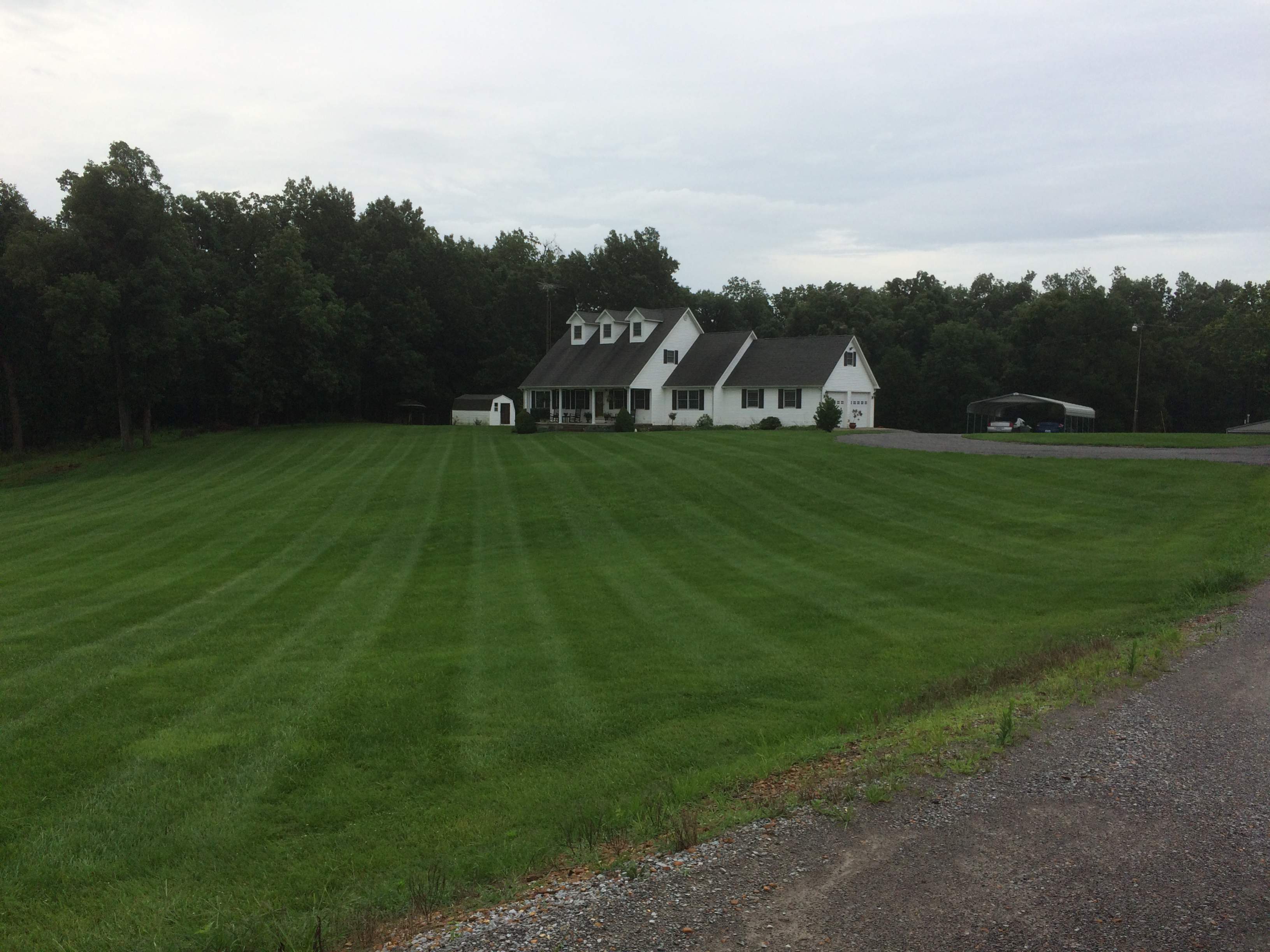

I've seen some use the chains and I've wondered how well they work. The chain solution would be ideal for this application so I'd really like to see the results. Got any pics?
   / Please post your lawn striping kit attempts! #5
Here is a shot of the front, been almost a week since I mowed so the stripes aren't real sharp.

Can I ask what size, length and spacing you used for the chain?
   / Please post your lawn striping kit attempts! #7
I got the 5/16 x 25' bucket for around $30 from Harbor Freight. They are cut to a length so 2 or 3 links are on the ground, the links are welded to the angle iron so they are touching each other along the length of the angle iron.
