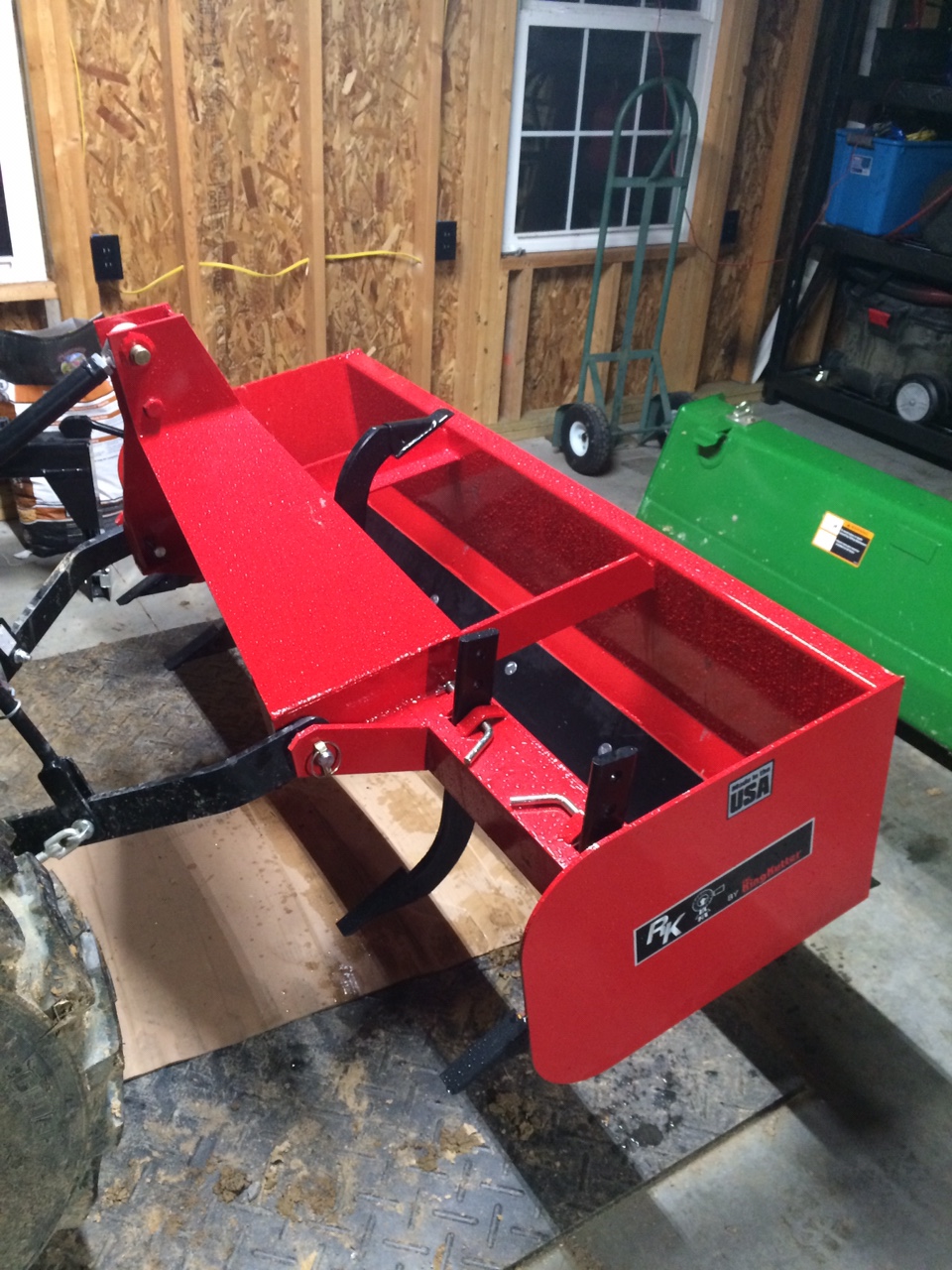

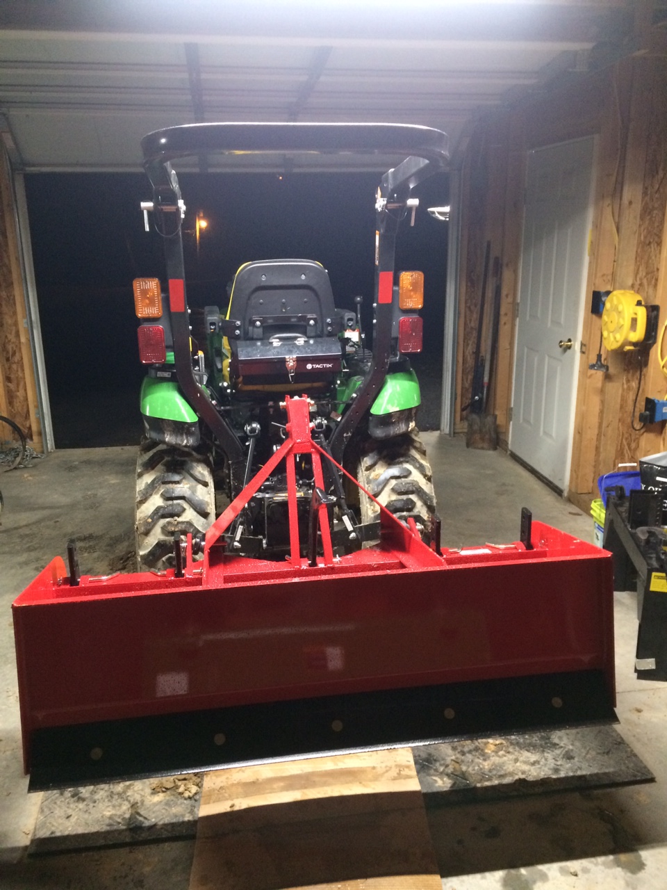

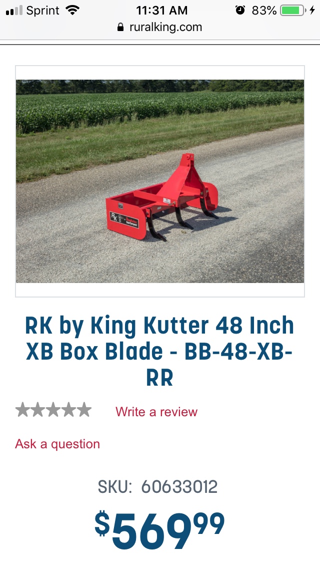

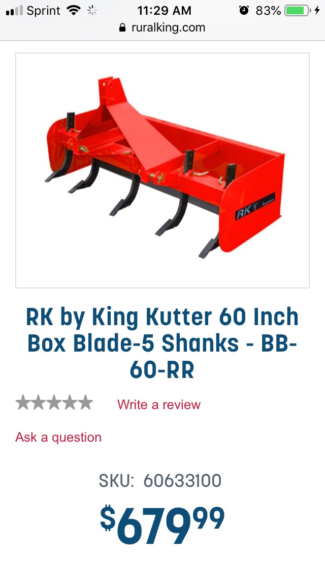

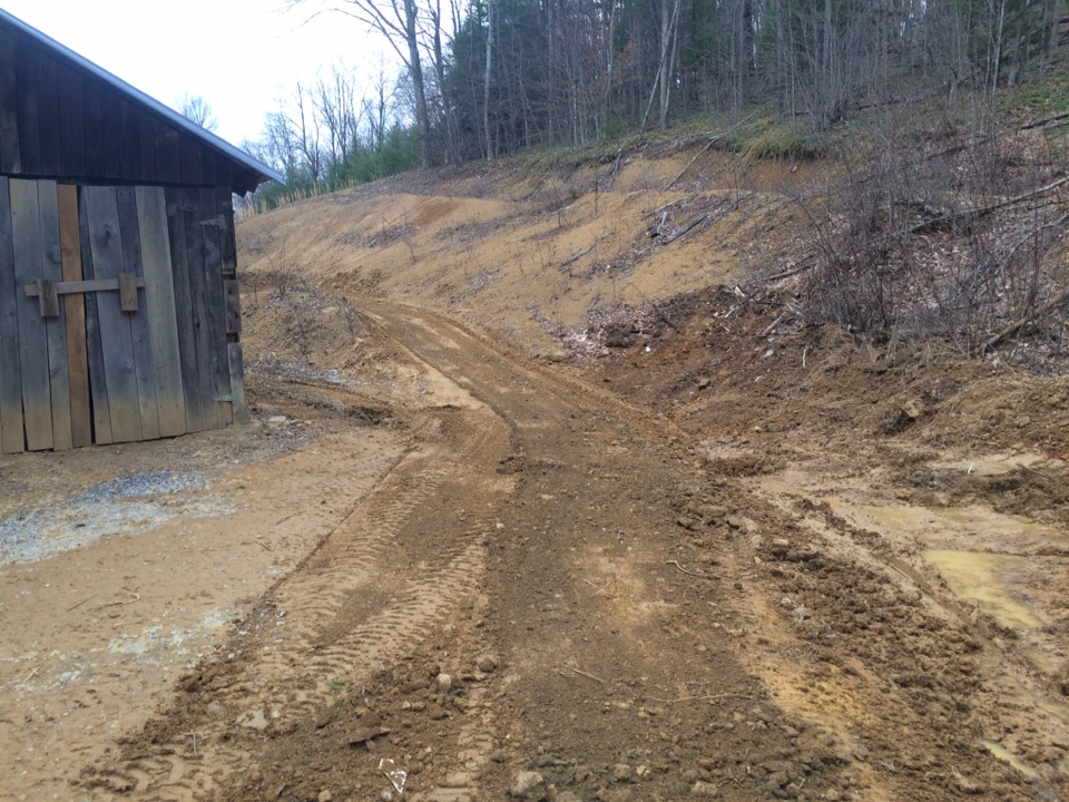

Just picked up a 5ft box blade for my 2018 JD 2025R because it was on sale for the price of the 4ft. Now I’m worried it’s too wide. I can swap it for a 4ft model but it’s exact same price. The 5 ft is a much better made piece of equipment but it won’t help me if I can’t use it. I need to decide quickly before I get it dirty. IMG_9889.jpgIMG_9888.jpgIMG_9881.jpgIMG_9883.jpgIMG_9884.jpgIMG_9882.jpg

I have a 5 foot box blade on my 2320 (very similar to your 2025) and would not want it narrower. Yes, you can dig deep enough to stall the tractor, but you could do that with a 4 foot wide one also. Having the blade wider than the tractor gives you some flexibility when working around obstacles.

Thanks. I have been stressed out about it but I just took it out and scratched it up. Worked great. It’s all mine now. I agree. I like the extra width. It pulls a full box fine. Haven’t tried dropping the scarifiers but I doubt I’ll use them much anyways and if so not at full depth.

I don’t have any complaints. It worked great. Everything is wet here but I wanted to try it out anyways. Full box of damp dirt and it pulled it great.

Played with top link and was able to get it to cut a little at a time going very slow. Also while feathering/adjusting 3pt lift as I would go up and down grade. I Filled the box several times with no wheel spin even in sloppy conditions. Adjusted side link to even up some terrain I was grading. Does an amazing job but I see where a top and tilt kit would really make you efficient. To really make it give you the results you want you have to make constant adjustments. Overall I was impressed with how good of a finish it left as well as how good the little tractor handled it. I was concerned with the weight of a full box but am very relieved I got the 5ft size.
