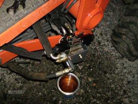

I took delivery of a new Kubota GL5240 HST this afternoon. After finish mowing for a couple of hours, I unhooked the RFM and went down to a pile of logs to test out the Grapple I had purchased with the tractor. It was almost dark, so I wasn't doing any heavy work whatsoever. I was basically trying to get a feel for the way the FEL joystick and 3rd Function worked. The loader didn't seem to be lifting very well, and then all of the sudden I heard a hissing noise. I looked down to my right and fluid was spewing out of what I presume is the 3rd Function Valve. It is mounted under the right side of the floorpan and has a box covering it with a sticker that says "No Step". I was only a couple hundred feet from where I park the tractor so I just stepped on it and parked it before I shut it down. Of course, I left a well defined trail of fluid across the field.
After parking it and letting it set for a few minutes while trying to figure out where it was coming from, I started it again for just a few seconds. It was just gushing fluid out of the aforementioned "valve".

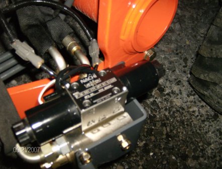

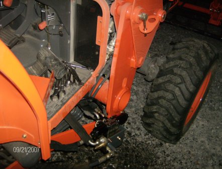

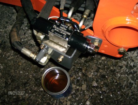

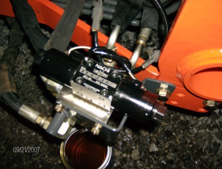

What would cause this on a brand new tractor? The best I can tell, it is coming out of the top of this thing. I have attached pictures to illustrate (after removing the "no step" box that covered it). I cannot find any hoses leaking. If you look you can see where it is leaking where the top part joins the base. I can't imagine what I did to make this happen, but who knows.
Any thoughts? Thanks!

Sorry couldn't resist. I do not know exactly how that is plummed into the hydraulic system, but it looks to be an electric over hydraulic control valve. Based on the number of lines off it, it looks to be a PB valve. If it is leaking where the electric bolts onto the valve body, this could be similar to a leak at the end of a normal manually controlled spool valve. This is usually caused by excessive backpressure on a return port. If something got clogged, kinked or disconnected downstream, or perhaps the valve kit was plummed incorrectly when installed, High Pressure might be getting applied where there should only be low pressure. That could cause this type failure. It could also just be a new defective part.

That is just about the dumbest place to put that valve that I ever seen. Aside from fixing it I would insist that the valve be mounted in a more secure place.
   / PLEASE HELP, NEW TRACTOR, HYDRAULIC BLOWOUT
Believe it or not, this is where the Kubota Third Function Valve is supposed to be mounted. It is even shown in this location on one of the tractors in their Grand L product brochure. I share the concern and voiced it to the service folks. Although they agreed that it might not be ideal, they said that with the way the valve assembly is designed, there is really no other place to put it. At any rate, I suppose time will tell.
The good news is they showed up this morning and fixed the problem. It was a blown o-ring on top of the valve body, underneath the electronic part. (I am sure that is a technically correct description.)
