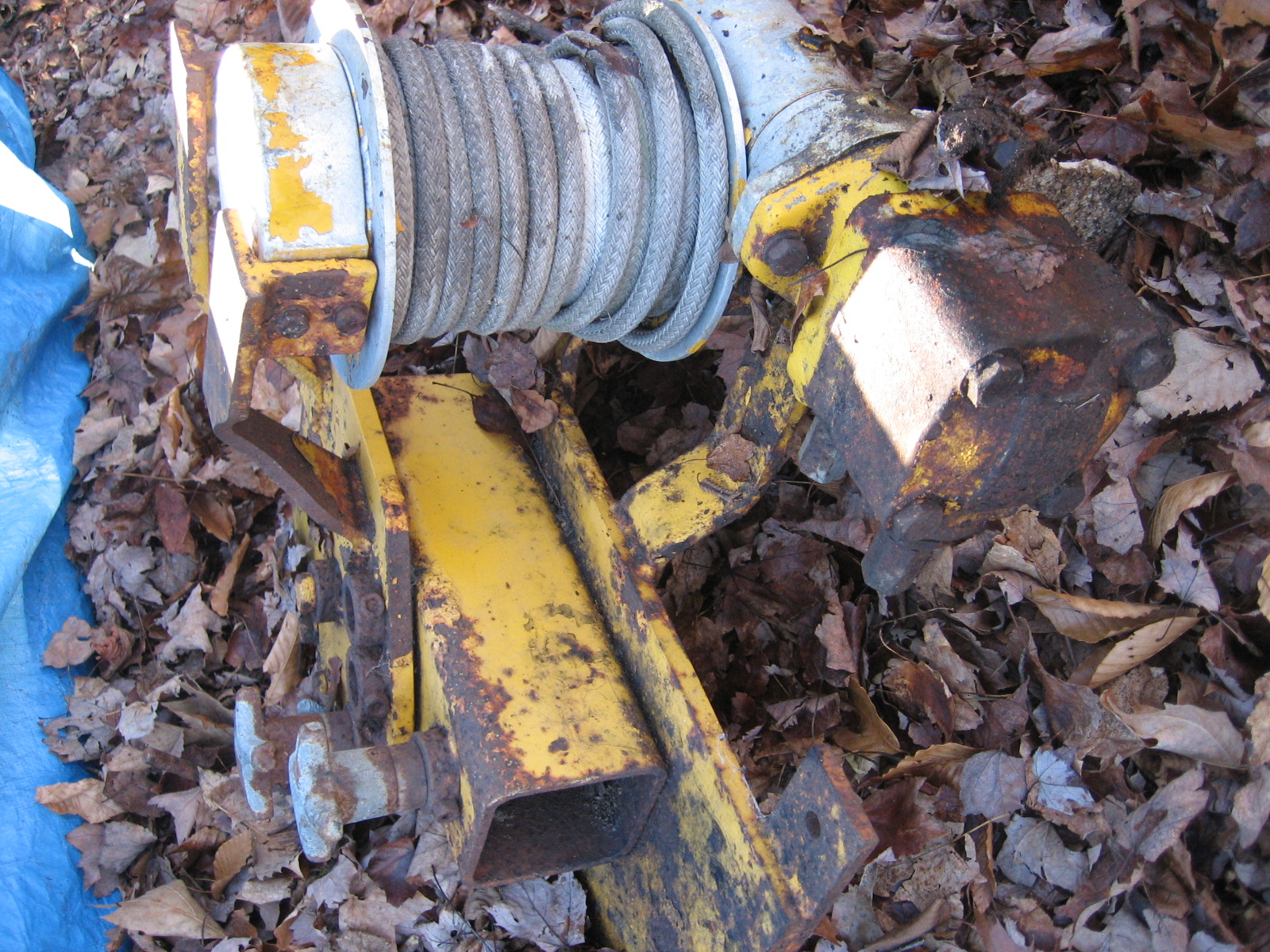

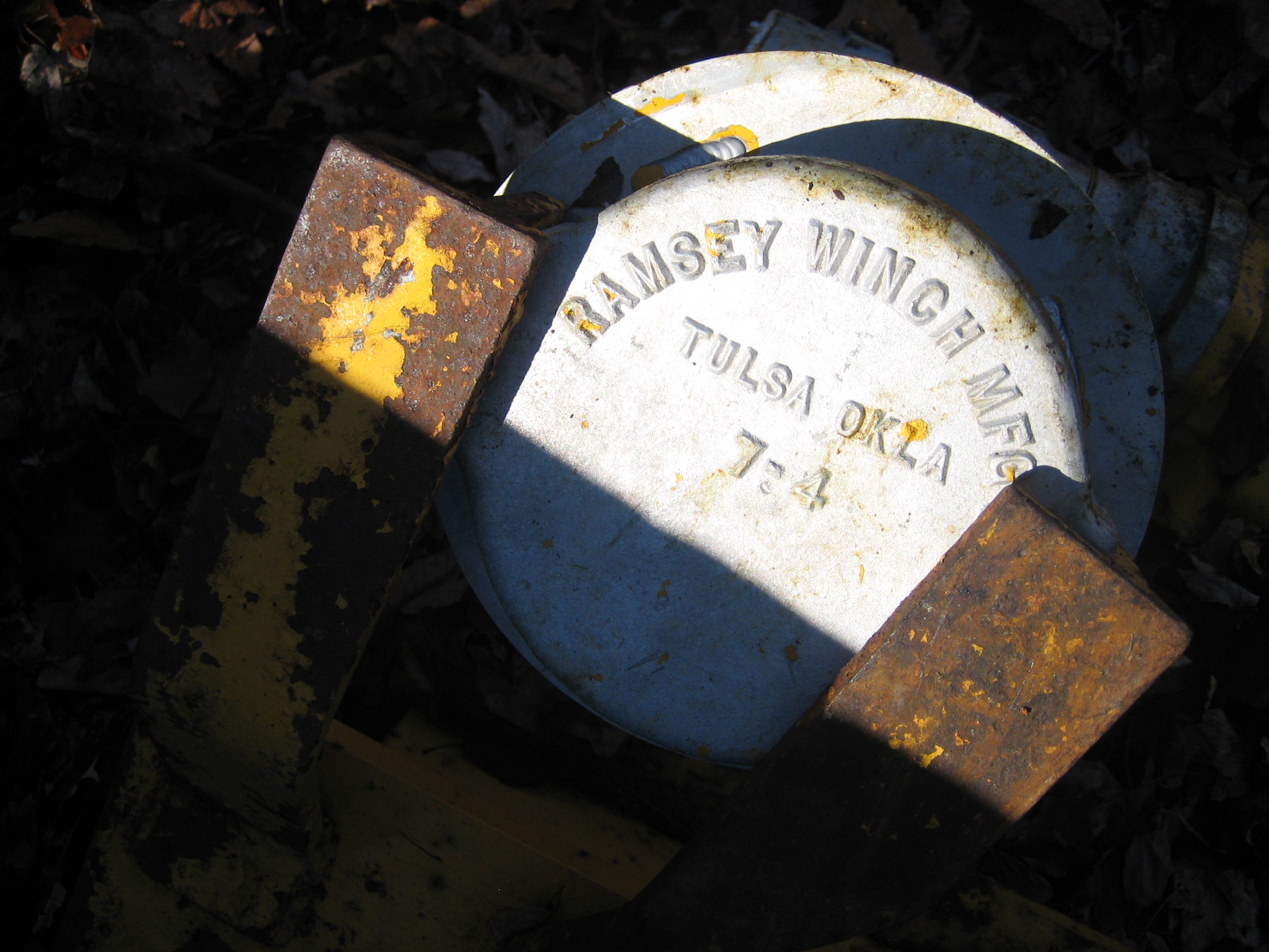

I am looking to add a hydraulic winch to my BX24. I have a lead on this winch but can not pull any numbers to do research and see if it will work with my tractor. The guy who owns it told me he could not find a model or rating on the motor, the winch is just marked Ramsey.
This is what he did find.
Vickers Hydraulic Motor Patented 2544387, 2544988, 2544990 7(or 2)64193
Eyeballing the port sizes they look to be around 1/2" NPT and 3/4" NPT.
His best guess at the comparable current model: | Ramsey Winch |
Do you think the hydraulics on the BX can handle this?
Is this a winch that would work?

It should work with any hyd flow. Question is, what pressure/GPM was it designed for. You might start off and regulate the pressure to 1500 psi. The GPM will dictate the rpm of the hyd motor. What is the GPM of your tractor.
A better pic of the hyd motor would be good.

It looks like a worm gear off the hyd motor running a spur type gear on the winch. I will bet at 3.7 gpm the winch will be very slow. If you could get a motor PN you would be able to at least know motor rpm at flow.

FWIW ....... looks like a winch off a utility bucket truck, if that's any help in determining what exactly the winch is.
