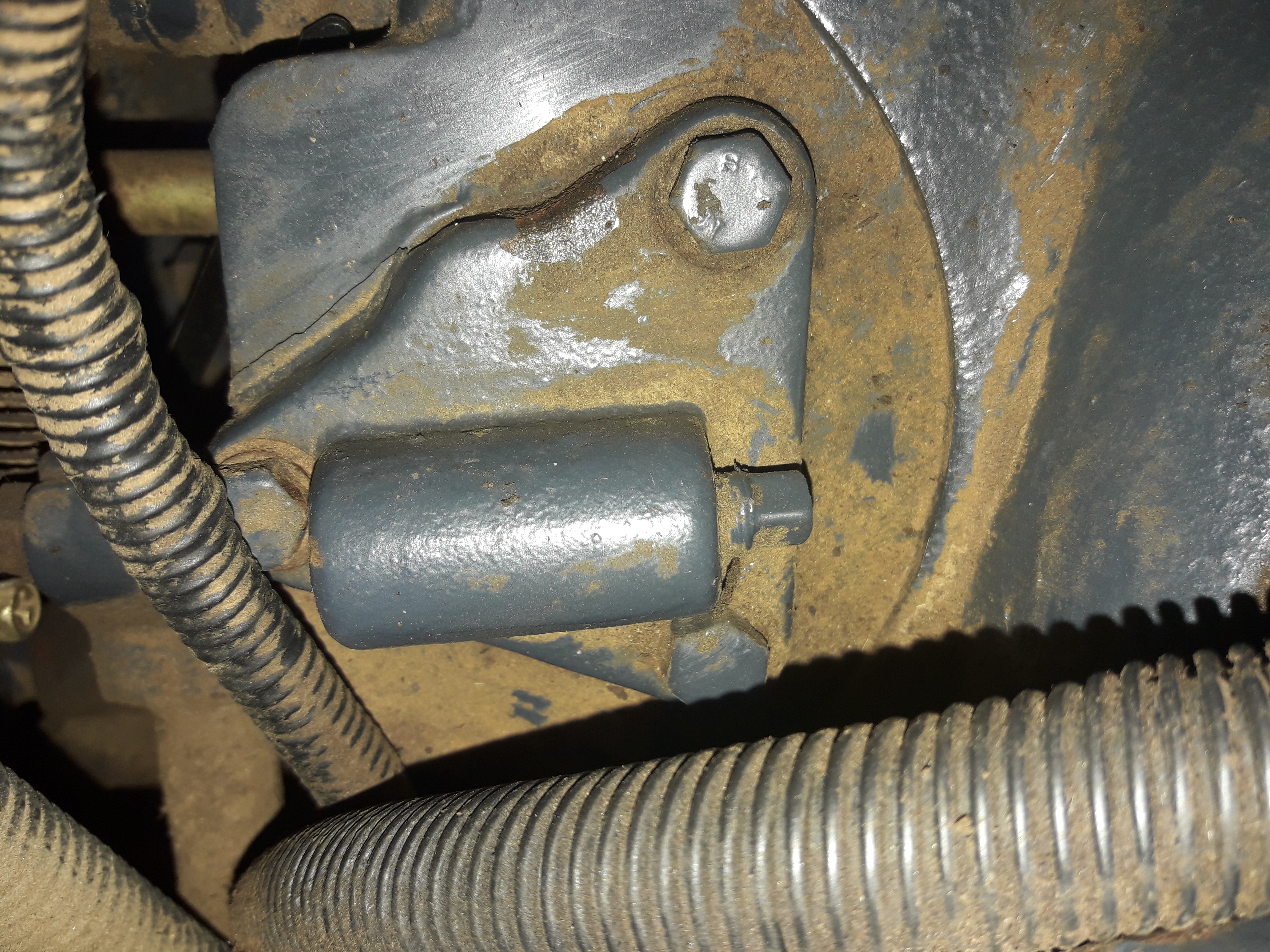

I have a Mahindra 2810 and I am working on installing top and tilt on it. There are currently no hydraulics except for the 3PH. I removed my seat and identified what I believe for certain 1 of the ports and possibly the second.
The first picture shows what I believe to certaintly​ be a port. It is horizontal in orientation and has a small threaded plug installed.

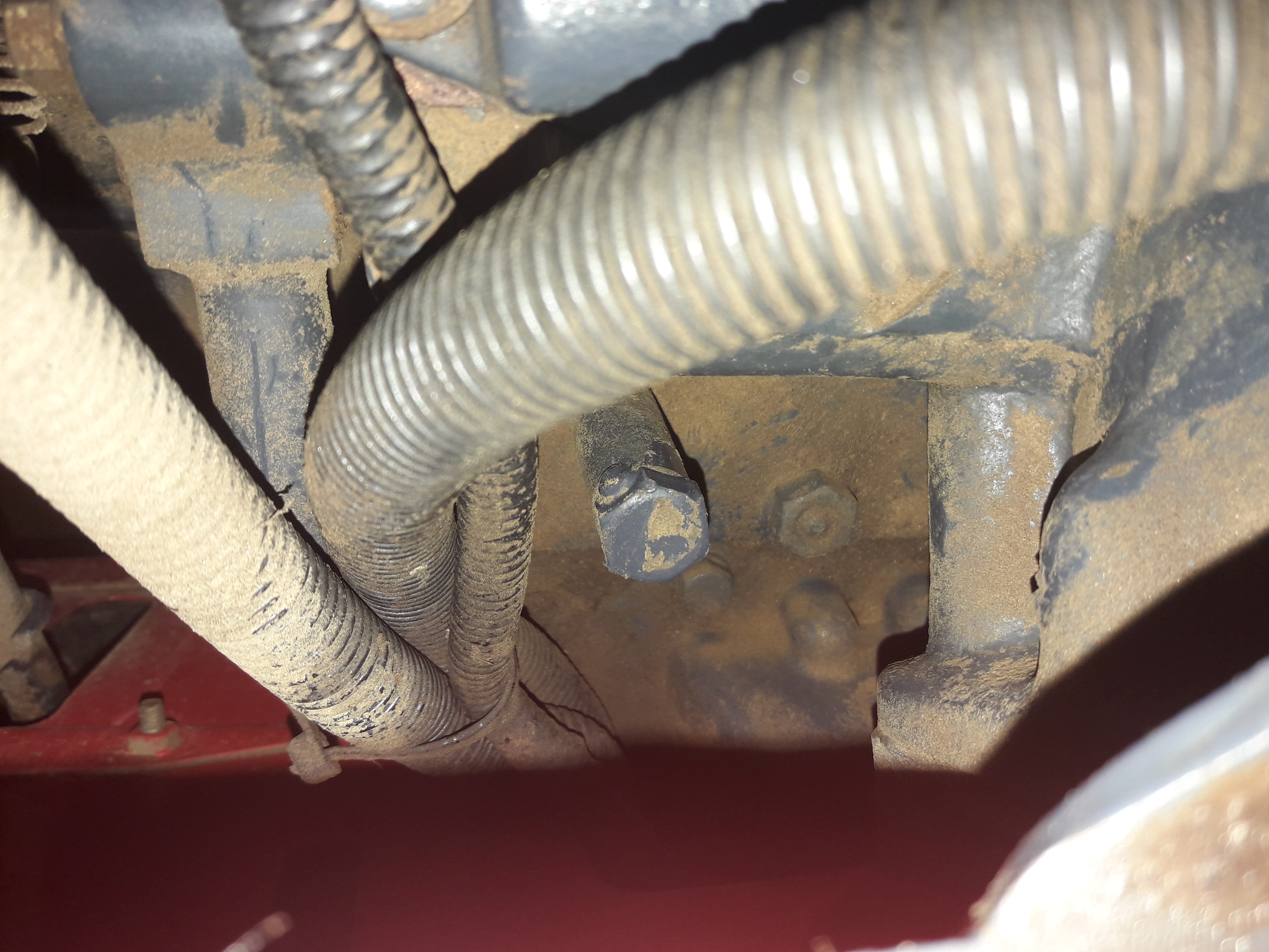

The second picture shows what I believe to be a second port. Whereas the first port was horizontal and fairly small, the second picture shows this potential port to be larger in diameter and vertical in orientation. As I examined this second tube/port it definitely has a threaded cap on it.
These are the only 2 possible ports that I could find in this area. Based on the different diameters of the 2 ports, which would be the outflow from the tractor to the control levers, and which would be the return flow from the control levers back to the hydraulic fluid reservoir on the tractor?

The is actually no associated with my 3PH. The hydraulic fluid is coming from the fluid reservoir that serves the PTO and the lift arms. The first picture shown actually sits on top of the rear axle.
I understand about the route that you explained. My confusion is to how I return the hydraulic fluid back into the reservoir since I only have 1 port pictured in the first picture. That's why I am wondering if the vertical pipe pictured in picture would be where the fluid is returned.

Sitting directly under the seat was the area represented by picture 1. The picture contains, what I believe to be, a diverter plate with the threaded nut sticking out the side. I believe that would be the place where I would attach a hose to enter into the loader valve. If indeed that is a diverter plate to attach my line to the loader valve my concern then becomes where do I return the hydraulic fluid back into the reservoir.

I am pretty certain that is your port. If you CLEAN the dirt off, then remove the three bolts, there are probbaly three holes under it with oring seals around them. Two are high pressure in and out (one is at each end of that "tube" on the plate and the return to tank is under the slightly rounded edge on the lower side. The plug in there is for a pressure tester
Mahindra probbaly sells a plate to do that. If it is like one for the Kubota L3830, it should be around $30.

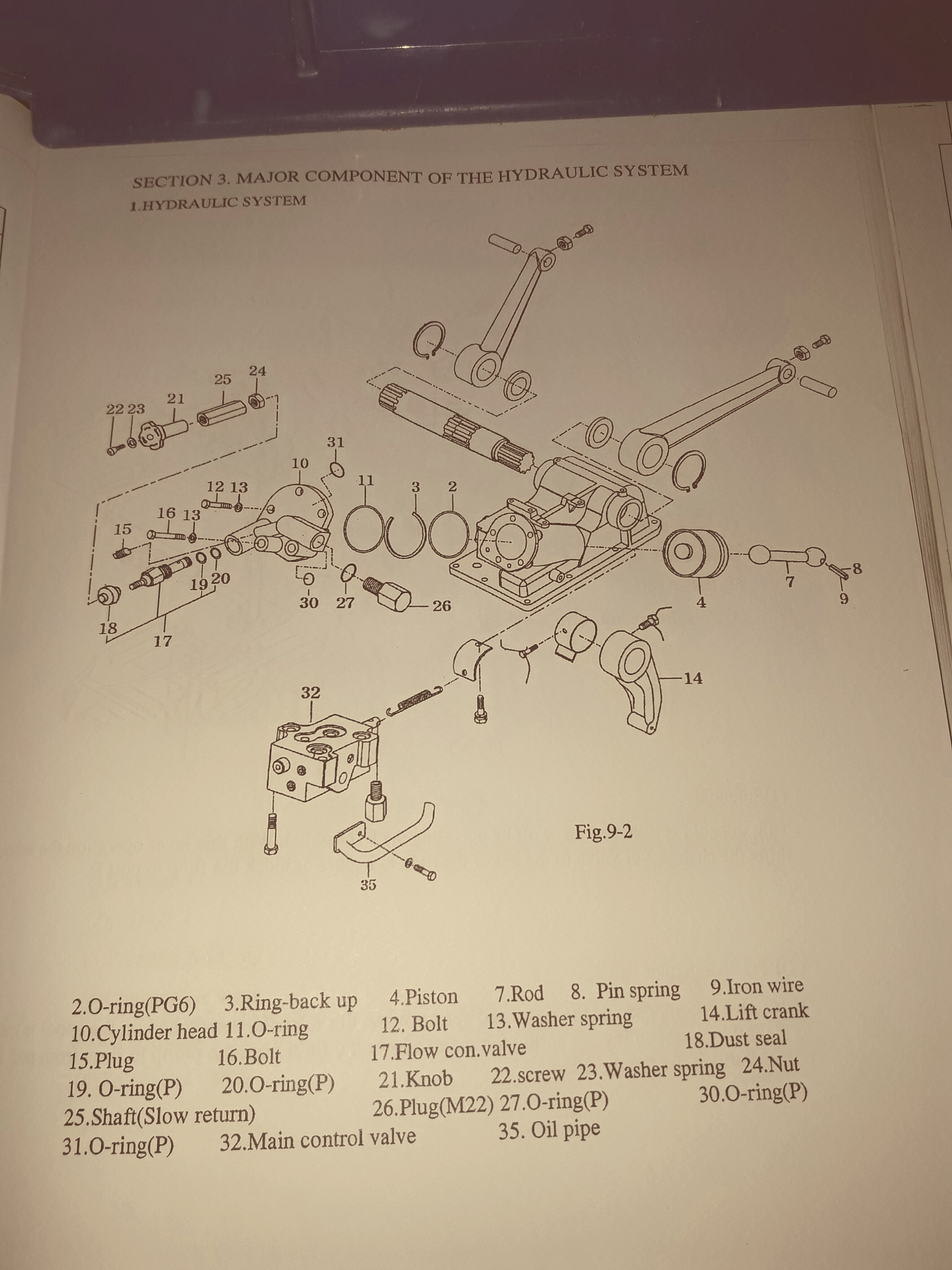

I do have a technical manual and reviewed the drawings. This first picture from the manual shows the hydraulic pump in place on top of the transmission. The 2 lift arms are shown on the upper back location of the picture as well as the various components on the hydraulic pump.

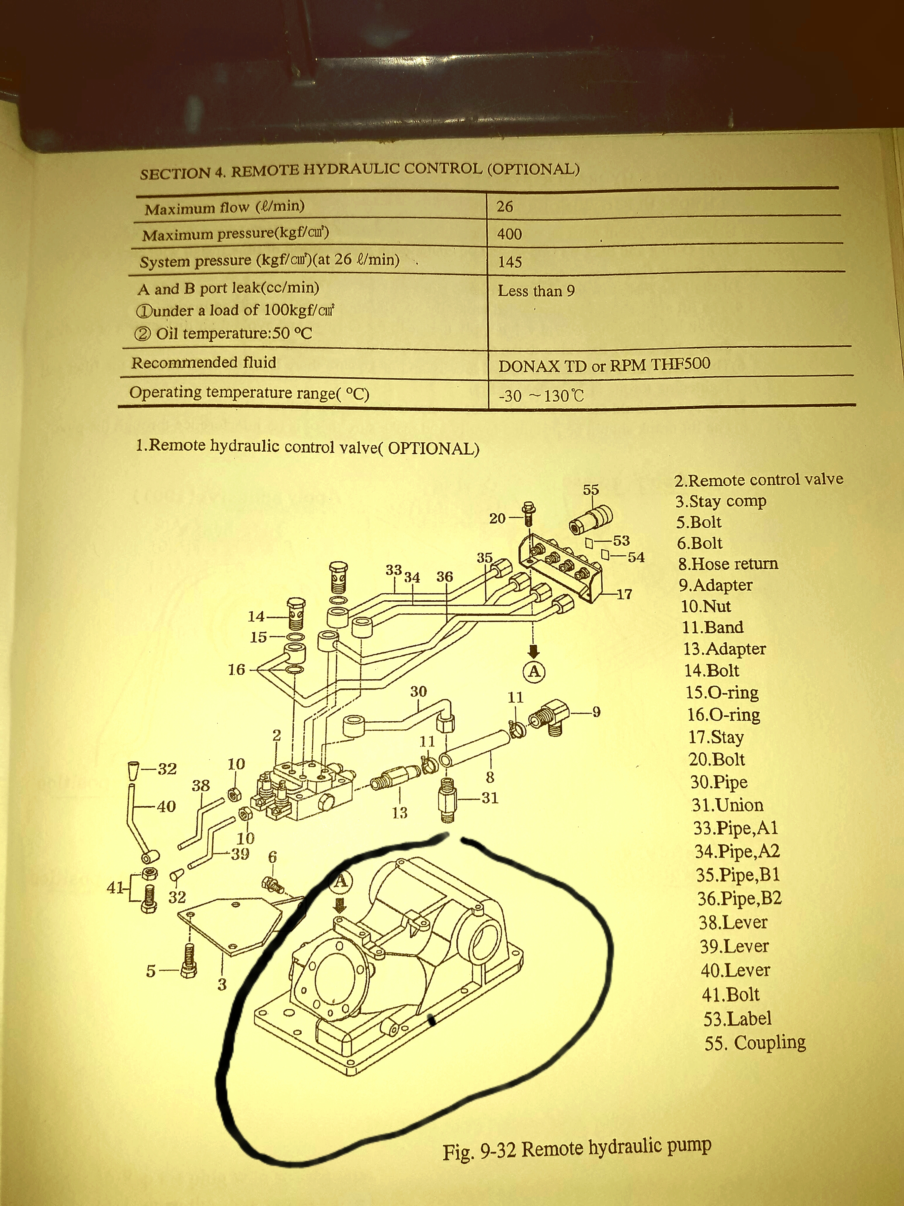

The next picture from the manual shows the addition of a hydraulic remote system added to the pump. The various components of the remote system and a general location for the system. In this second picture I have circled the existing hydraulic pump currently installed on the tractor.
In looking at this second picture of the manual I am still at a loss to identify a flow out port and a flow in port. Maybe I am just not seeing it. I do see what appears to be one port for flow but not a second.
