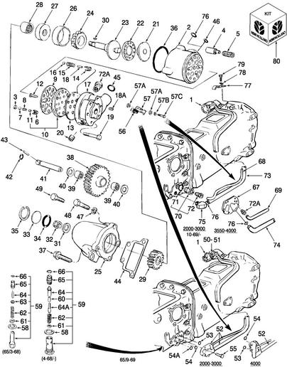

I've got a Ford 3000, the hydraulic pump started blowing hyd fluid between the pump body and pump cover on the top quite hard. I bought a rebuild kit and replaced the gaskets, springs, balls and guides, checked everything over to ensure all was ok, reassemble, put it back on the tractor, checked the fluid level, bled the pump and all was great!! Time to finally get back to Bush hogging the fields. (4 acres of my yard) I got only 15 minutes into it and on the way up the hill I looked down to notice it was leaking again. Not the same as before, it wasn't blowing out at full pressure from the top, this time it was a steady constant stream out the bottom. So I've got it all takin apart again on my work bench all pieces cleaned and dried, I am going to buy new gaskets again one of them had a very small nick in it. I did smooth off the pump body face as well as the exhaust valve plate rear face, they are much smoother and level.*
So all that being said, before I go and reassemble it again and quite possibly get the same outcome, is there something more I should check or do, could it be too high of pressure causing it? Would the exhaust valve plate be bad? Could it be getting plugged up down the line in the differential stopping the flow to where it builds up behind the exhaust valves and blowing out through the seems? Should I JB Weld the heck out of it and hope for the best? Lol. I am at a loss and at my wits end with the constant issues that keep arising. PLEASE HELP!!!

Here is an exploded view of the pump on the top left.

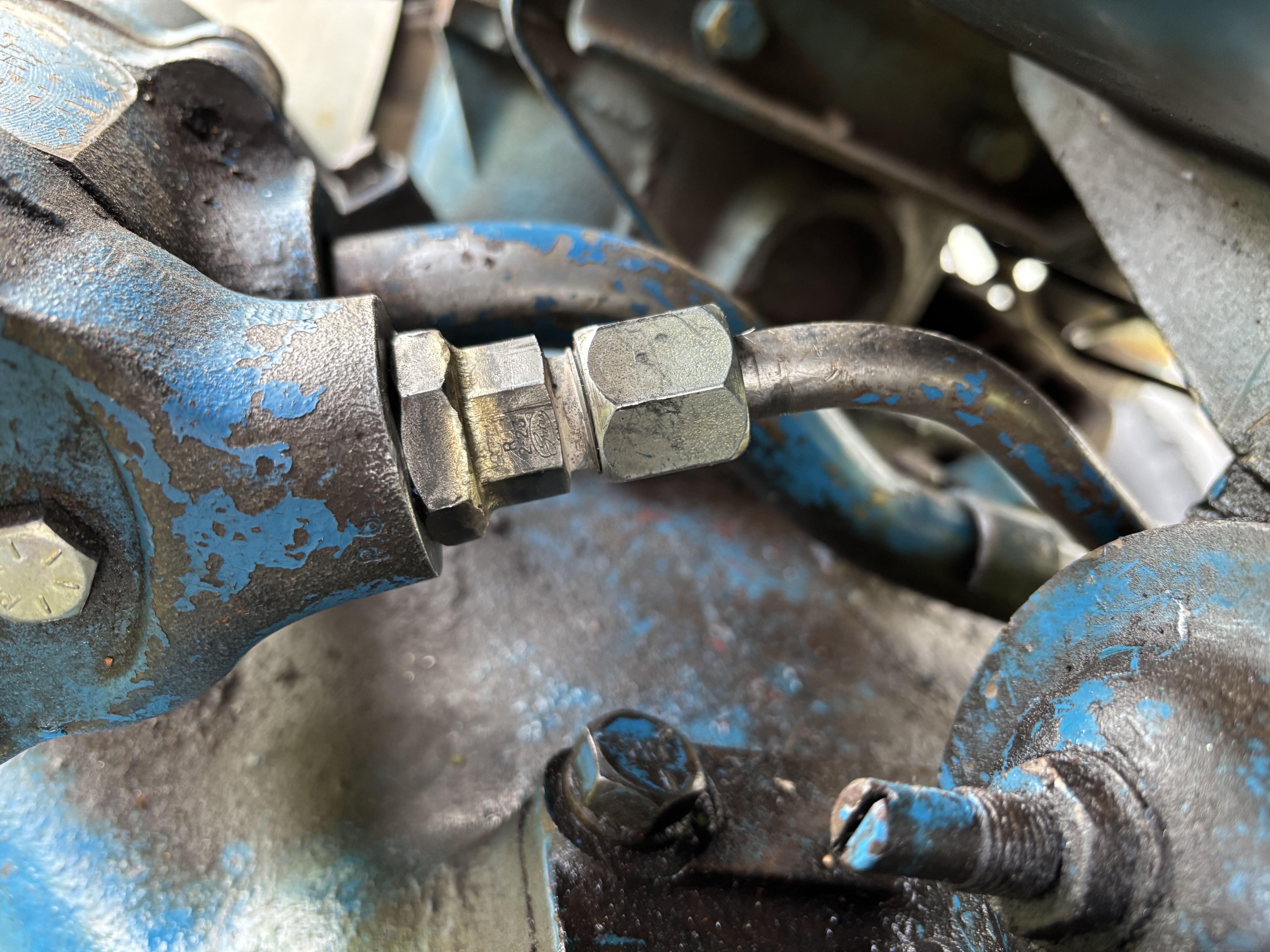

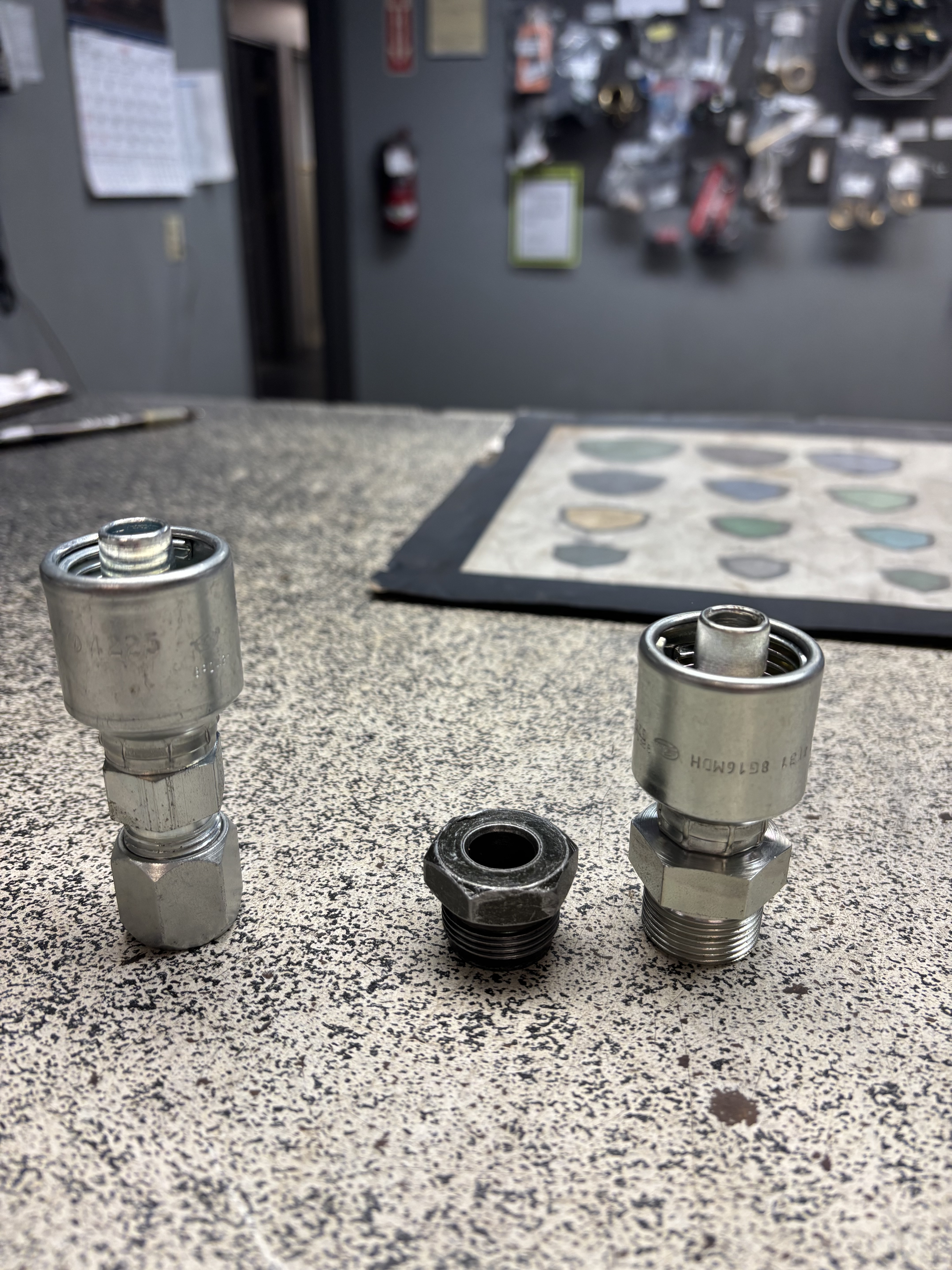

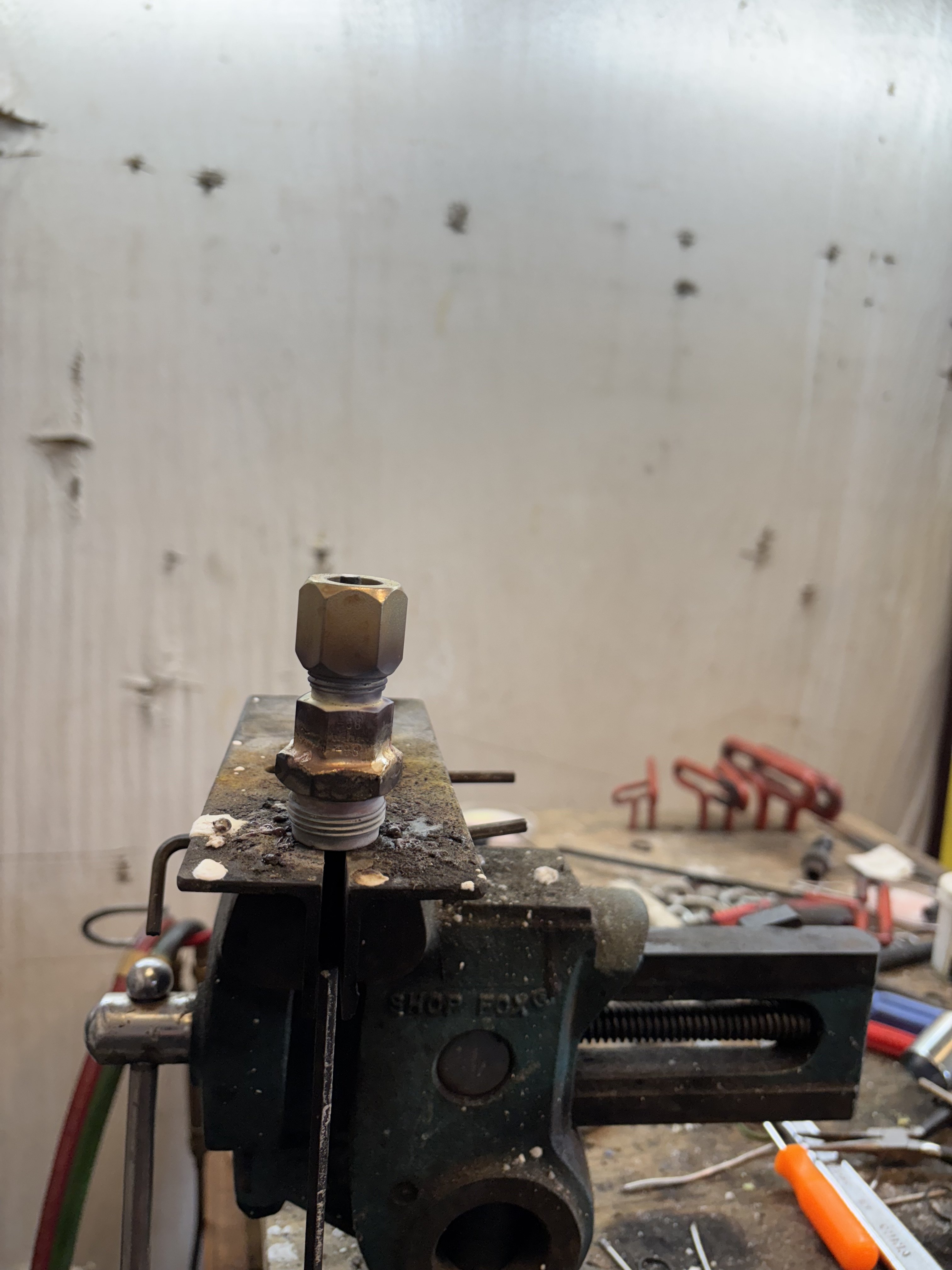

Had high press leak. Tried 5 piece replacement kit, leaked worst. This is my $40 fix
