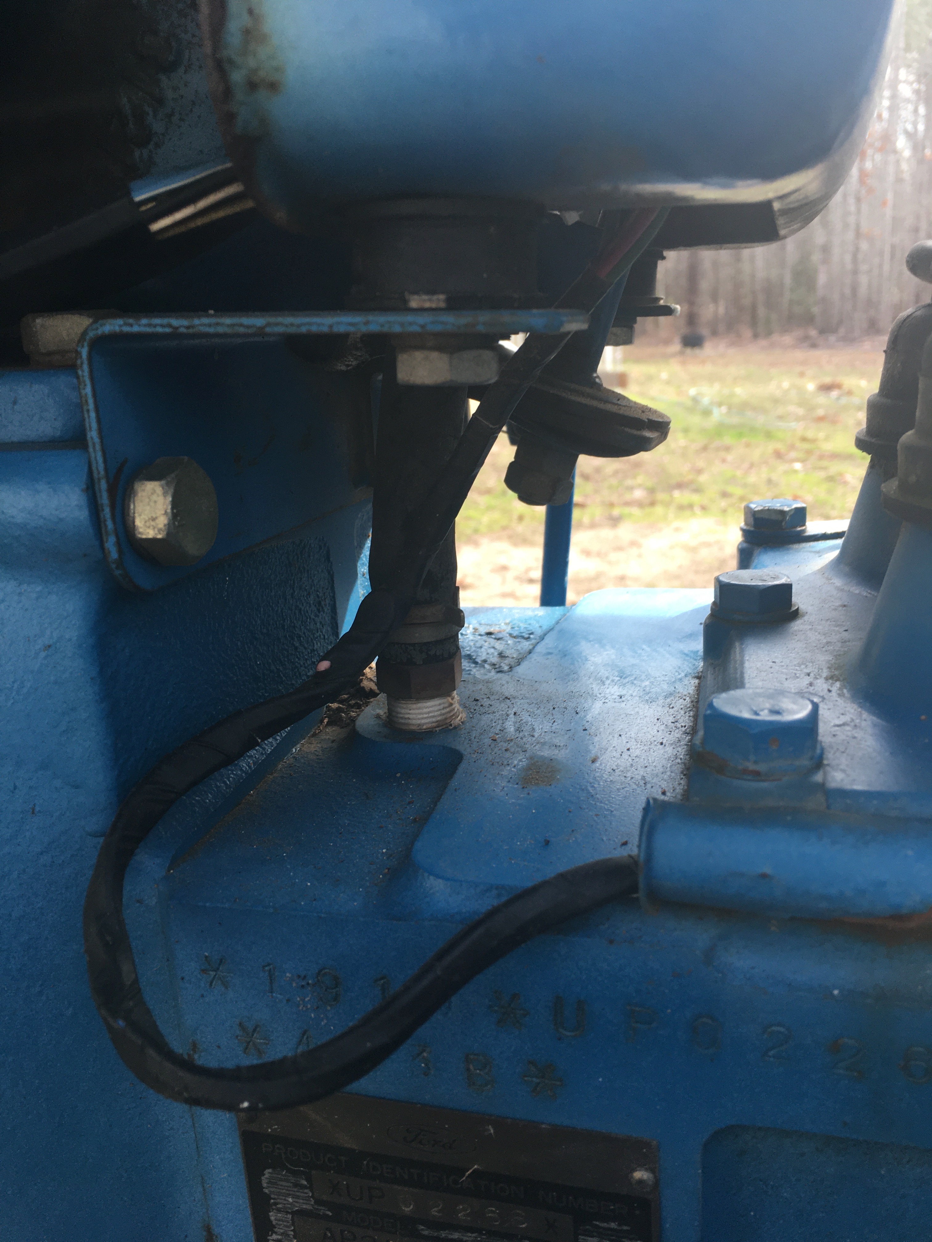

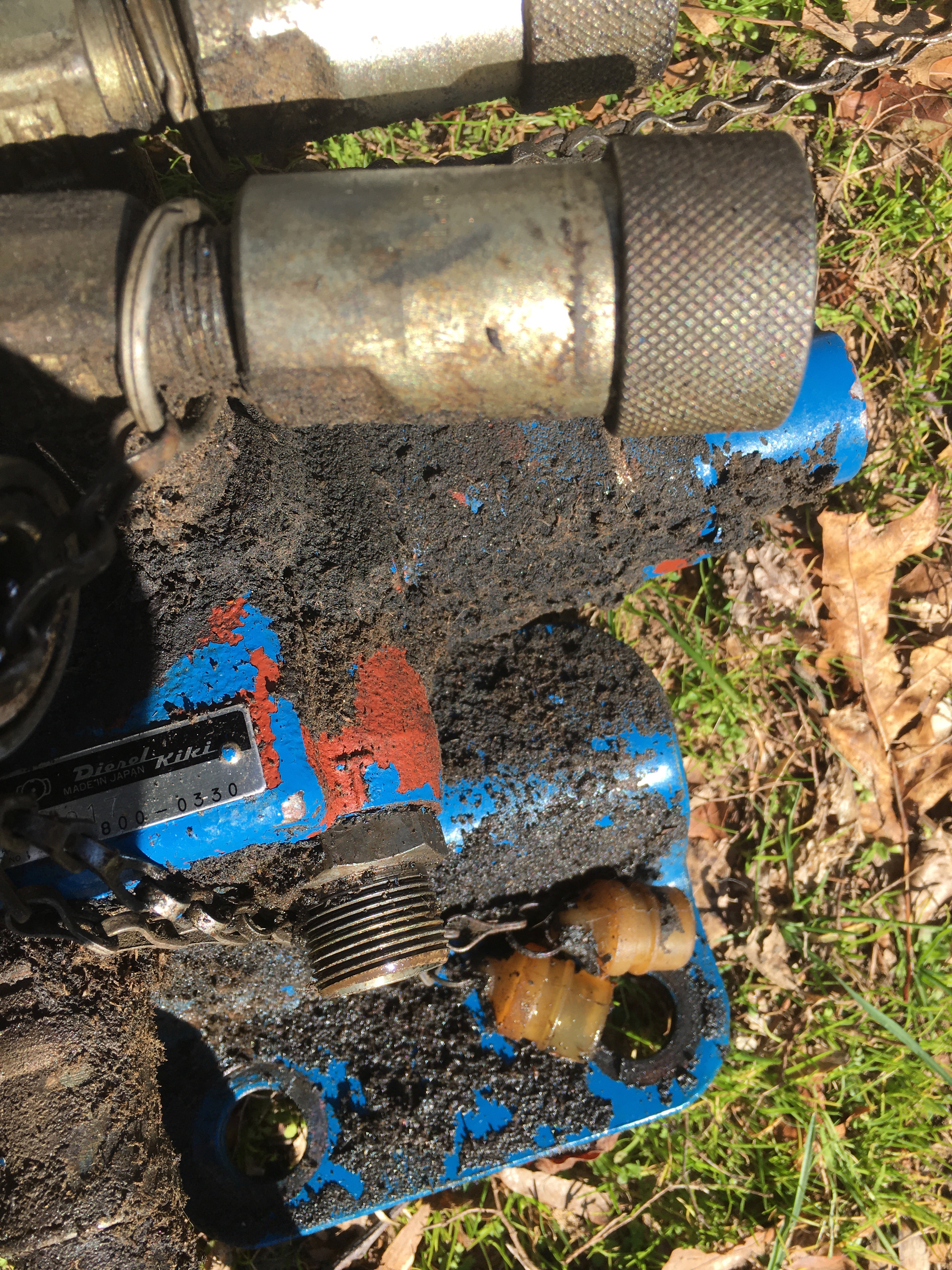

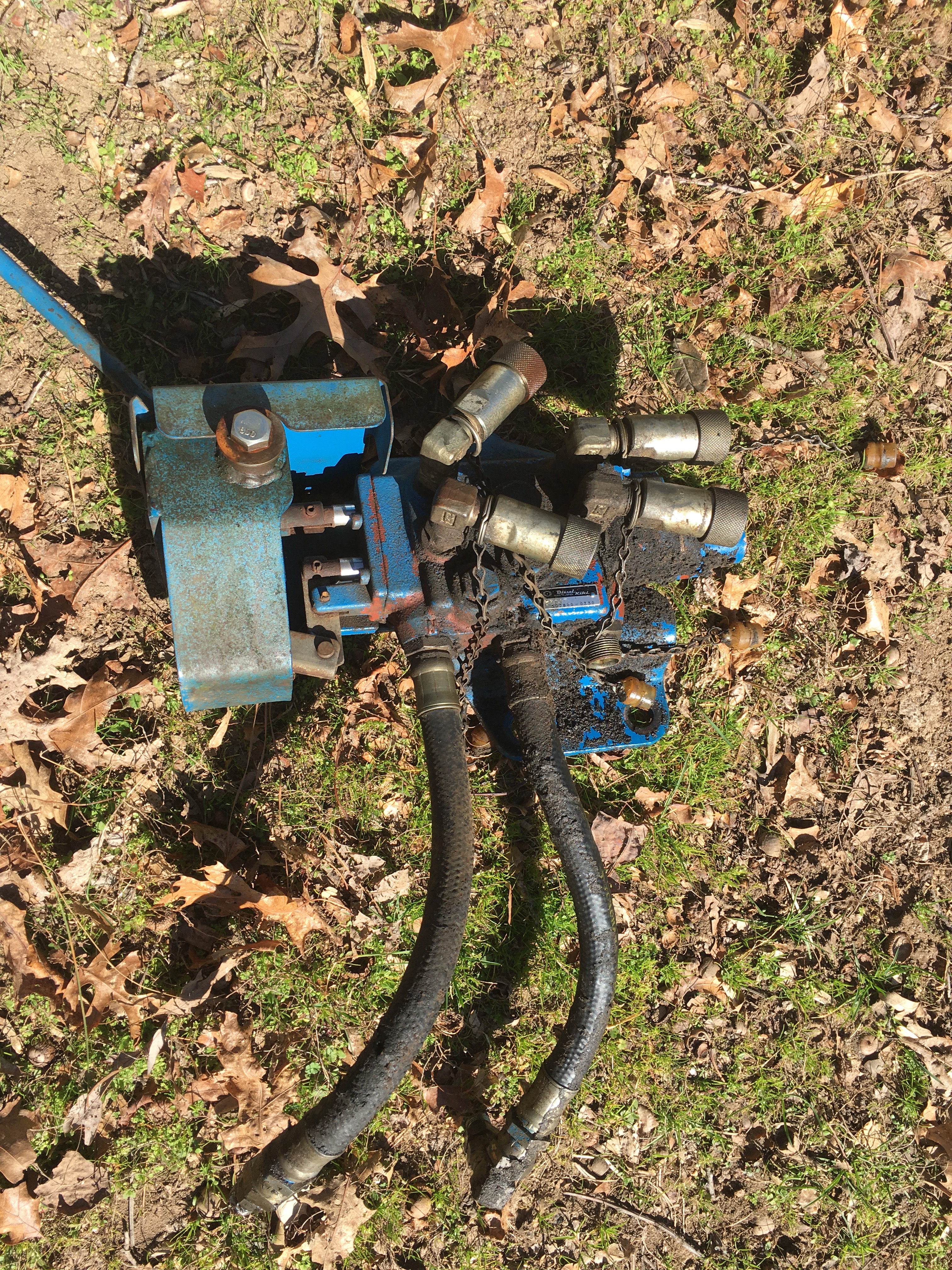

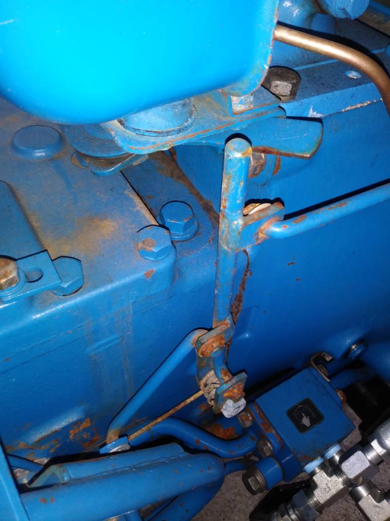

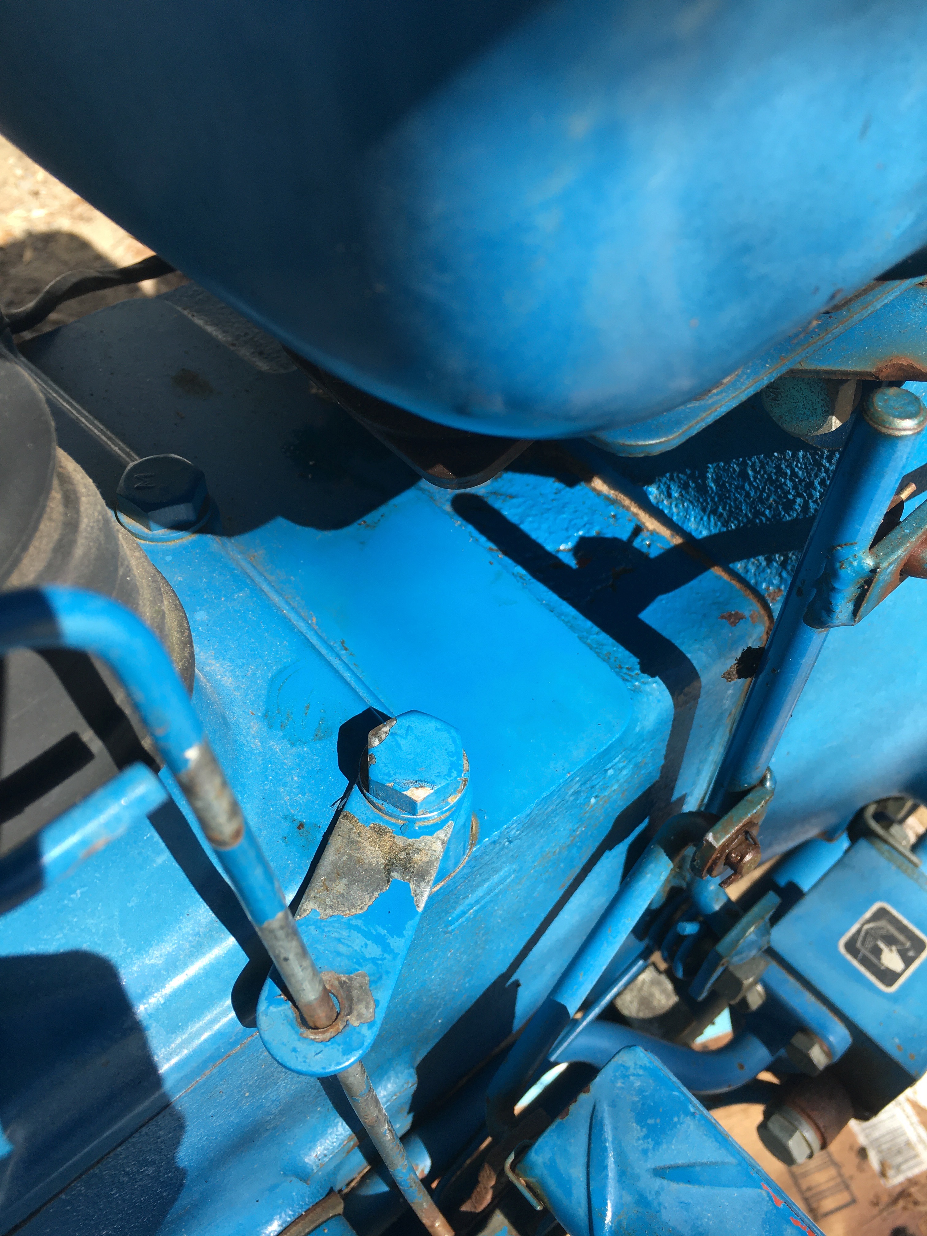

I have a great little 1910 that lacked a loader when I bought it. I found a loader from a machine (also a 1910) at Weaver's and am having trouble figuring out the plumbing.

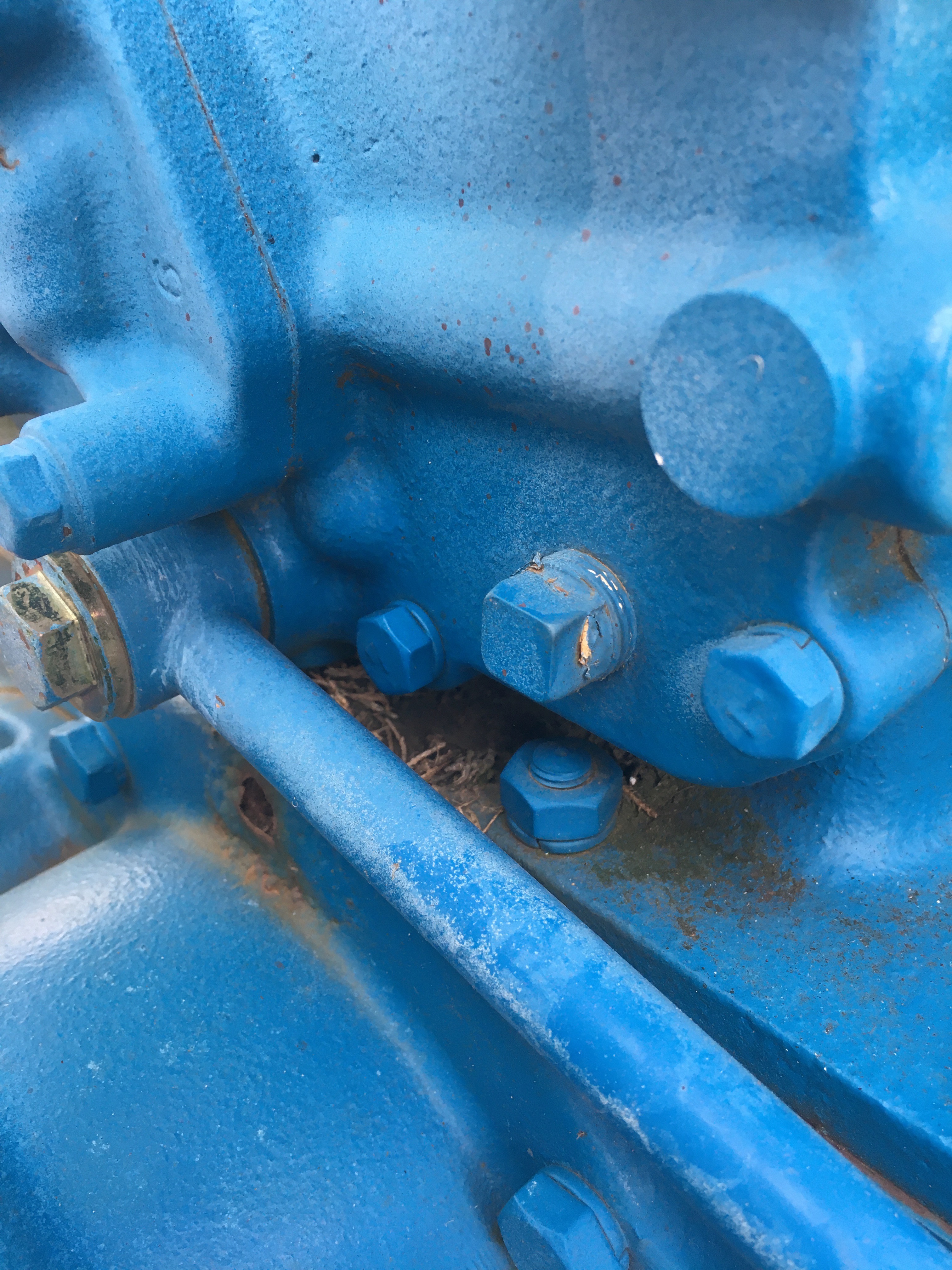

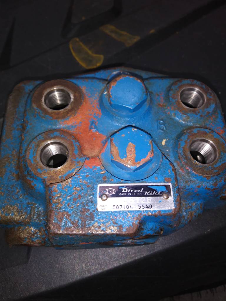

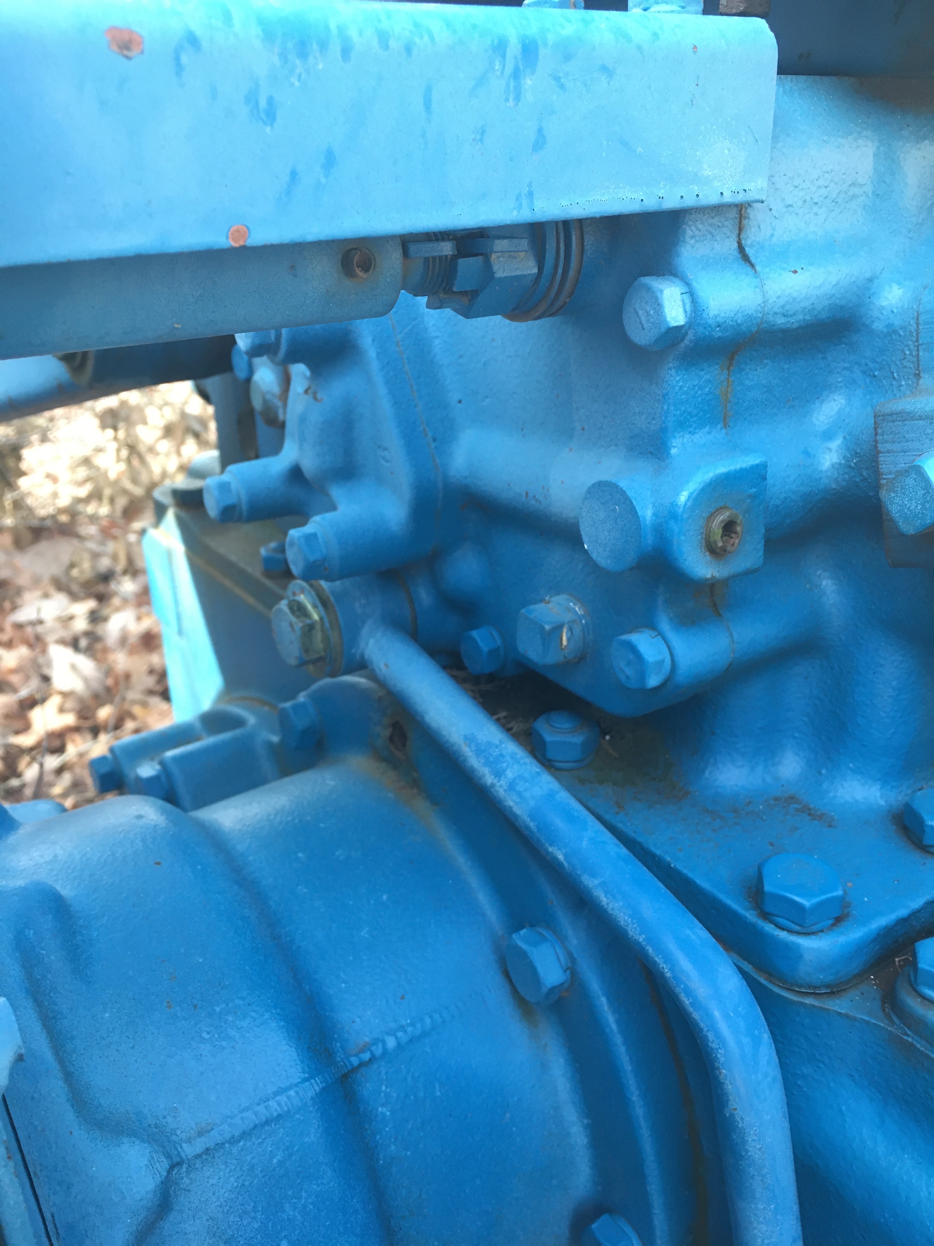

The 1-arm loader valve (also a Ford made by Diesel kiki) has the two hoses that go to the diverter block, plus a port that is marked "T", which I assume means back to the tank. There is only one place for the hard pipe that goes from this port to go, which is atop the transmission case. Most pictures of the 1910 with this loader show the pipe connecting on the starboard side, just aft of the split point.
I checked the machined surface of the transmission for signs that there was a knock-out plug, but found none. It can't be that every 1910 that wanted a loader required a dealer to drill and tap a special hole for the hard pipe from the T port of the loader valve, right? The hard pipe has a drilled bolt and two o-rings (top and bottom) in it. My 1910 is a 1984 model (2266).
What am I missing? Really want to install this loader, but need help to do it right.
Thanks in advance,
jim

I must be doing something wrong or have a rare tractor. No replies.
Did manage to learn (from several hateful hours on the computer) that my 1910's serial number was too low to have that plug in the top of the transmission. There was, apparently, a hose kit that runs from this open center loader valve, along the tractor side, to a pipe plug on the side of the lift cover under the driver's seat. So, progress of a sort.
I did notice that there is a return line from the power steering box under the instrument panel that runs to the tank near the front of the trans below the panel, but the fitting for that return is not close enough for the hard line to attach there.
My new question is whether I can tee off that power steering box rubber line and save running a hose all the way to the back of the tractor. Would I risk running back pressure into the power steering system by doing that? Would it harm anything if I did?

I thought those old (Shibaru) Fords were wonderderful at the time and still do. I was going to ask if you were lucky enough to have power steering.... good for you. All the better Japanese tractors from that era were competing to make the best machines they could so that they could compete in a new market (which was the US, of course) where quality was known to be very important.
I have never seen one of those one-armed loaders other than in photos. Fantastic. I believe it was just a way to "show off" innovation and engineering technology.... which it certainly did.
OK. You seem to know your hydrauics, and found that the return point to the transmission sump wasn't yet incorporated into your tractor. I don't know the answer on the PS return - partly because I don't even know what type of power steering design that Ford had.
If your 1910 had simple manual steering with factory power assist cylinder on the draglink that's low flow. But it might have had a special steering box for a hydrostatically-controlled remote cylinder, or even an modern automotive complete integral power steering box. The manual+power assist type was low flow, and the second and third types used a much higher continual flow regulated by a proportioning valve with a preferential flow to the PS over any other use. So my guess would be that you could use the return point with the first type - at least without damaging anything. For the second and third type of power steering I'm not so sure. It's possible in those systems that the return flow restriction is calculated into the proportional flow control spring.
I'd look around and see if there was any other transmission cover that I could take off easily and mount a return into. But you've probably already done that. Otherwise, why not run a hose back under the seat in the OEM manner? I'm guessing it tees into the 3pt return there. Just make the hose one size larger diameter than the loader pressure lines and you should be good. There is little pressure on the return line, so even simple plumbing fittings work fine.

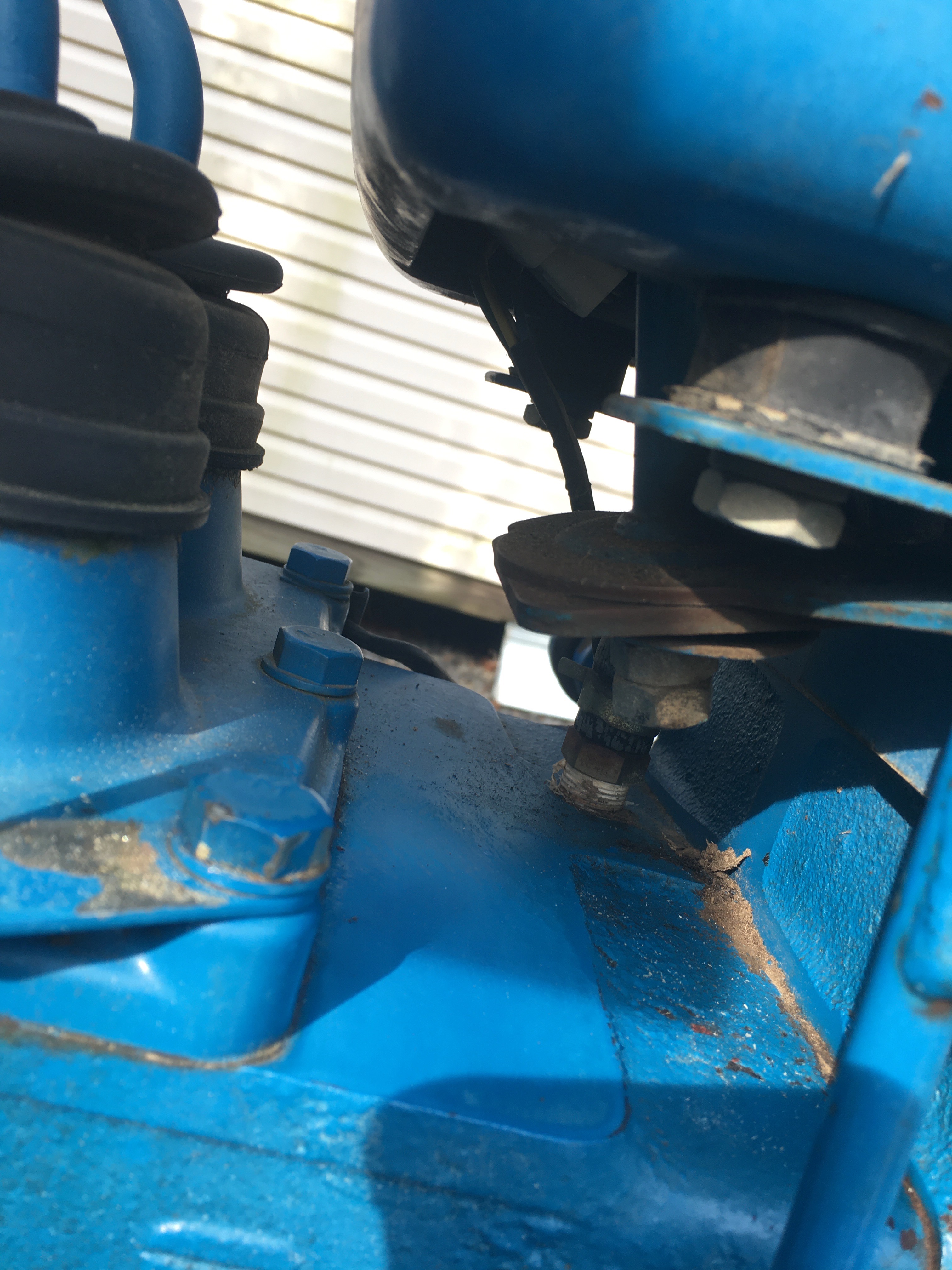

I did not find any mention in the manual of the pipe plug in the side of the lift cover. Am not sure if that area is under pressure or not. I suppose I could rig a pressure gauge and find a fitting to test it. Probably the safe thing to do. If under pressure, would that mean it's not a place to dump back into the sump?

   / Please Help - Ford 1910 new 770B Loader Plumbing Issues #5

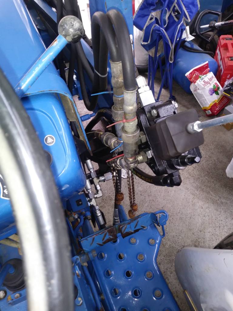

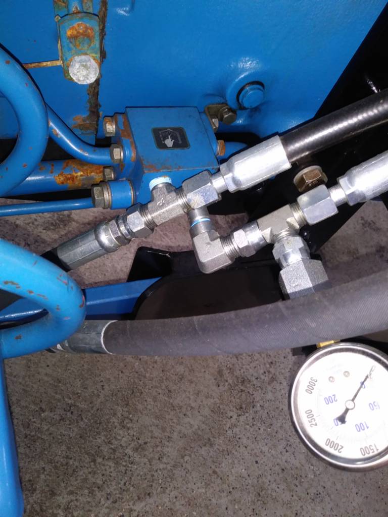

I have a 1910 that is piped a little different than what you explain. I have the plug on the top of the transmission case next to the power steering return. My loader return line connects to the upper port on the diverter block. I also have a backhoe, that is the other lines pictured.0311201540.jpg0311201525.jpg
I also have an aftermarket loader valve on my tractor.

Great post. Thank you. The loader valve that came with mine appears to be the original to the 770B. It's made by Diesel Kiki, is an absolute pig of a hunk of metal, and it definitely includes a port marked "T" as you can see from my photos. I assume that is because it is an open center valve and needs fluid run through it constantly to account for the 'float' mode. Now, I have never owned a tractor with a loader, so this is all new to me. Do you have a "T" port on your aftermarket valve? Wondering if I have a option to pipe the Tank return hose into the return port of the diverter block...

I have a Brand Hydraulics model number LV22RFSTKAB spool. It only has an inlet and outlet ports along with the working ports and power beyond. It only uses the manufactures diagram for piping no letters on valve body.
My tractor originally had the Diesel Kiki loader valve. It was piped the way it is now with only two pipes. I don't have the old valve so I can't tell you which ports it was connected to.0311201655.jpg

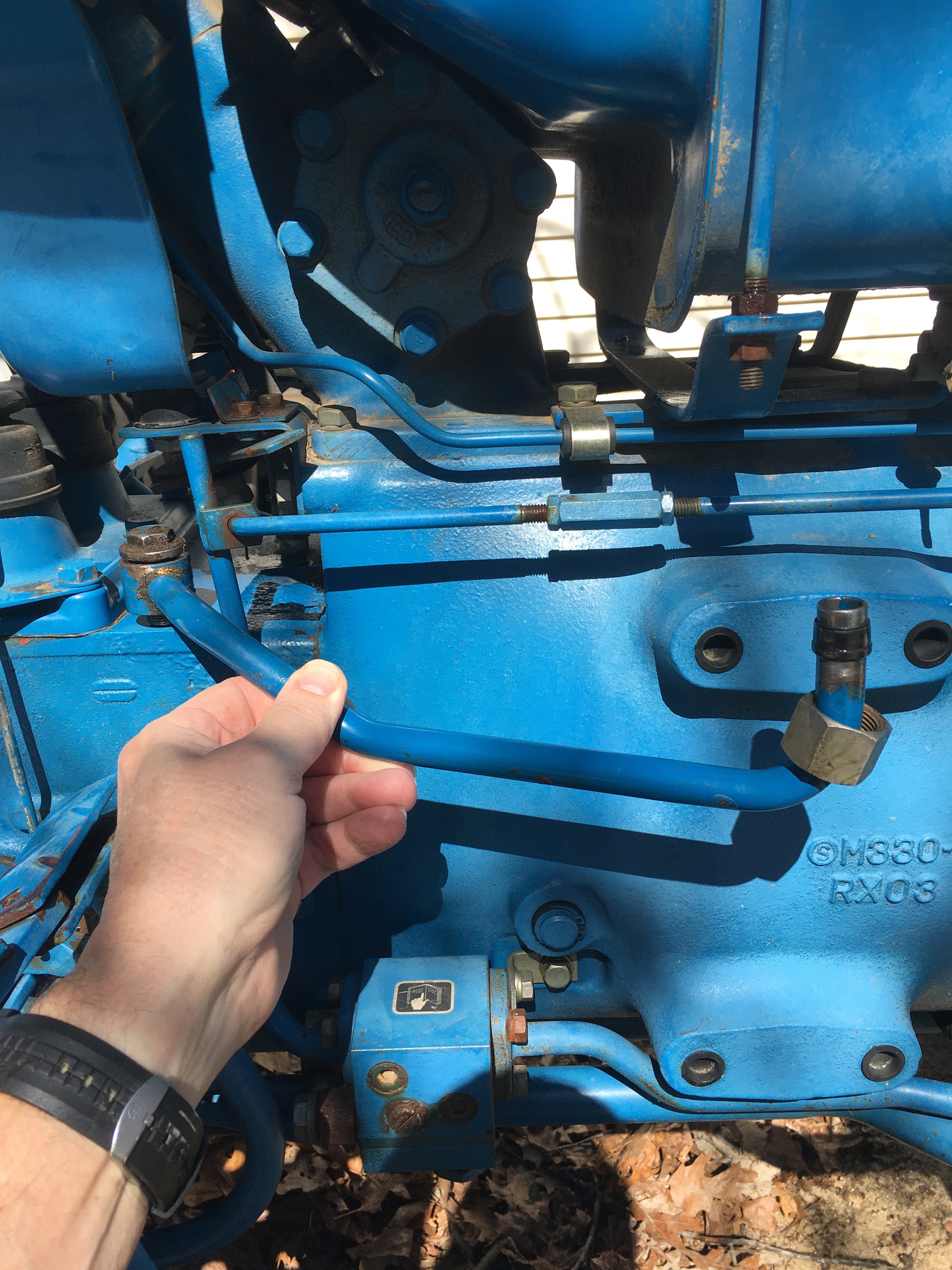

You're giving me hope, but not sure it works with my setup. Hoping so, though.

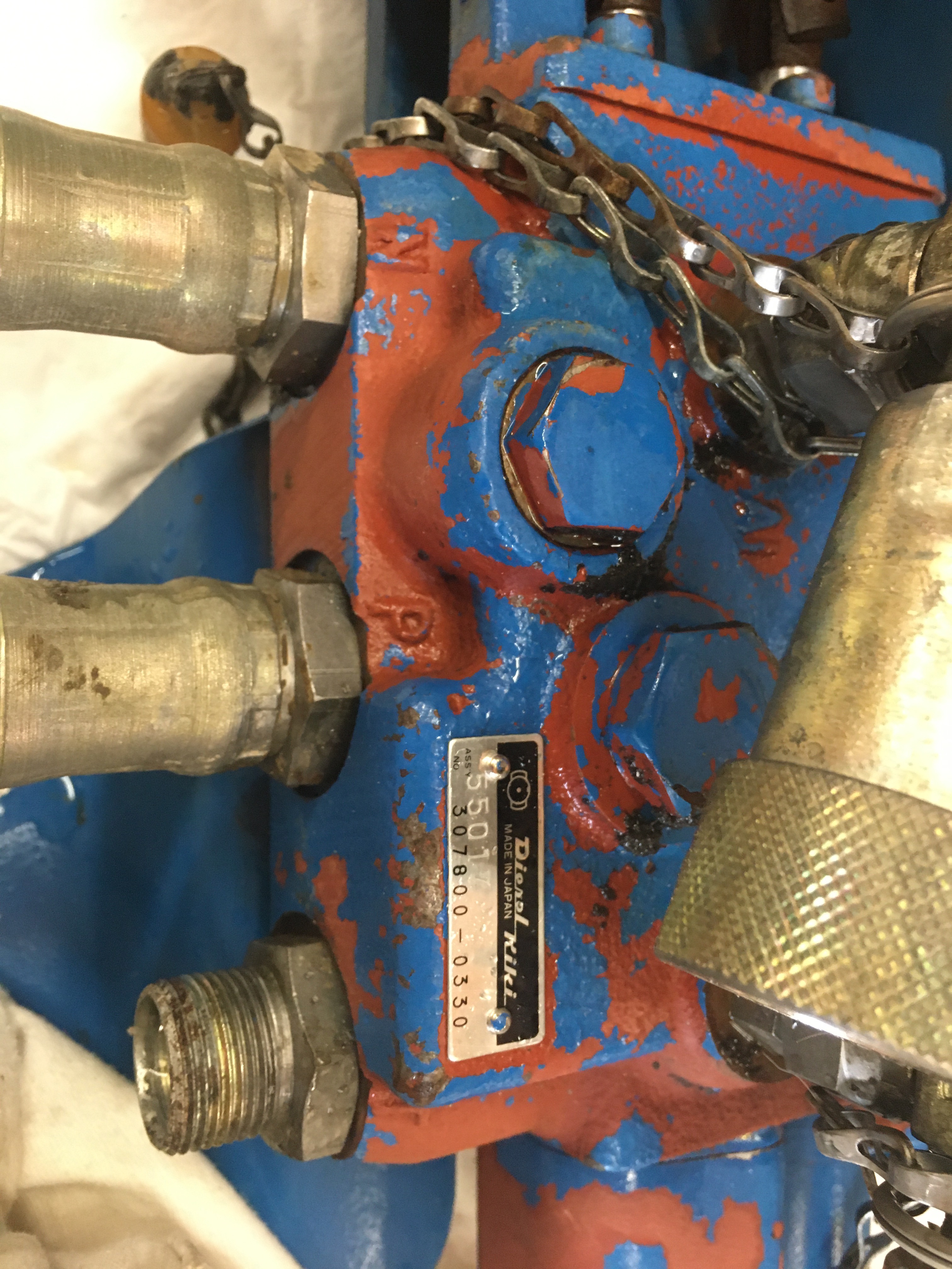

My valve is pictured. I have three ports; "N" "P" and "T" - My assumption was that the N and P go to the diverter block, with the T going back to the tank somehow to account for the open center valve.
If I don't need the T port, my life becomes infinitely simpler.
The Tee I mentioned earlier would go to the soft line that runs from the side of the power steering box behind the instrument panel to the top of the trans (tank?).
I've also pictured the plug on the side of the lift cover that I had plans to connect the hose to (T port) if the power steering hose was not an option.
Thoughts? rScotty?

   / Please Help - Ford 1910 new 770B Loader Plumbing Issues #9
I found my original loader valve. It only has a "N" and "P" ports. Do you know if "P" is the pressure port and the "N" is the return? Could you put the "T" to the return port?
Could this valve have the power beyond option ?
