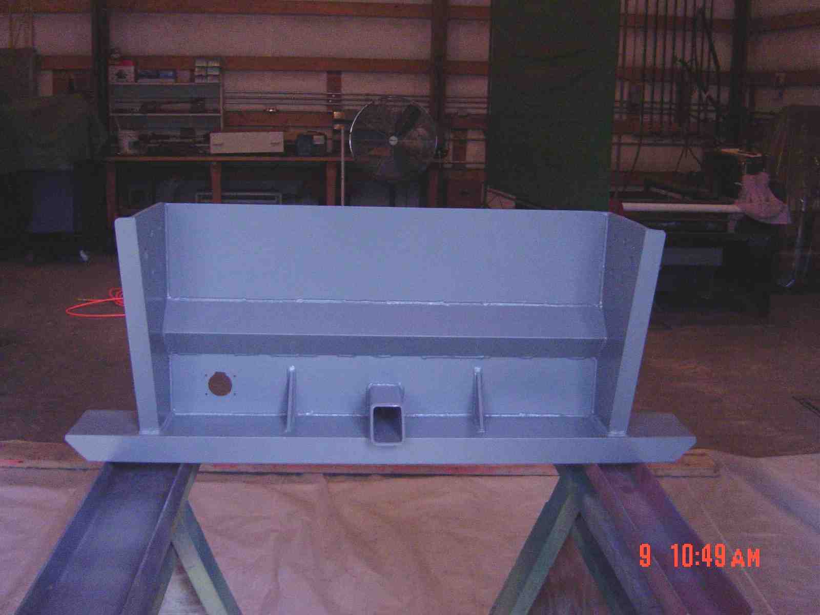

I am wanting to add a pintle hitch to my dump truck. I was thinking of putting a 30 ton hook but really don't plan on pulling much more than 10-15 tons though I may in the future go up to 20 tons.
I was thinking of recessing it similar to the attached photo. Is 3/4" plate (with gussets of course) sufficient or do I need to go thicker? Figure this would be a perfect job to try out my new harbor freight 120volt wire feed machine and learn how to use it.

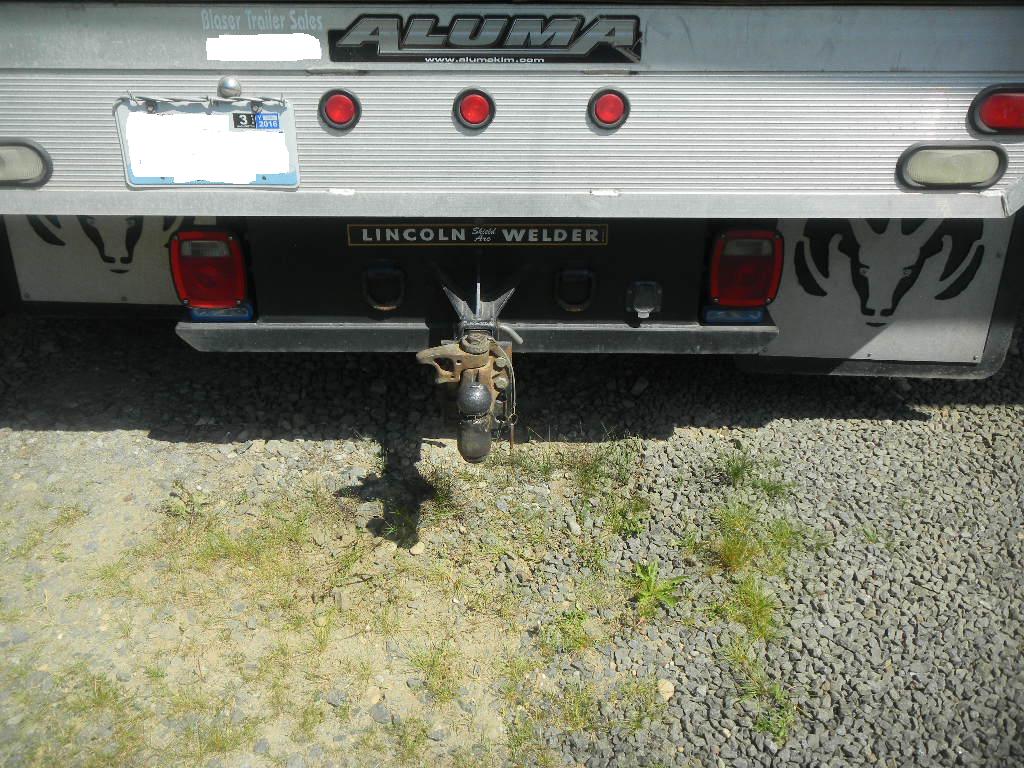

I would look into putting strong backs on the back side. Last hitch I built for my 1-ton Dodge I used angle iron on the backside of the safety chain D-rings.

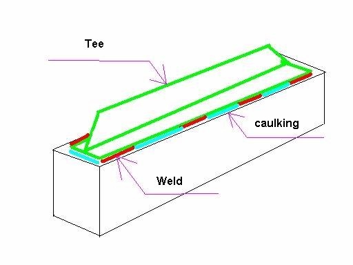

If you go that route, no need in welding all the way around. Just skip weld the strong backs. I like to use caulking between the welds before painting.

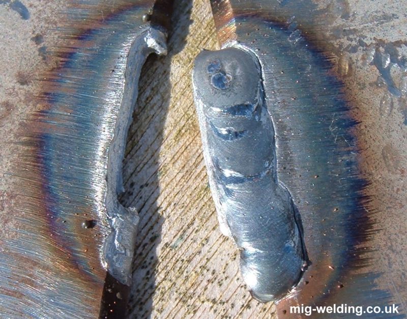

I know I can't weld for beans. I have an old stick welder and I couldn't get the penetration I needed for a decent weld.
I'd tack it together, try grinding through a few welds to see what I had before going on. You don't want a trailer busting free on the road.

If you have to grind into your welds to determine if they are good enough, you probably shouldn't be welding a hitch, especially one for 10 tons. 3/4" plate with even 3/8" x 2 1/2" or 3" flat bar(at 90 deg's.) would be sufficient. If you had 1/2" flat bar would add a little piece of mind.
