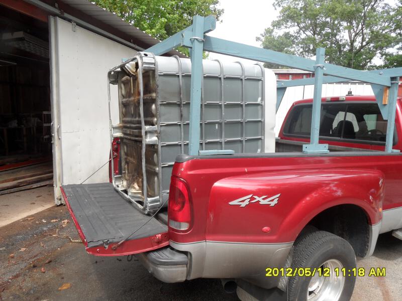

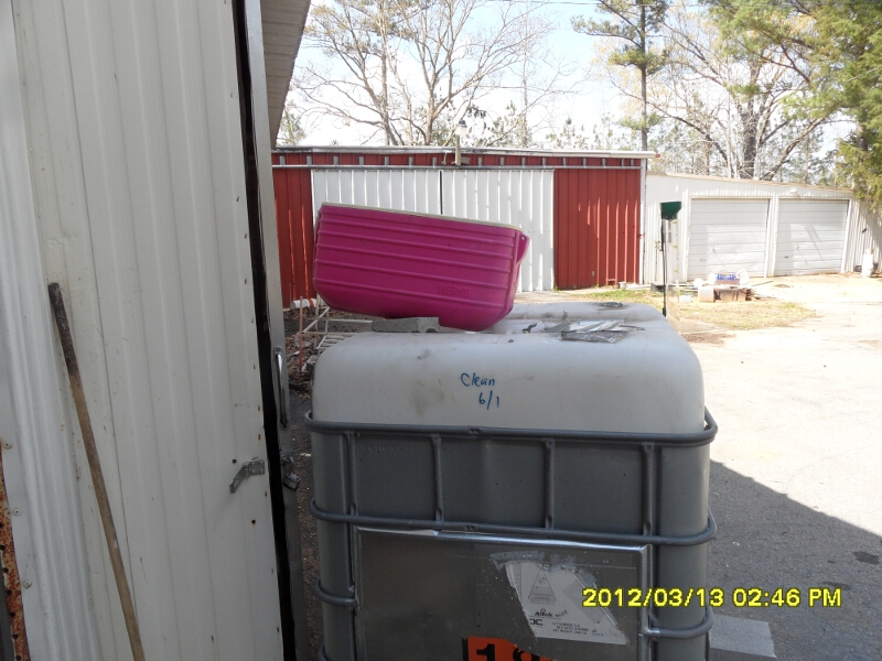

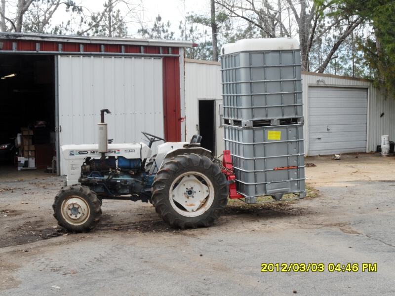

Look into IBC totes.
Many people use them for fuel storage, they can often be gotten for free or < $100.
