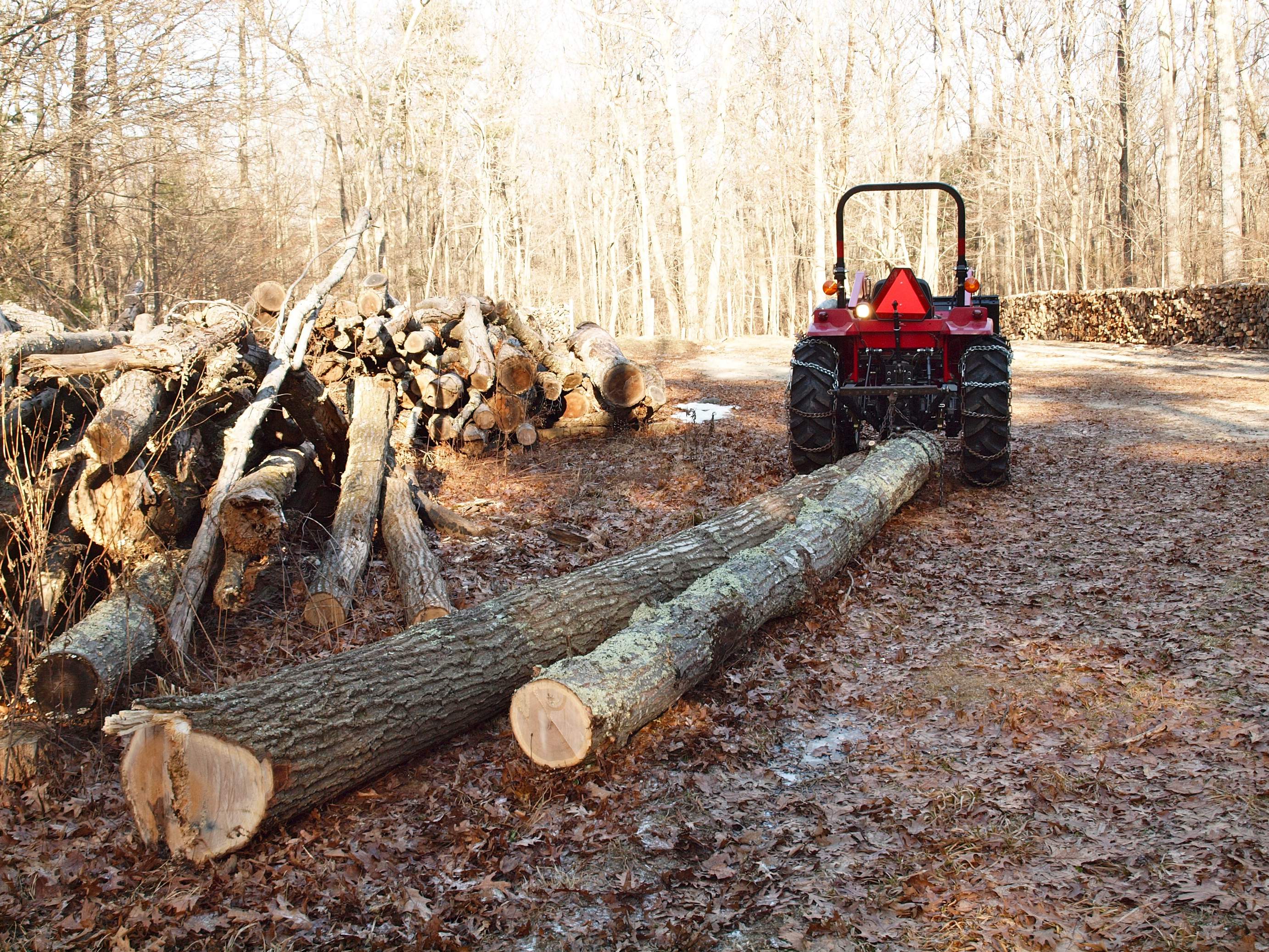

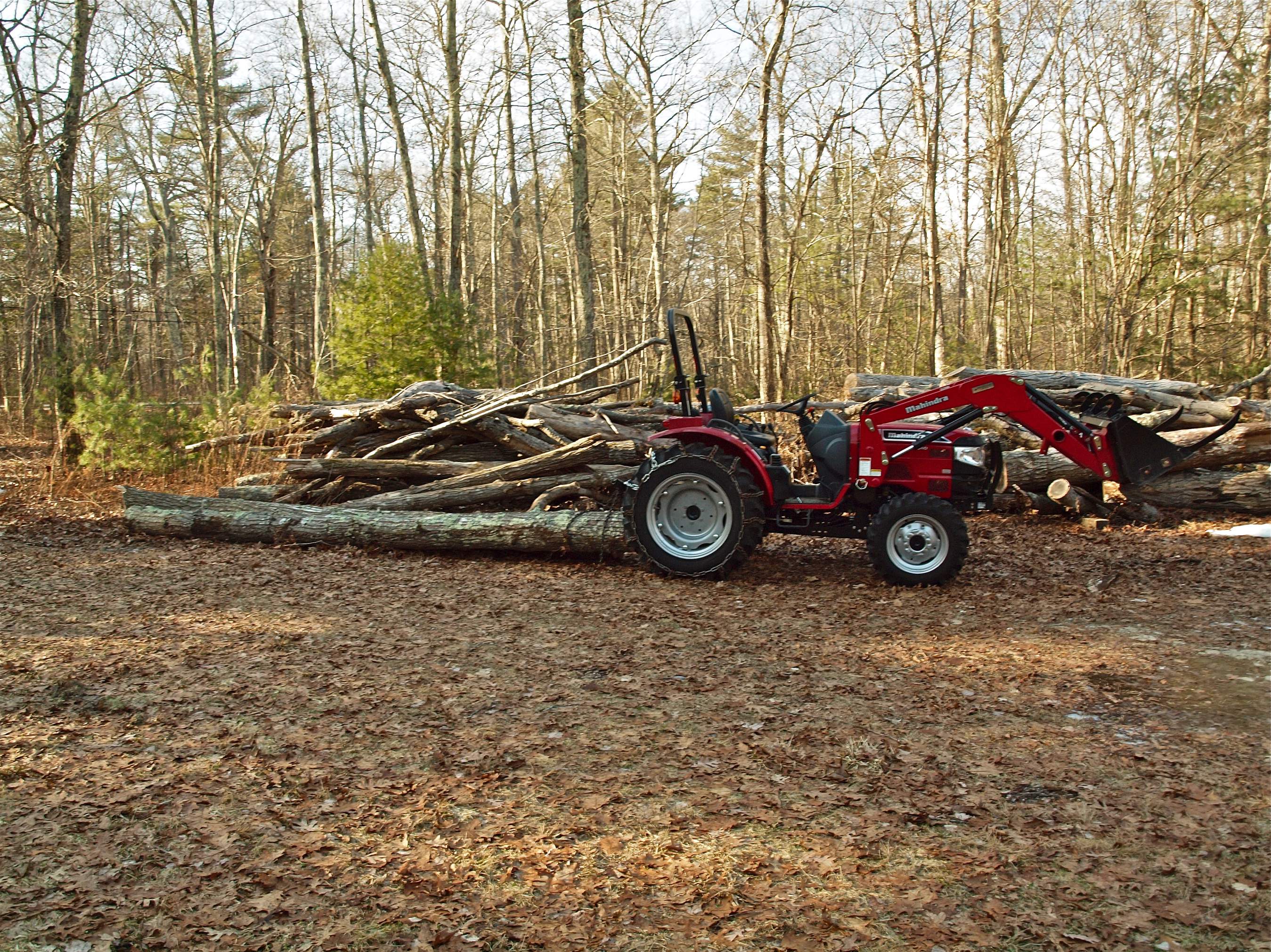

What will be the intended use of your tractor mostly? I have used my 3016 for logging in dense woods without incident. If you do get the 16 and you were getting R4's instead of ags, ask to have the R4's from the 3616. They're larger, hold more fluid and stick out farther to help protect fenders a bit better from side abrasions. If not, have your R1's set out wider from the dealer such as mine are.

I do a lot of what you're doing, dragging logs in and out of the woods, moving the logs on/off piles with the backhoe, dig rocks, stumps, plow snow, driveway grading, but mostly working with logs.
I've got ag tires on my current trac and want the wider 'Industrial' tires on my new one.
Don't know what you mean by R1/R4 tires.
