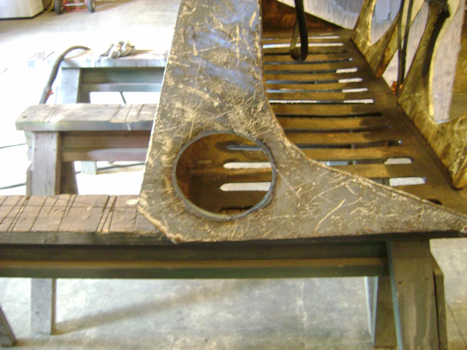

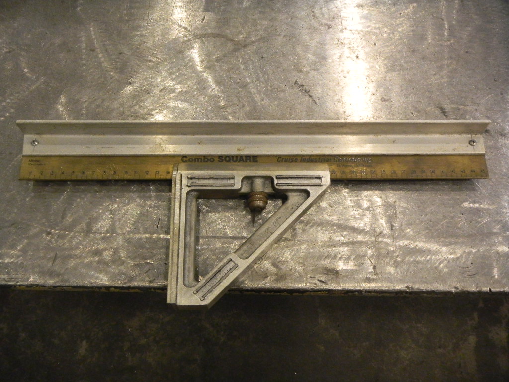

So after a weekend of cutting metal I see the need for a circle cutting jig. But I wanted to broaden it to any sort of cutting rig you have either bought or made and your thoughts on the jig.
   / Plasma cutter jigs #2

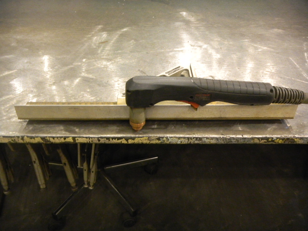

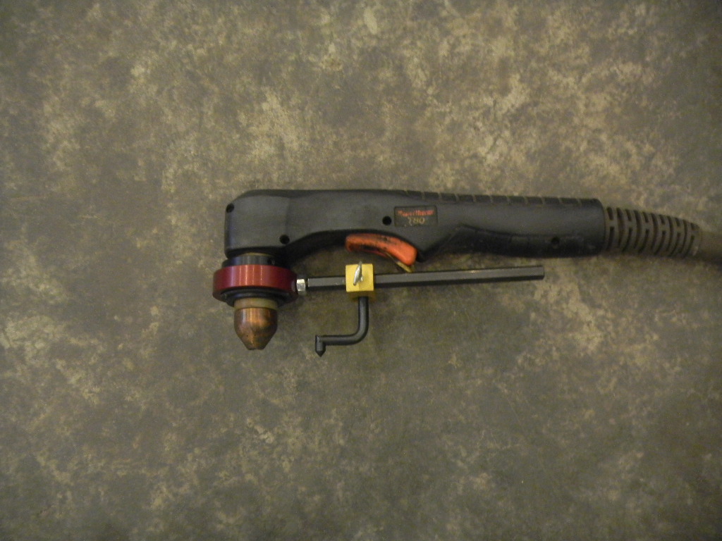

I have a Flange wizard circle burner for my plasma torch. I also added a piece of aluminum angle iron to my magnetic burning square to use with the plasma.

It's wierd, I ordered this
Plasma Cutting Guides - plasma cutting guide w/1.007 bushing - Power Plasma Cutters - Amazon.com
from amazon, and it came with a longer rod version of the one Shield posted thrown in. I'd planned on using the "chariot" and making my own circle burner, no biggie, but "free is a very good price", as they say.
The combo is pretty versatile, all the hardware is 1/4-20 so you can use one or two wheels, use a wheel on the opposite side of the rod/center pin, make your own shorter rod for tighter circles - The rod that came with mine is just over 18" long, so you can do up to 36" circles if needed.

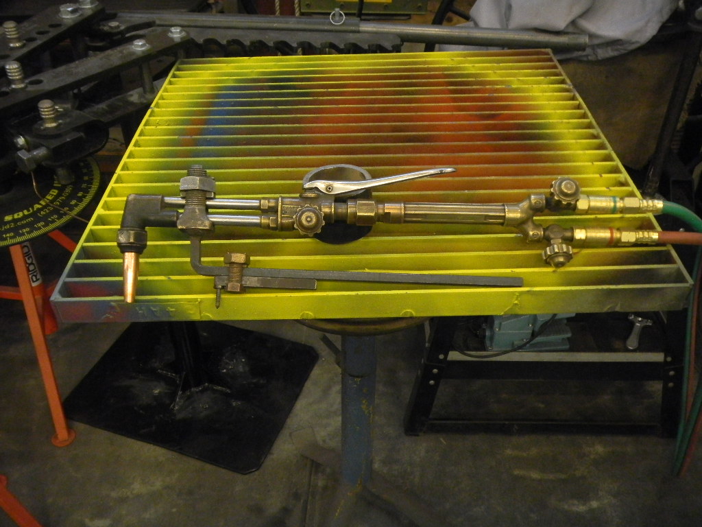

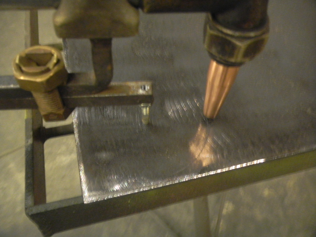

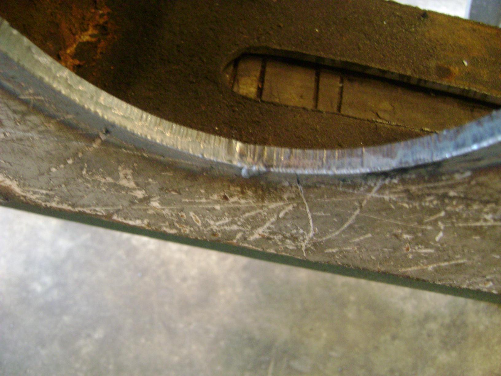

If you want to cut some really accurate holes build your self a rotating table. I took the hub off an old truck and built one. The circle burning attachments work good on just about anything.
