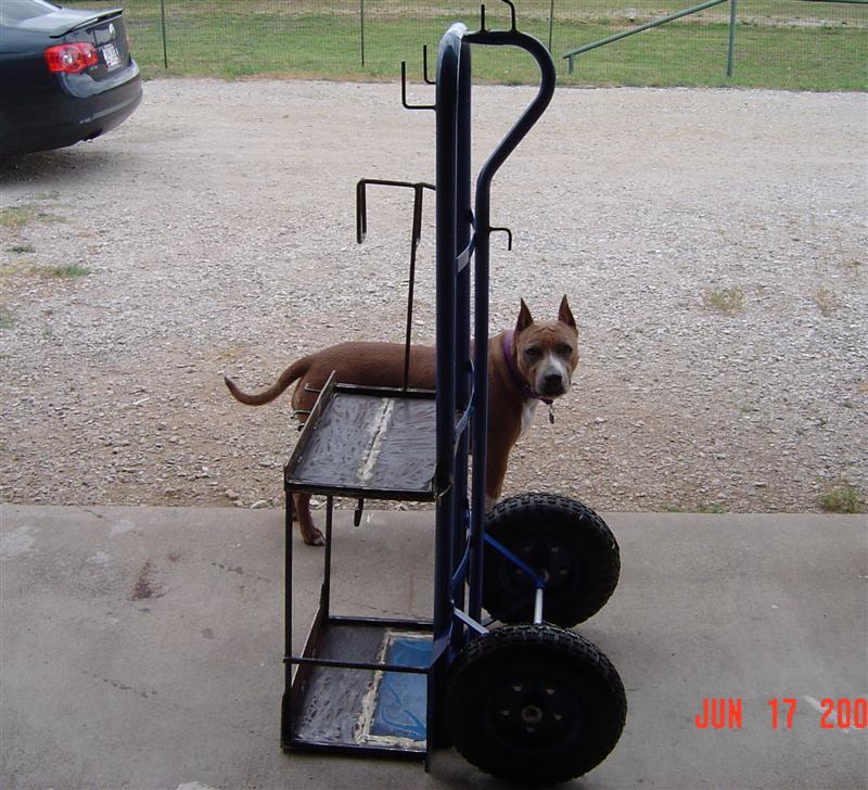

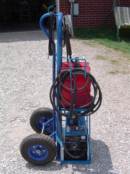

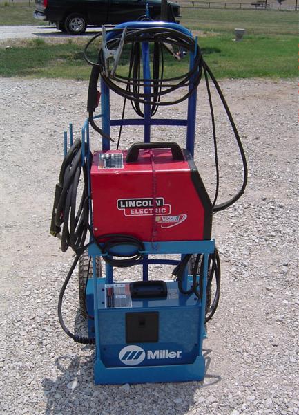

There has been a lot of plasma cutter information on here lately and I have enjoyed reading all the good informtion. Bought my Miller Spectrum 375 cutter back in Feb. and have enjoyed it. I have not enjoyed putting it away after using it with all the cords. I had been thinking of a cart but didn't like a carts size and performance off the concrete.
I was at the Harbor Freight store and got this dolly for $30. Nice large pnumatic tires and it rolls nice on uneven ground. The rest is scap metal I had from previous projects. After getting my plasma cutter where I wanted it, I still had plenty of room and also installed my little Lincoln wire feed welder. So far the dolly works great. It's compact and rolls well almost anywhere.

Nice one, I am looking to do something very similar but was looking at it very differently, I need to go rethink what I have, and what I want to fit on there.
I do want the regulator and dryer for the Plasma and the C25 bottle on there as well.
Looks real nice.
   / Plasma cutter dolly #5
now just find a place to mount your gas bottle and your golden.
Id take the custimization a fuze more, move the axle back a fuz more (which would be trivial to buz off the little straps with the plasma and extend them 2") and put the bottle stand on the back. You could acomidate nearly a full size bottle that way.
