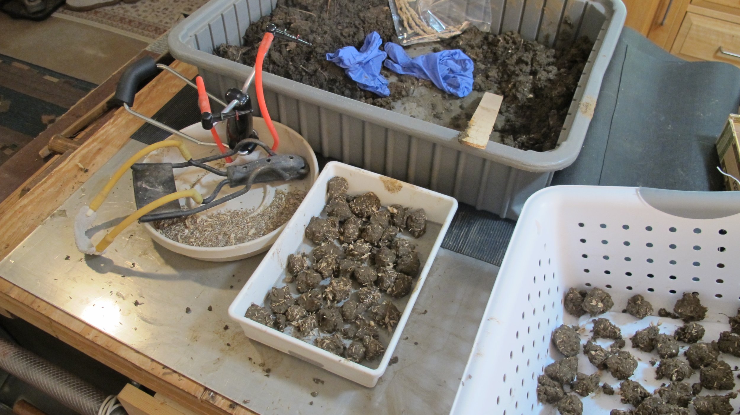

We have half a mile of eroded hillside right across the swift mountain creek. The slope looks like good dirt but is too steep to climb. It's only 20 yards away, but you can't get there safely. For a cover crop I scientifically chose whatever we harvested last year from our hay meadow, plus some older commercial seed from the bottom of the barrel.
Did a germination test on the mix this spring & got roughy 50% germ.
Seed projectiles are a mixture of sticky clay mud from a local construction site, Rocky Mountain Fescue, Big and little Blue Stem, Canary grass, and good old Pasture mix - along with clover & some alfalfa. Shape to size and sun-dried.
The planting implements (pictured) are rubber band powered and will broadcast about 30 yards with pretty good application accuracy... Got some volunteers coming up this weekend.
Will let you know....

Have you considered a water balloon launcher, but fill the balloon with seed and some water?
Puzzled here, guess the seed would sprout in a balloon with water but will they grow through a balloon? Or would the balloons burst on impact?
   / Planting cover crop on a hillside #6
Should burst. The negative would be having to look at burst balloons on an inaccessible slope.
