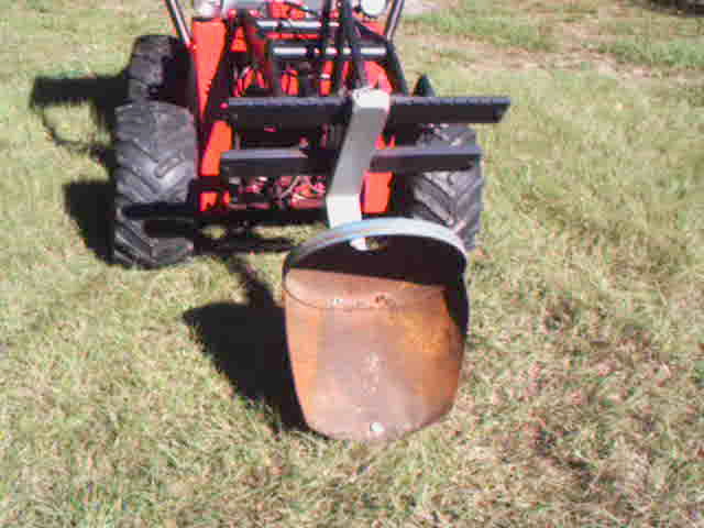

HI,
HERE IS A RELATIVE INEXPENSIVE WAY TO DIG UP OR TRANSFER PLANTS. WILL DIG UP AND TRANSFER UP TO A 15 GAL PLANT. MAY HAVE TO COME IN FROM TWO SIDES ON LARGER PLANTS.
IT IS MADE FROM A BLADDER TYPE WATER TANK, CUT TO SHAPE AND BOLTED TO A REMOVABLE FORK. WORKS FOR ME.
J.J.
